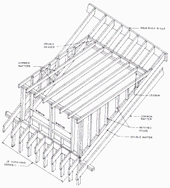

Have you thought of placing a shed dormer where you want to place the lift?
   / plans for a barn/garage are coming together! #6
Another illustration

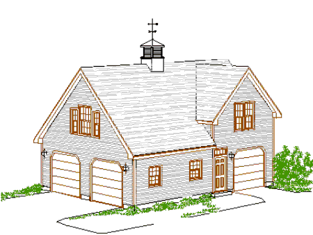

mr350 - No, I've never seen that. I'll think about it some. I have a feeling it would have to be so large that it would be easier to just go ahead with the higher walls. For example, my suburban is 18' long and over 6' wide at the top, so the shed dormer would have to be that big. Plus, it looks a little complex for a first timer!

Another option is a gabel dormer
