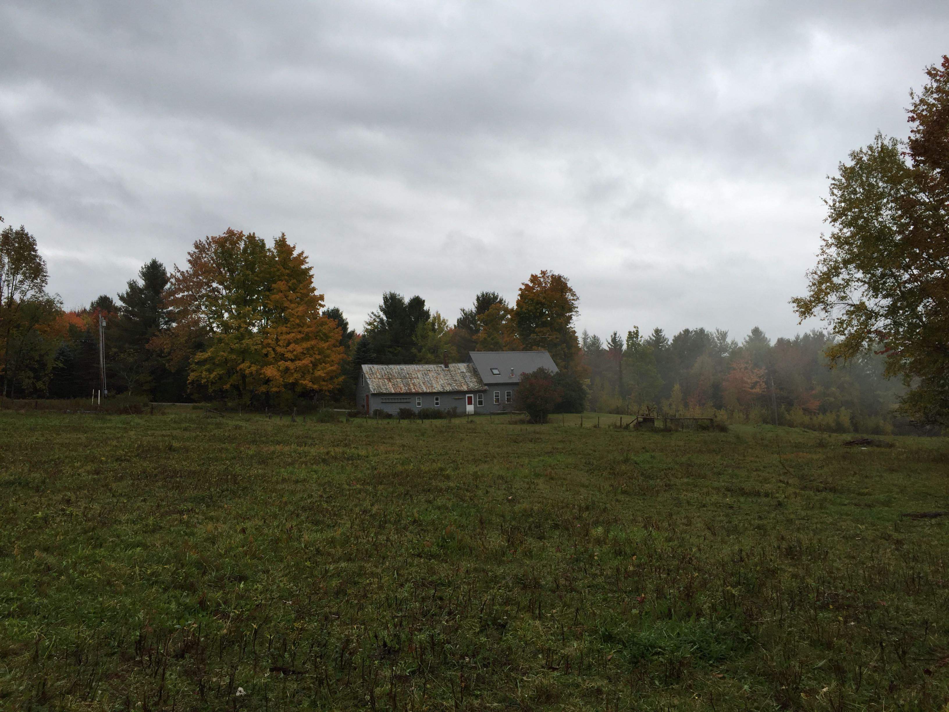

As we have just acquired 57 acres in Northern Vermont with plans on starting a small and, hopefully, low maintenance farm, we are seeking advise from all you experts on building a relatively inexpensive and low maintenance barn.
Our idea for the barn to have misc storage, vegetable prep and cold storage, hay and feed storage, and some animal stalls. We are not planning on having horses, maybe some goats or sheep, pigs and beef cattle (no dairy). We are thinking 36' x 48' with a center drive through. The vege prep and cold storage will be insulated and may even be heated.

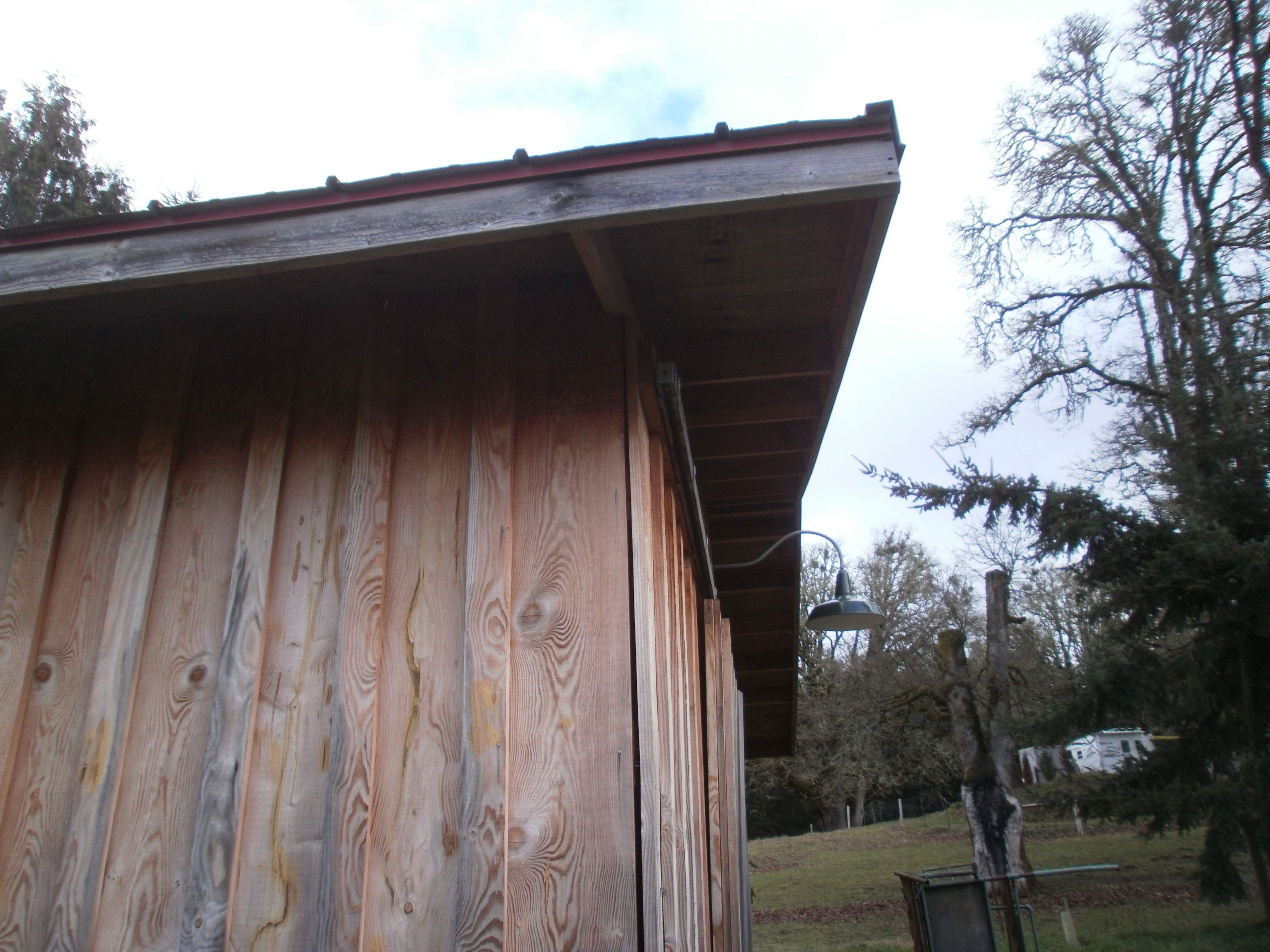

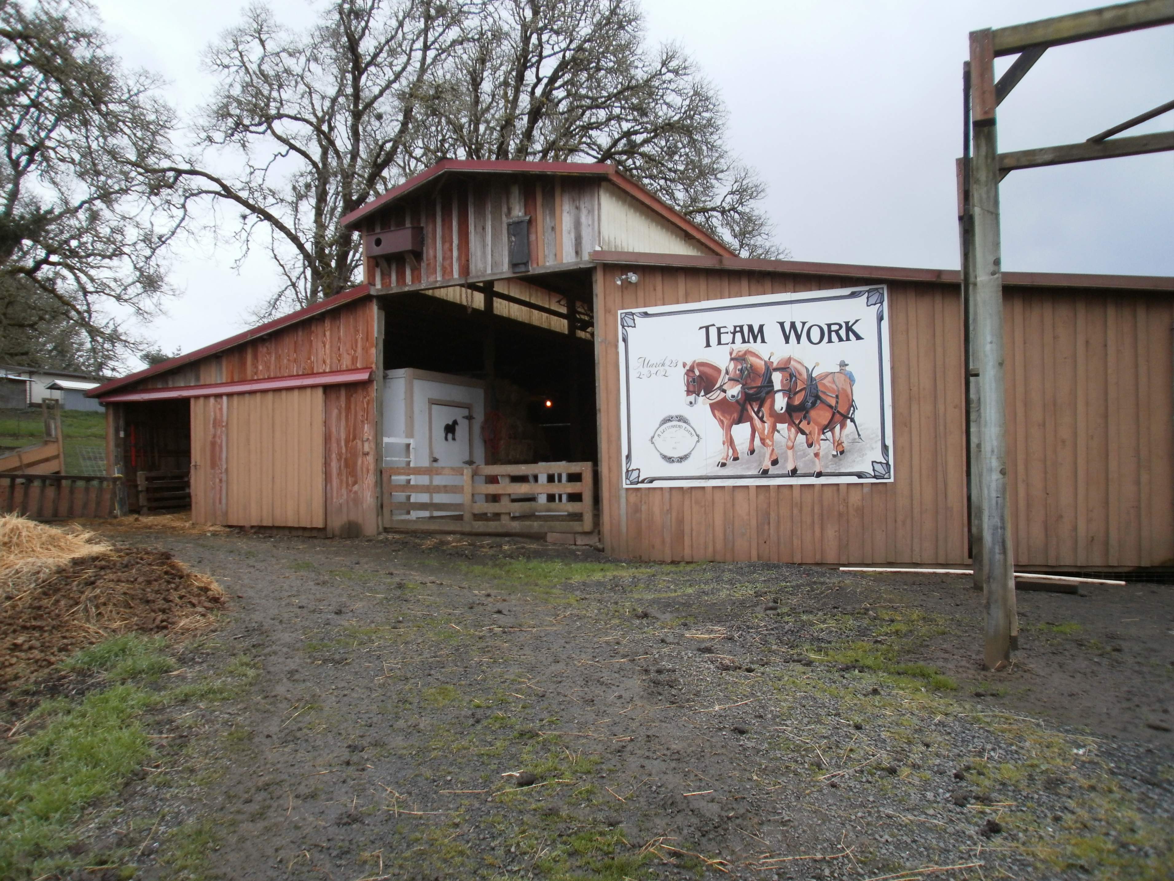

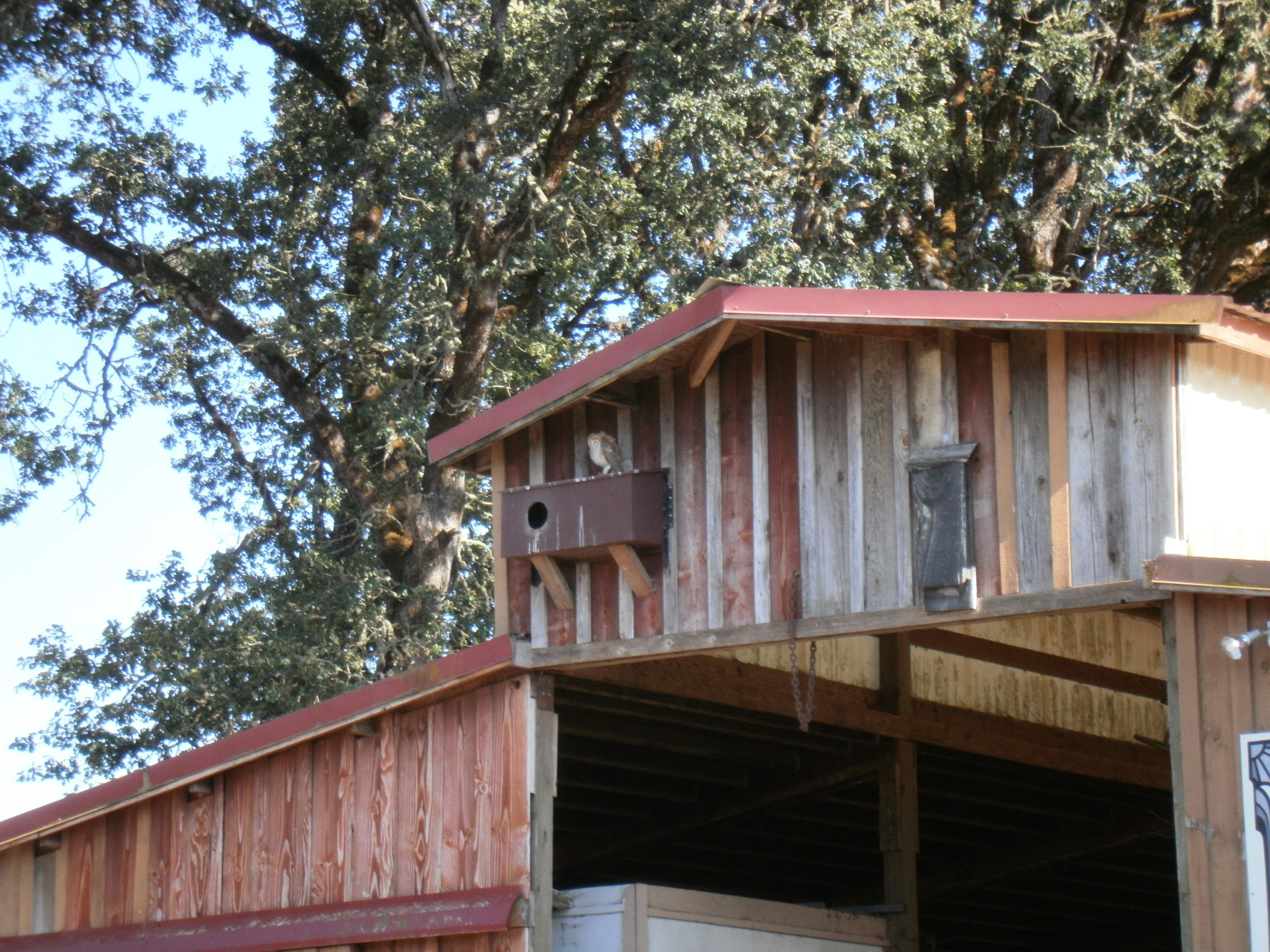

This building housed horses and sheep and is a pole barn. It is 48 by 68. The center bay is fourteen feet wide and real glad it made it wide. I wish I would have put real eaves on it inside of little ones.
I do have gutters leading away from the building into French drains. One area is 24 by 36 and is a wooden floor made up of rough sawn full dimension lumber and it is elevated from the ground for air and drainage.
There is a eight by twelve concrete pad for an enclosed room for supplies, and three by twelve concrete alley adjoining that with open shelves and storage. The fiberglass paneling allows some sunlight in there and maybe some day take it down and put up the more modern semi clear polycarbonate stuff.
The building began as a twelve by thirty six lean-to shed and was added on to three times. The building with the big eaves is a separate structure but I wish I had done full eaves for the barn.

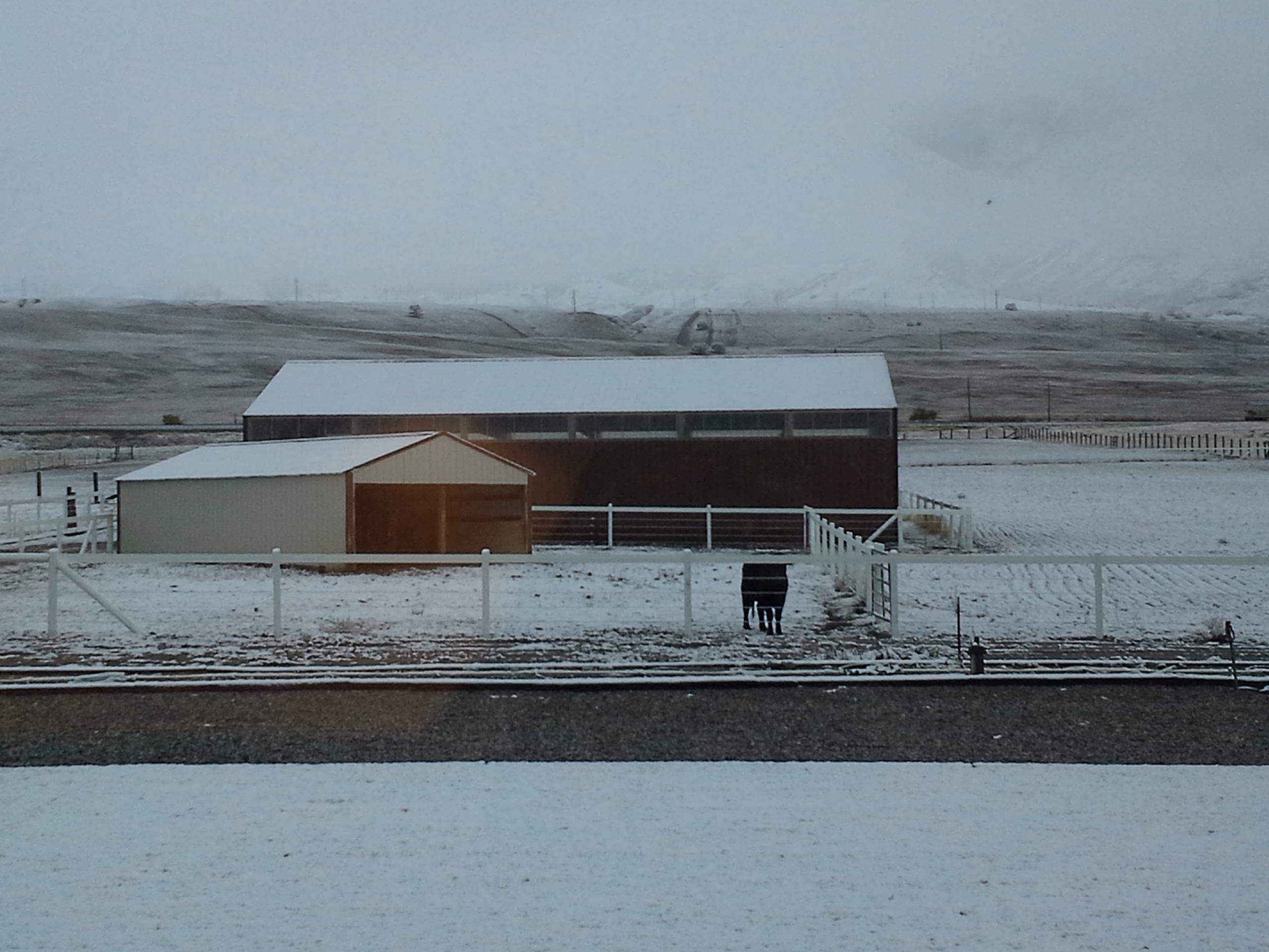

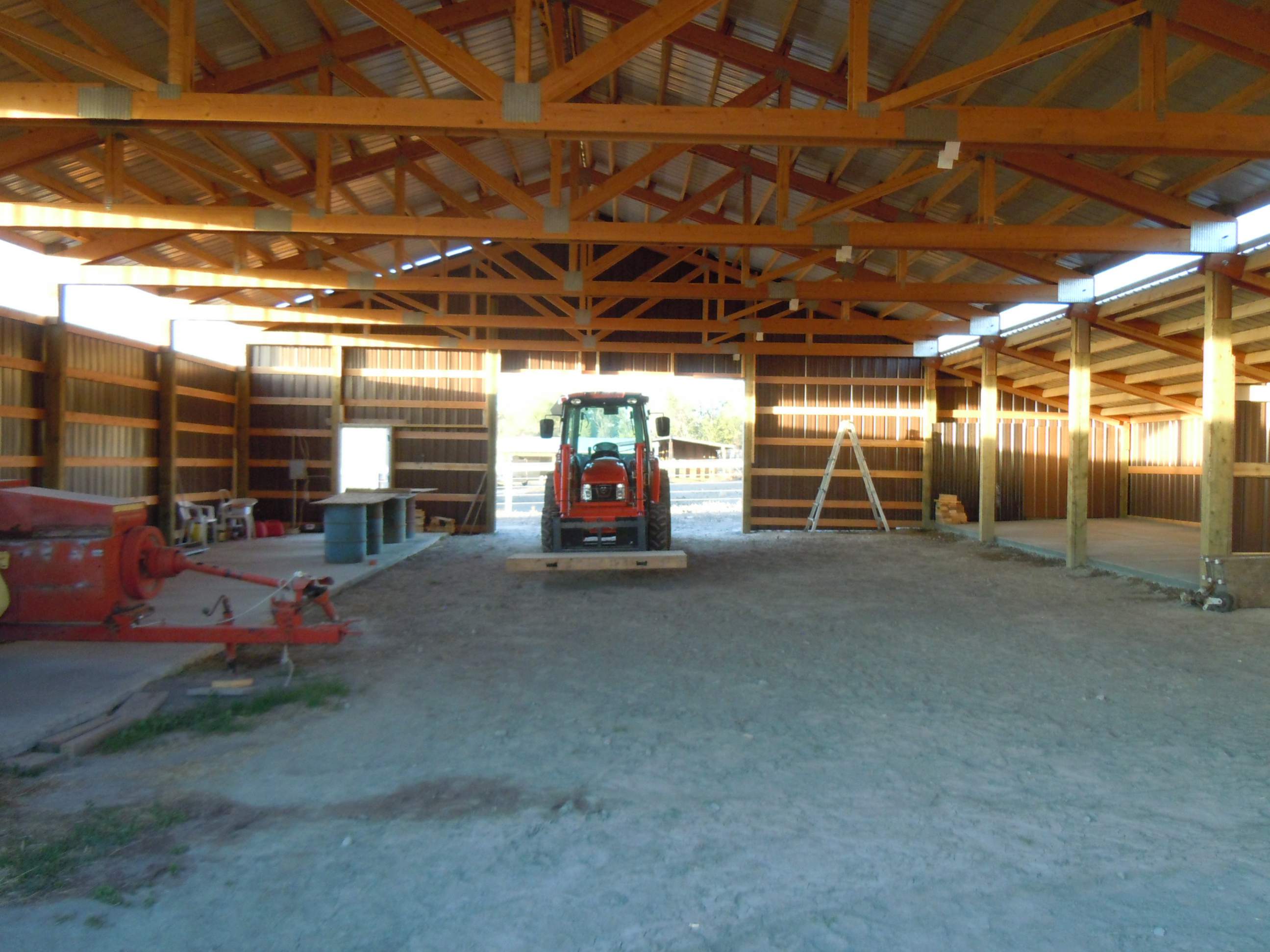

All good advice and as others have stated "make it bigger". I have built three now and think I finally got it big enough. 57X72 Here are pictures of where it stands now, waiting for doors.
