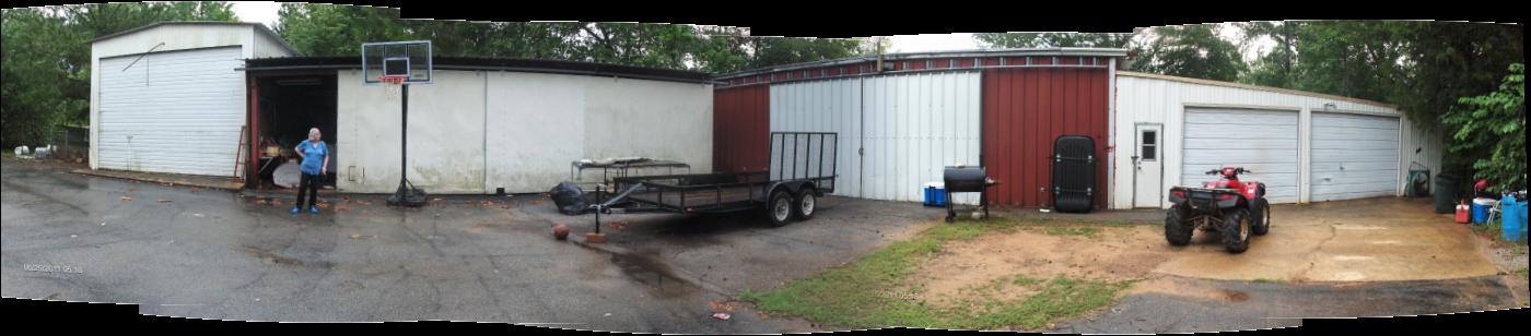

I just had a 40x60 metal roof replaced in Fulton, Mississippi, the one with the red front.
attachment.php
I got three quotes for the final product. 26 gauge metal, a decent pitch and insulation so it didn't rain inside all spring (which it just had). Plus tearing off the old roof. One was from Lowes, the other two from highly recommended local roofers.
If you look at the roof it had no pitch, so they HAD to raise the rafters or put in new rafters.
Lowes quoted me $6K for 29 gauge metal ALONE. When the installer came out he said he wouldn't use wood, but would replace it with metal trusses. then they figured in installation and it went up to something like $11K.
I had them redo the bid with 26 gauge, and insulation because that's what I had the others bid on and the final price with taxes and everything was like $17K or $18K.
One other bid said he would redo a lot of the wood $18K
The winner, Tim Steele, was $17.1K. He raised the center ridge about 4" (and of course all the other angles) and put in insulation bats between the metal and the purlins.
It looks like the metal trusses weren't that expensive.
I'd strongly recommend the insulation to prevent condensation.
The entire job took a pretty well trained group of 4 just a smidge over 3 days, in beautiful weather.
