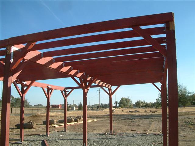

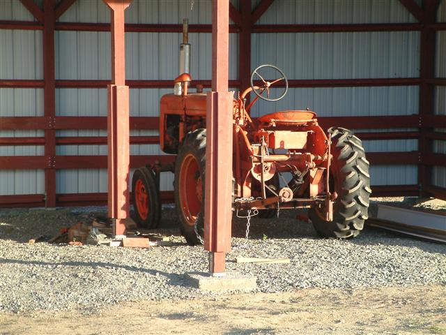

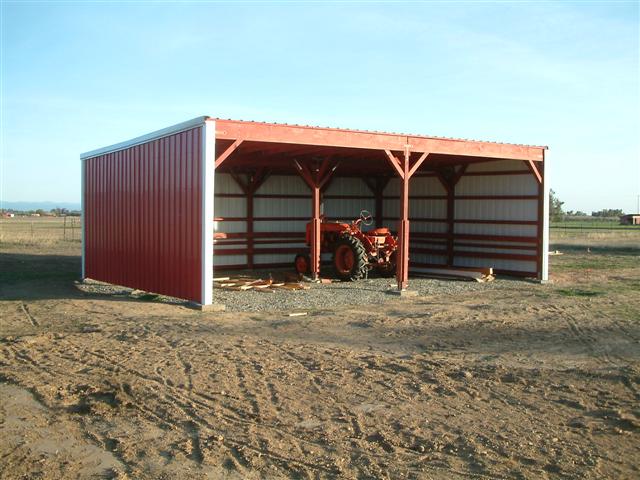

Here's my tractor shed--20x28 ft, 10 ft high sloping to 9 ft in the rear
4x6 PT posts on 18"x18"x18" concrete footings (no frost here)
Doubled 2x12 x 14 ft beams.
2x8 rafters
4x4 side beams
2x4 girts and purlins
28 ga R-panel siding and roofing
