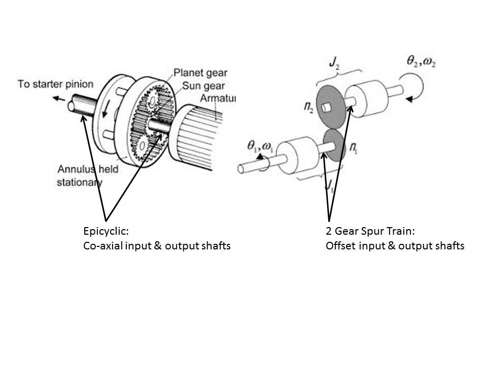

In general, planetary (epicyclic) gearboxes can carry higher power density (Hp/lb) than a two spur gear train of similar weight.
But the answer to your question - which is better - really depends on the application.
One major difference is that epicyclic input and output shafts are on the same axis (co-linear).
A two spur gear train has parallel, offset axes:

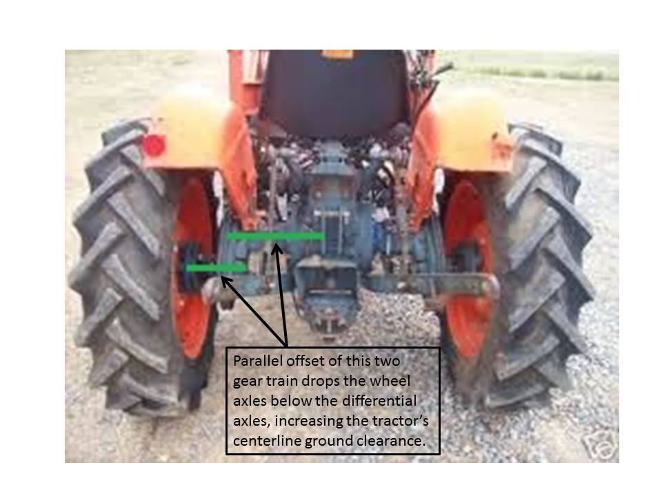

The offset can be advantageous to a tractor designer if ground clearance is desired as in the final drive for the rear wheels:
