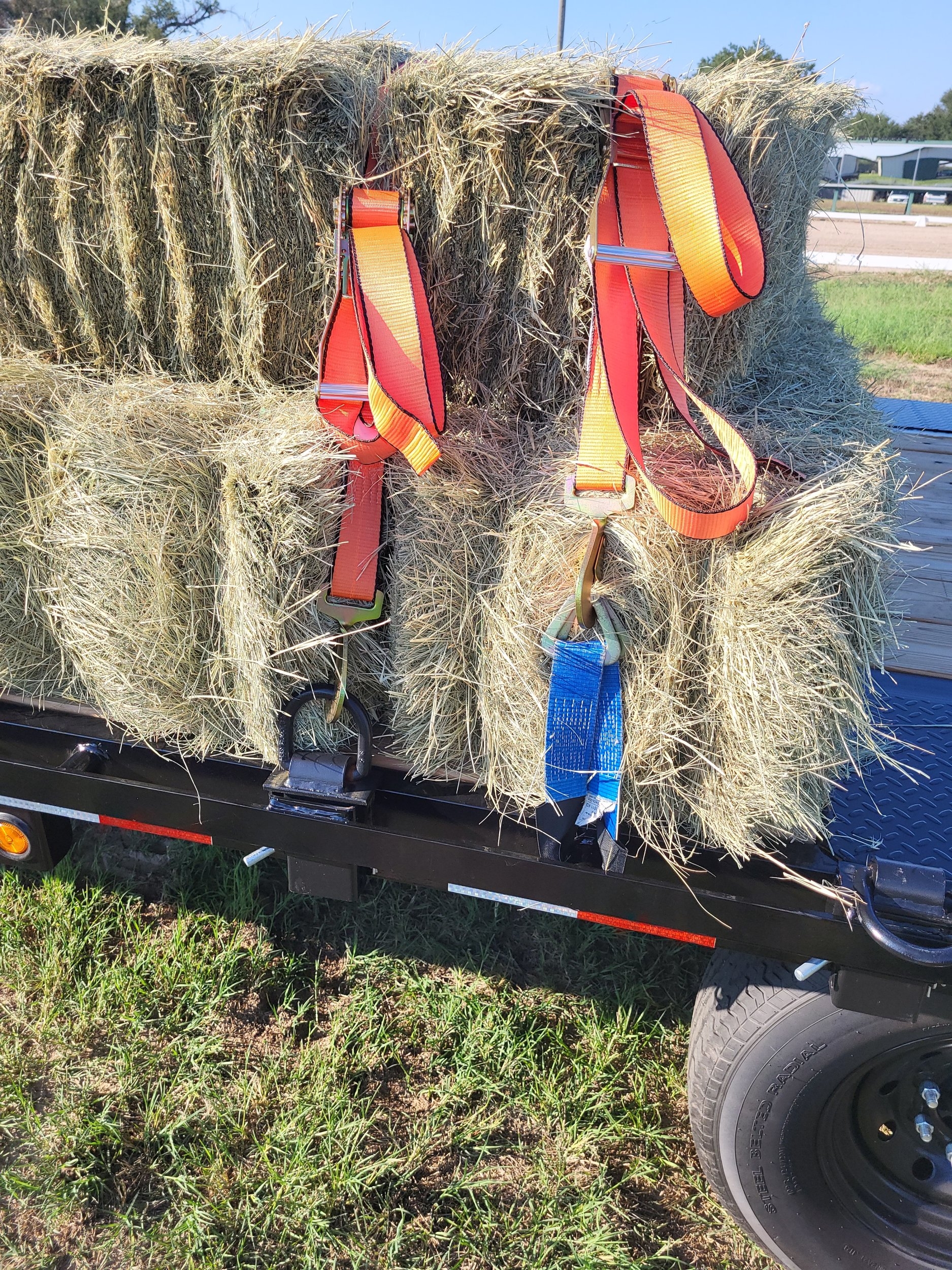

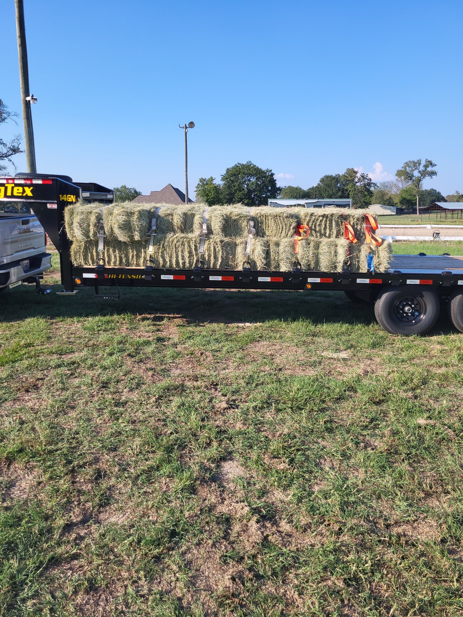

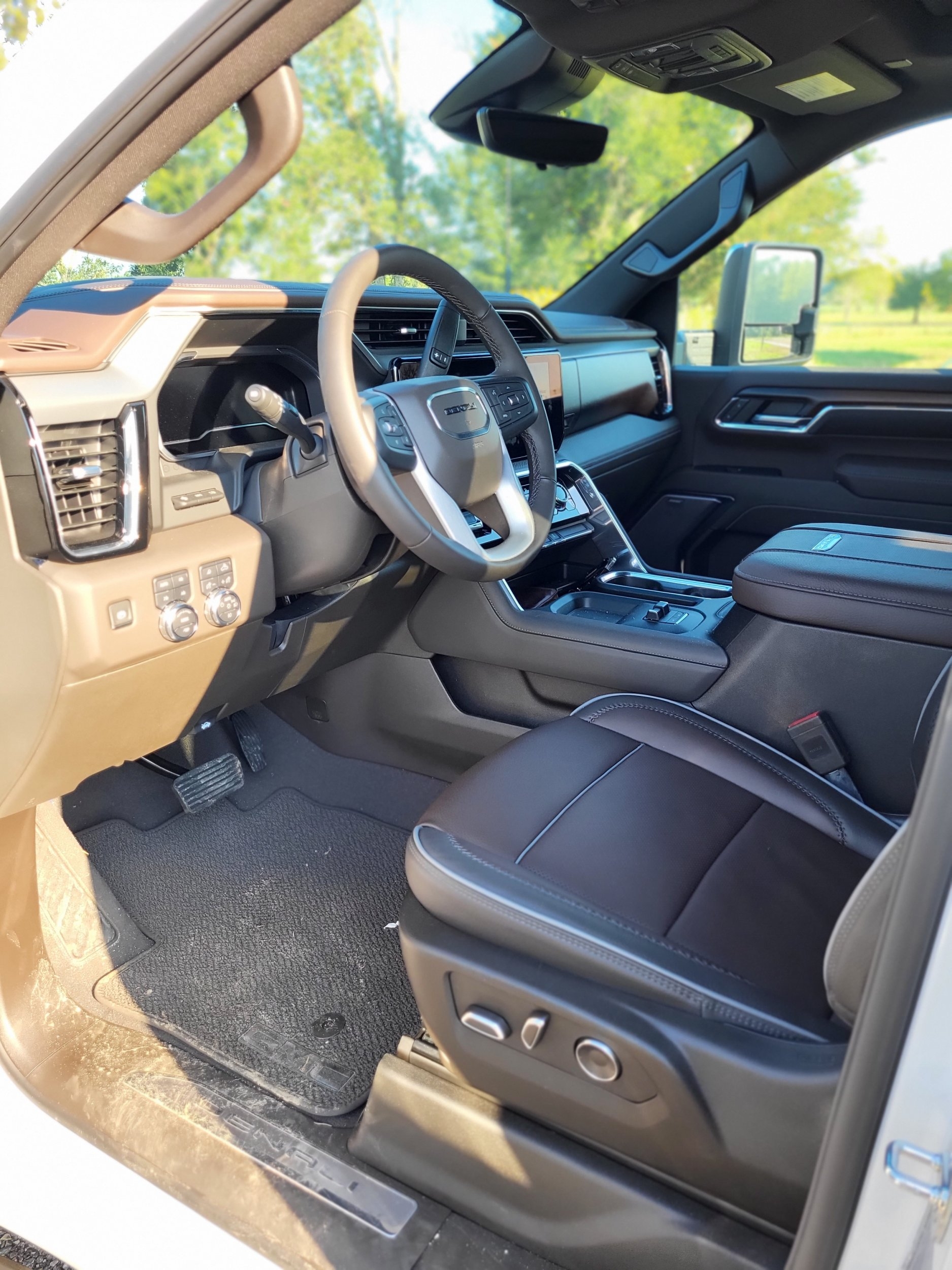

I put a plan together, now that I have retired from the medical field. Step 1, tractor too small - get bigger tractor. Step 2, now trailer too small, get bigger trailer. Step 3, now truck too small - get bigger truck. So I ended up with the NH Workmaster 75, a Big Tex 14 GN 20+5 trailer, and a 2024 GMC 3500HD Denali. Here it is getting ready to go get some coastal square bales for the horses this morning. I added 5,400# working load limit d-rings in the stake pockets. I use 2" straps with twisted snap hooks to tie the hay down. Makes it easy to strap everything down by myself and even if the strap loosens up it can't come off. If I need a strap in between the d-rings I use an axle strap around the rub rail support. Bought 4 new 14' 5/16" G70 chains to tie the tractors down.

Trailer is still too small.
Why on earth would you want a 20 foot gooseneck?
:LOL:
   / Plan Has Come Together To keep Me Busy In Retirement.
#9
:LOL:
It's 25 feet long. There is 20' plus the 5' dovetail with the mega ramps.
   / Plan Has Come Together To keep Me Busy In Retirement. #10
Yes, I get that. But for actually loading equipment (the wheeled, drive up kind), you have to have room for the ramps to fold back up and in on the bed.
For hauling pallets, you have 25'. For hauling tractors + implements, you have 20'.
And I was kind of just "razzing" you a bit.
