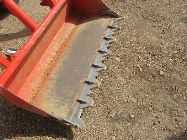

I've the Piranha tooth bar for more than a month. It's pretty heavy duty.
I've used it to excavate 9-10" down in solid clay over an 800 sq. ft. area for a paver patio. It worked great digging and back dragging. Without a tooth bar you can't dig in the hard clay in my yard.

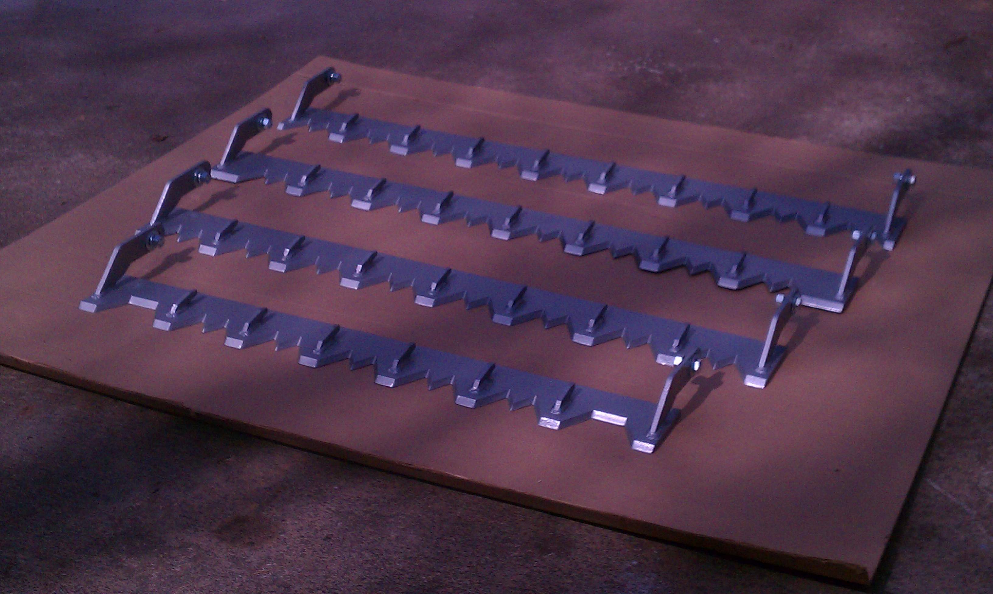

We appreciate your interest. The Piranha sounds like a very good match for your needs.
As for durability, there are lots of Piranhas out there being used on everything from Kubota BXs to the L and M series. JDs 2305s, 1026Rs and others with buckets up to 72" wide. We've equipped a TYM, several Massey GCs and even a 72" Skid steer.
We have gotten only positive feedback and haven't heard of a single problem. There are numerous threads and comments on TBN if you care to search. You can also check the reviews on our website BXpanded for a few comments. I'd think it's pretty unlikely (never say "never") that any normal operation of a 2305 is going to damage the Piranha.
I'm attaching a pretty poor cell phone picture of some of the different sizes we had ready to ship some random day. The smallest pictured is 46 1/2" for a BX the largest is a 66" if I remember correctly.

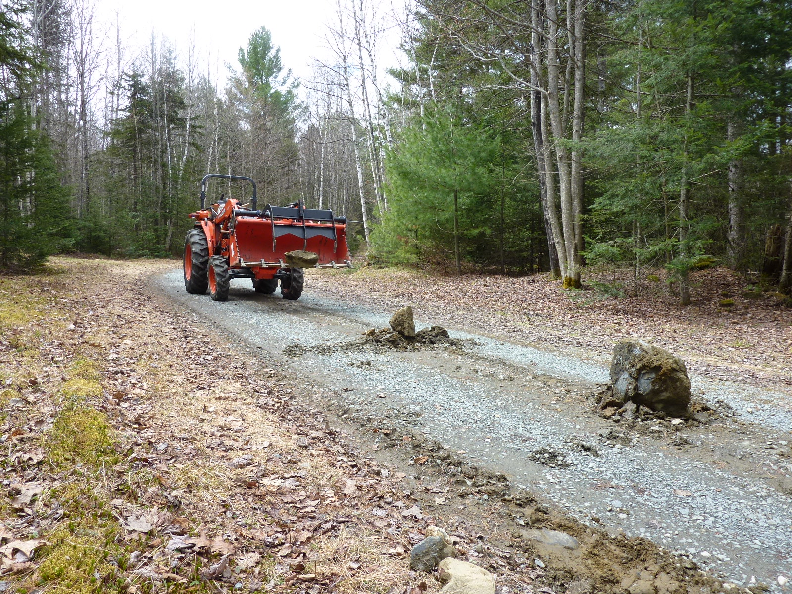

Old thread, sorry . . . but I'm considering tooth bars and curious about the steel used, hardness, and how it holds up with lots of granite rocks!
My wr Long Tooth Bar has been great. I don't know the steel type but it is definately made to dig and pry. I spend a lot of time moving rocks out of my road and skid trails. Since I got the tooth bar it has been a lot easier. These is small compared to many I have moved.
