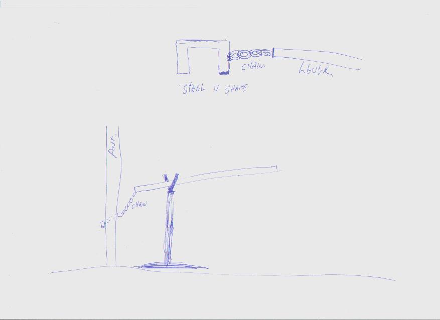

Way back in the 70s i bought (i don't know 3-4 -5 kms of fence of the railways(Gov owned here), at which time they closed over half of the rail-net work here in sth oz. I pulled hundreds of star pickets by hand useing the same sort of thing a big washer on a chain welded to a 7 or 8 ft lever. a stand about 2 ft high with a v welded on top and levered of the stand. I hope this makes sense. /forums/images/graemlins/smirk.gif

Another way which is some what better than a ring is a u shaped piece of steel, then yo don't have to slide it over the post.

There is a company that sells a u shaped device like you've drawn out for pulling t posts. I haven't used that one but I do carry one that is a plate with two different sized holes for different sizes of t posts. It works great.
