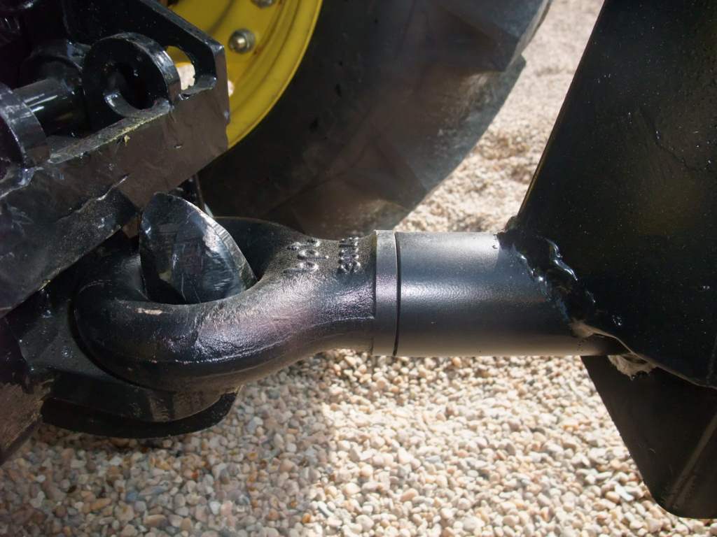

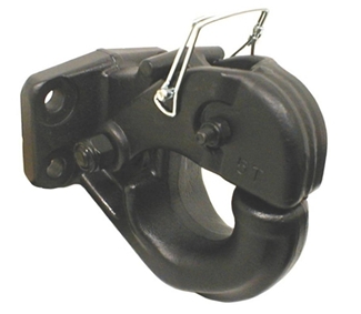

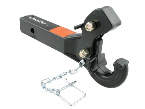

Just purchased dump wagon which runs on tractor hydraulic lines. The wagon has a pintle or military style hitch setup. I would like to find a pintle hitch that would just bolt or pin to the tractor draw bar. Do they exist? Anyone have a better idea?

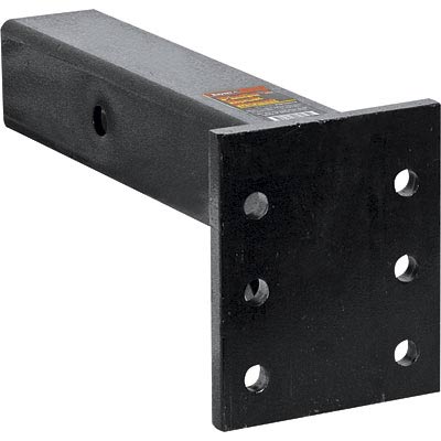

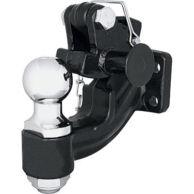

You could buy one with a square shank, drill holes, and bolt it to the drawbar.
Bruce
   / Pintle Hitch For Draw Bar #4
The easiest thing to do is buy or build one of these. Or you can buy a receiver hitch like the pictures above and weld two bolts on the bottom to match the holes in your drawbar and bolt it on...

Wagon rated for 5 tons. With all that weight on the back while dumping, the 3-point hook-up will raise. I need to be on the draw bar and strong. In a perfect world I would have a 2x2 hitch that would bolt or pin on. Does anyone know someone who makes that?

you could weld up a sleave out of 3/8" metal that would slide over your drawbar and pin in place and bolt a hitch on like jpm1 pictured.

You could buy another drawbar and a reciever tube and weld it stright to the bar. A tube is only $20, an extra drawbar $???
   / Pintle Hitch For Draw Bar #9

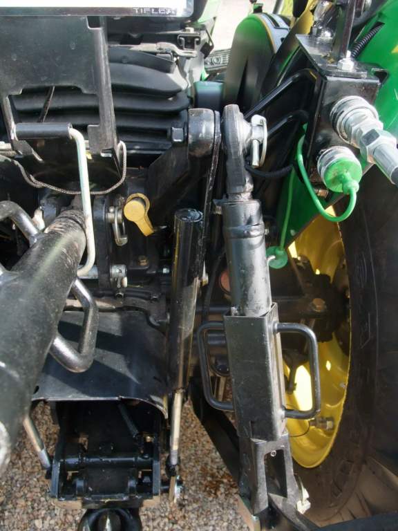

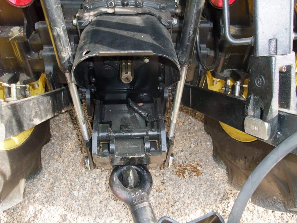

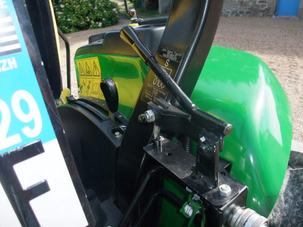

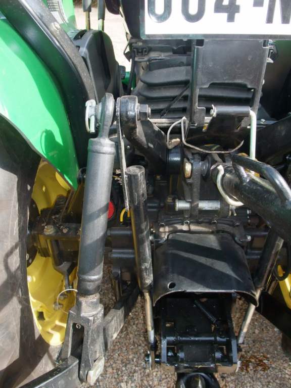

What you want is something like this which allows you to open and close the hitch without leaving your seat (small black lever and cable). Very strong and cannot go up when the trailer unloads.
So go to a 2" receiver on your 3pth, but RAISE the hitch before you start to dump. Once its up, won't go any farther without lifting the tractor....
