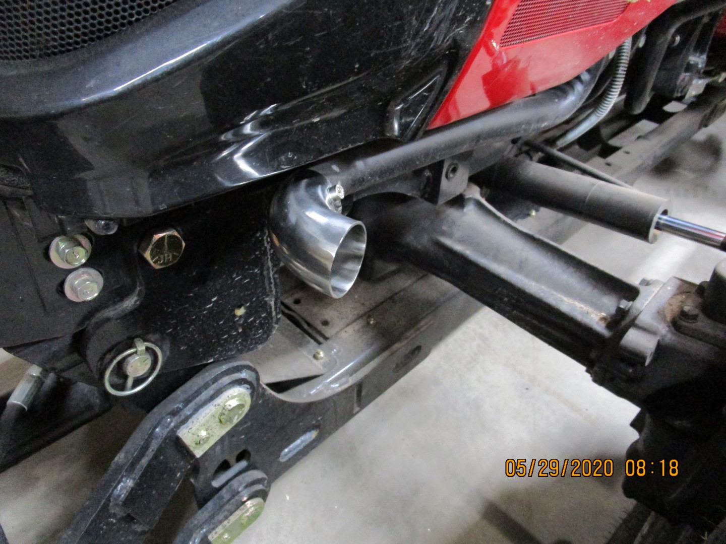

Got tired of the 1526 spitting black krap on startup all over my front blade .. Procured me a stainless 1-1/2" O.D. weld elbow, drilled thru/installed a 10-32 stainless bolt, and now have stainless exhaust tip deflectors on two of my Mahindri... LIFE IS GOOD...!!!!!!!!!!!!!!!! :)

   / Pimp my 1526 exhaust .... #2
Think you'll get exhaust towards you now?
It now points sideways just in front of the left front tire. My 5035 points up behind the right front, and I don't seem to get any fumies there, and that tractor really snorts when you travel up hill at speed. 2555 has a cab, but that used to point right at where my previously yellow fuel cans were, and they got blasted. Fixed that with a tip, too. As far as diesel fumes, if it is running, and you are going in a direction that the wind blows it towards you...... there is absolutely no direction you can point it where there will be no fumes 100% of the time. Part of owning/running a diesel.

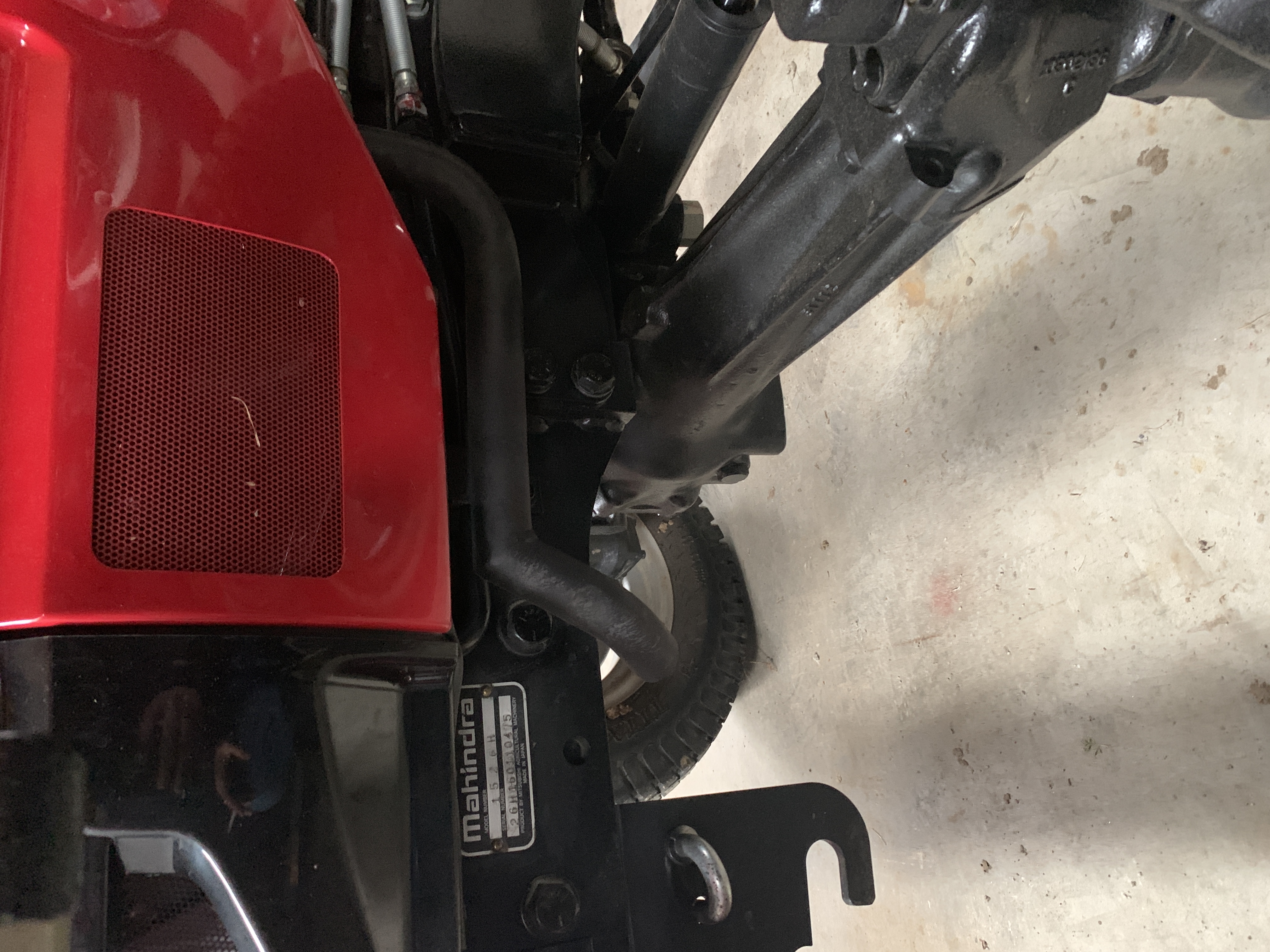

   / Pimp my 1526 exhaust .... #6
I致e cut my exhaust off at the bend and pointed it down and inward. Basically the exhaust is blowing under the tractor to wards the right front wheel. I very rarely get any whiff of exhaust smoke now. However that doesn’t work on yours, because you have something on a subframe on the front. I also modified the battery holder bracket to fit a Group 34 AGM battery.

   / Pimp my 1526 exhaust .... #9
Here is my exhaust modification.
