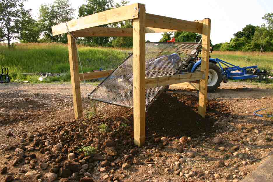

I thought I would just start a new thread with the pictures rather than put them at the end of a thread dedicated to the motor issue.
The motor I am currently using is the largest Air vibratory motor I could drive (VIBCO 55-2). This was just the easiest thing to do quickly since I got it from Grainger.
I have a series of pictures here. In short it works pretty well. I dont even know if I need the motor at all. I am dropping the load from 10 feet onto the screen does most of the work. The Vibco does do a bit (and is loud as heck).
Picture #1 the screen

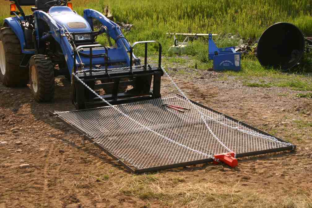

Picture #2 - closeup of the screen (approx dimension 6' x 8')

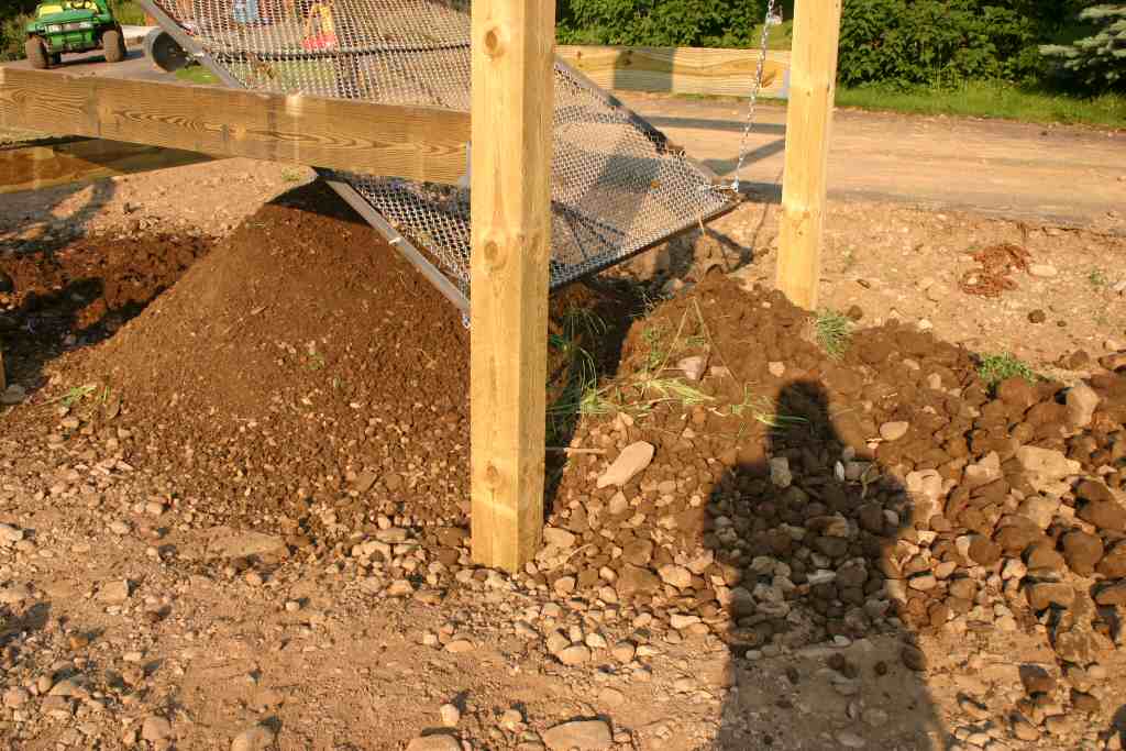

Screen mounted in frame: Built out of 6x6s 8 feet high. You can see the leavin's as well.

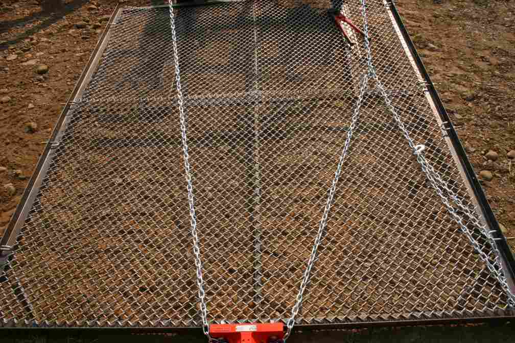

Picture of the output end

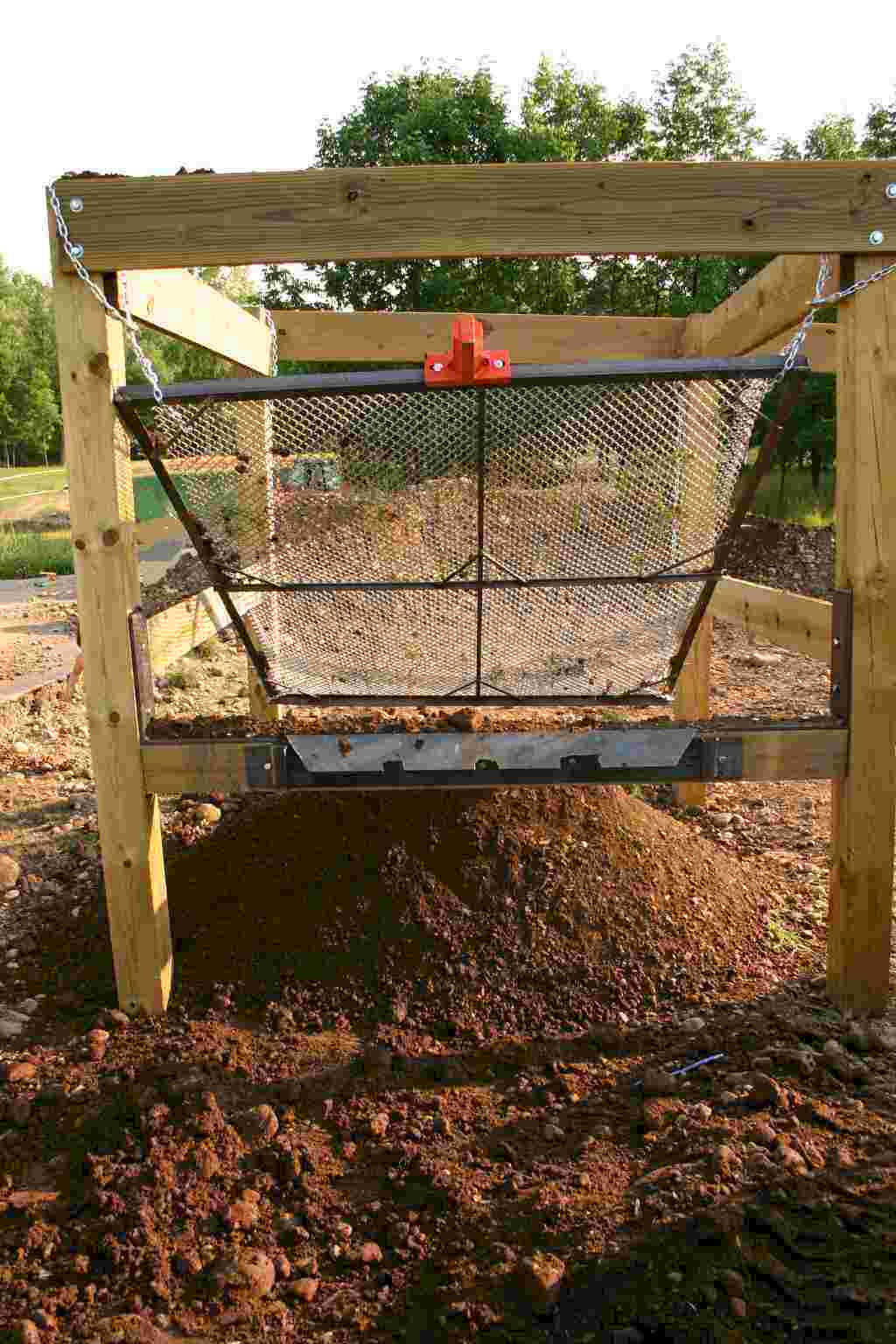

A side view of the results of a couple of loads. To give you a sense the 2x6 crossmember is 3.5 feet off the ground
The screen is made from 9 gauge mini mesh chain link fencing. Ran about $80.
