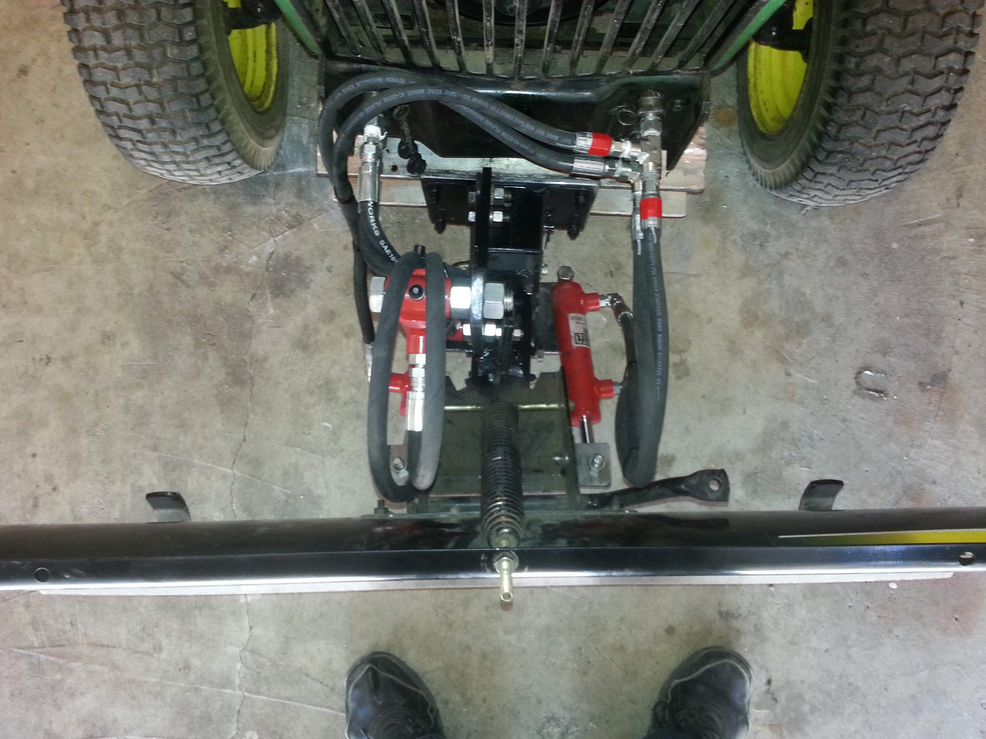

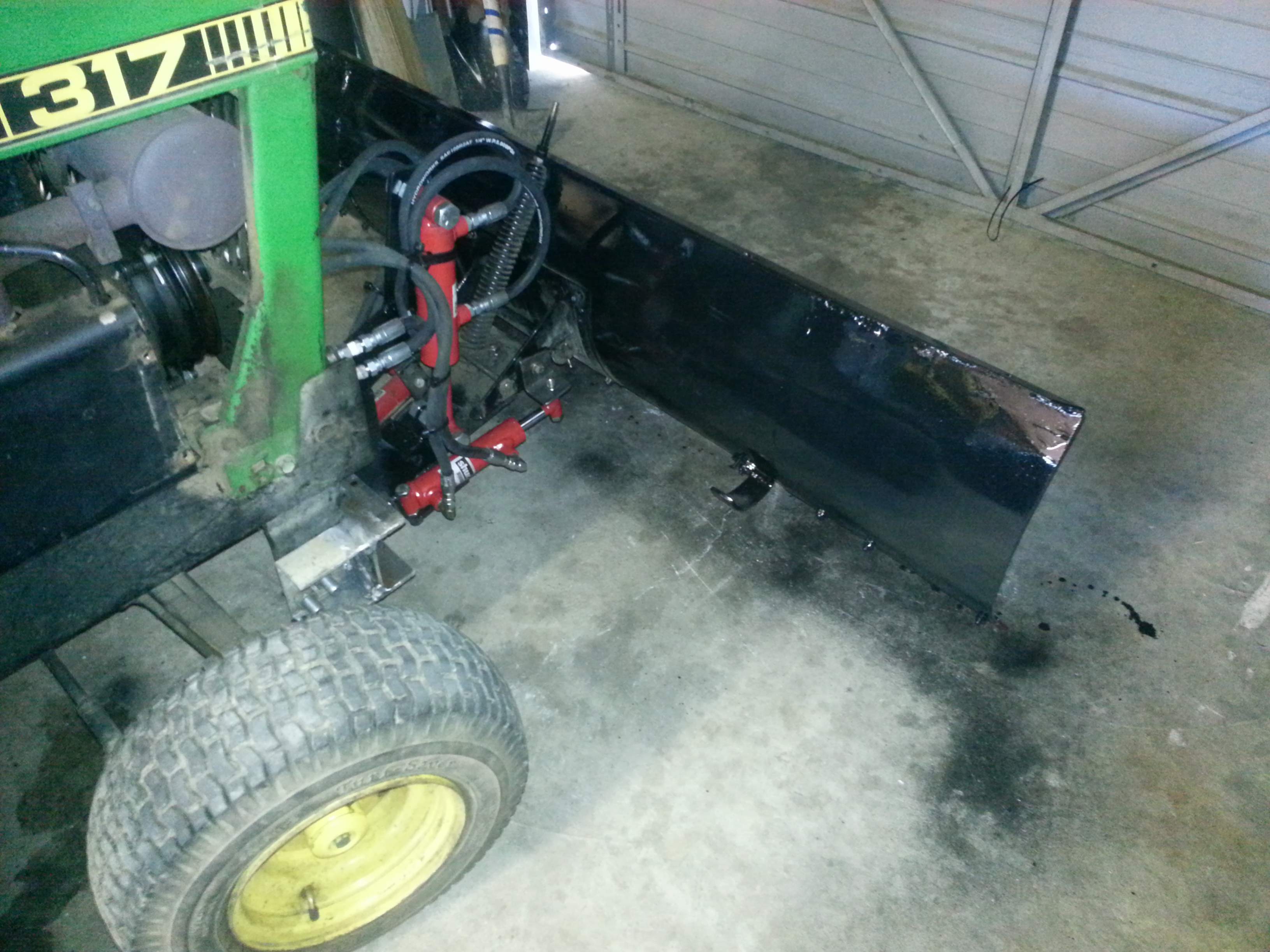

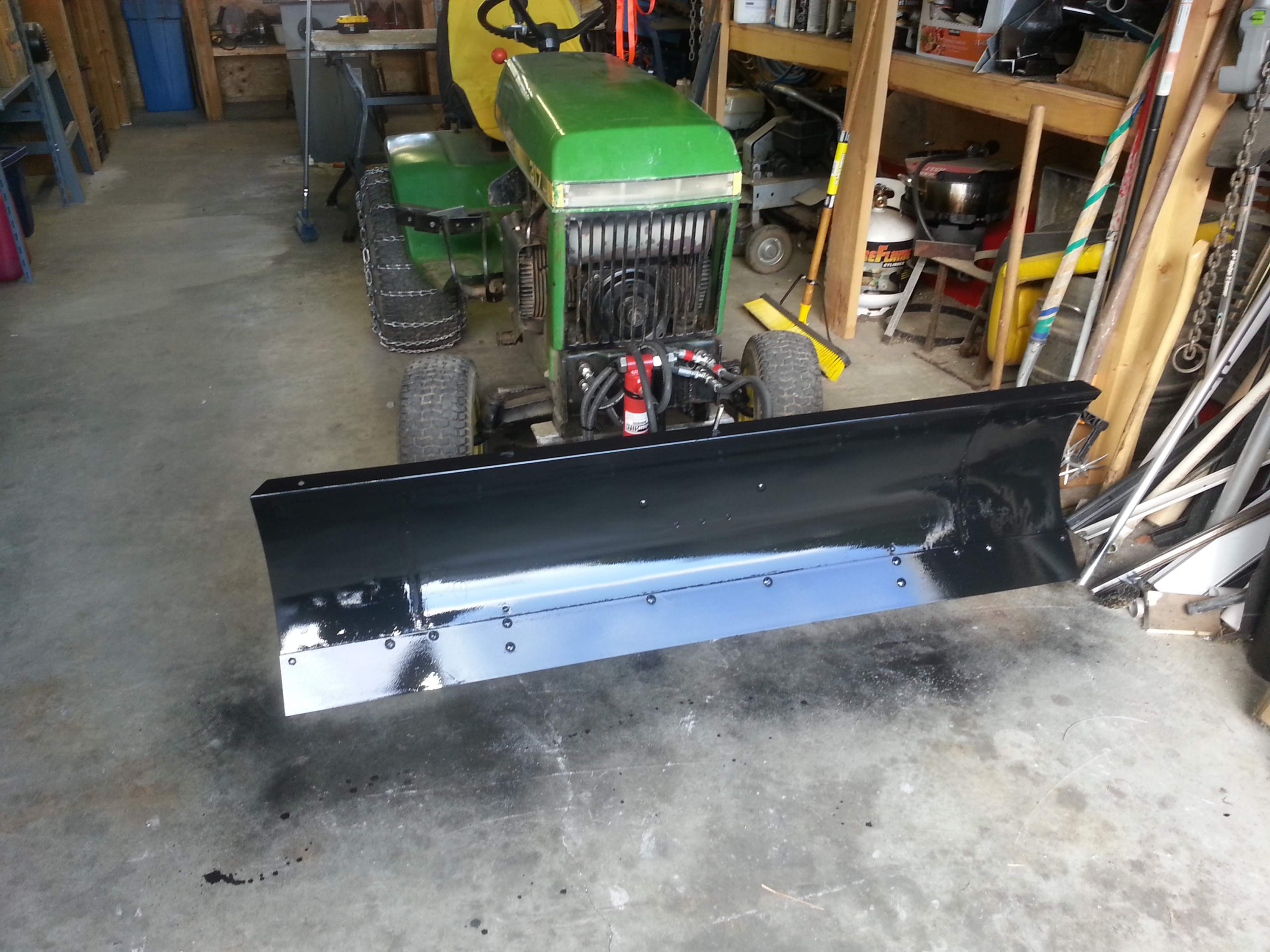

Hello All,

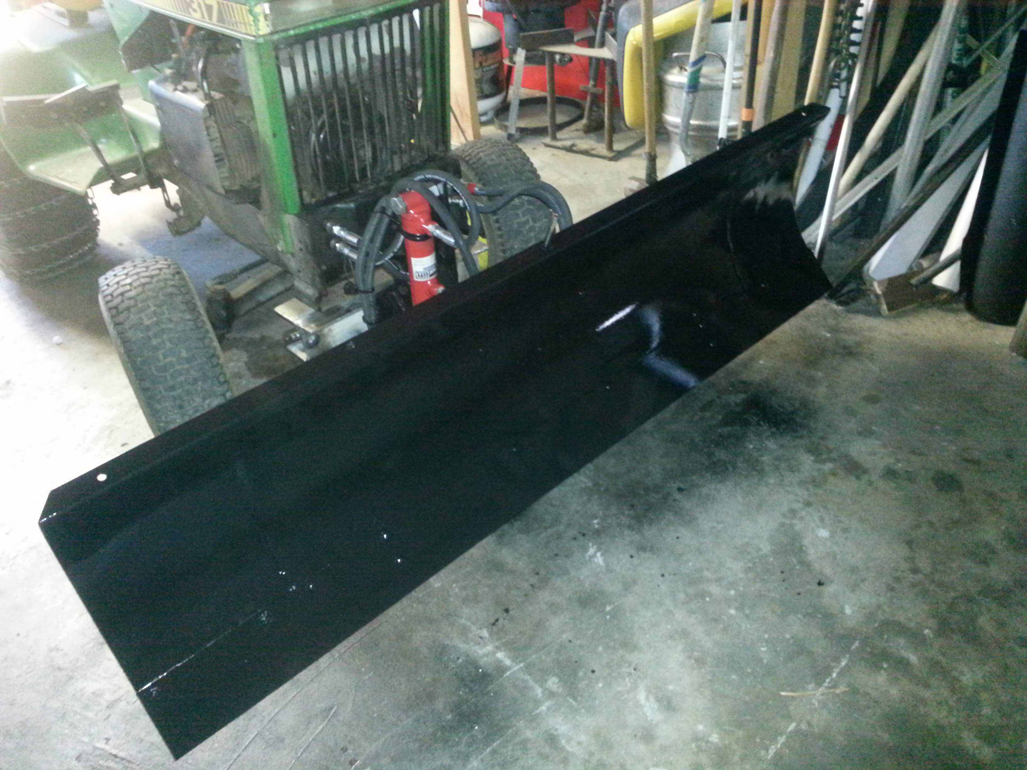

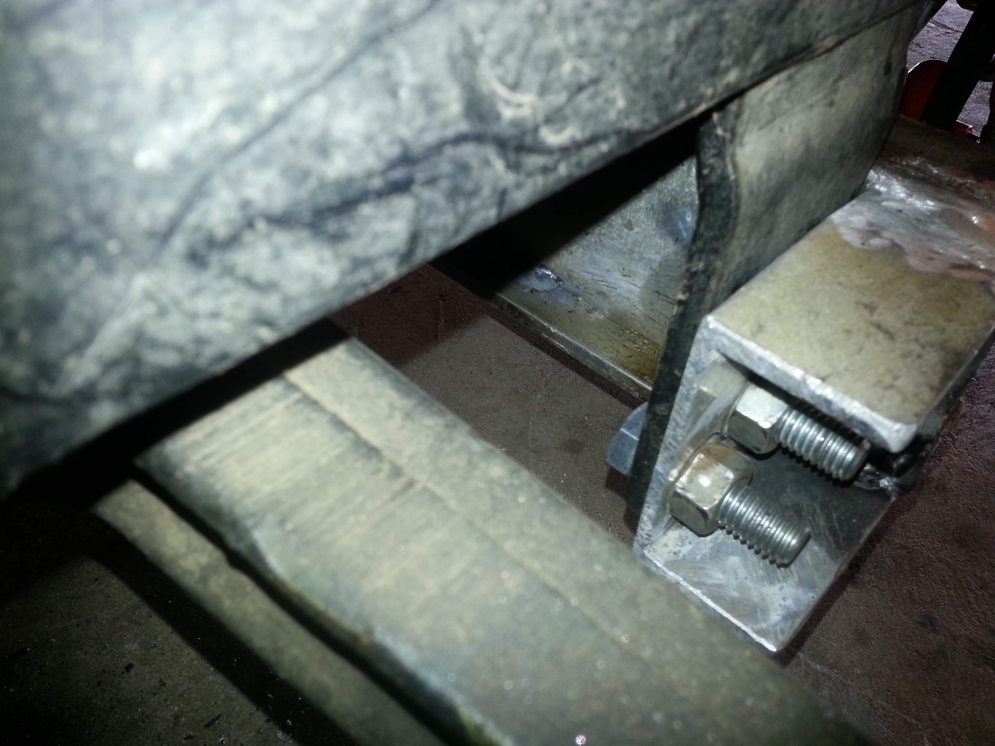

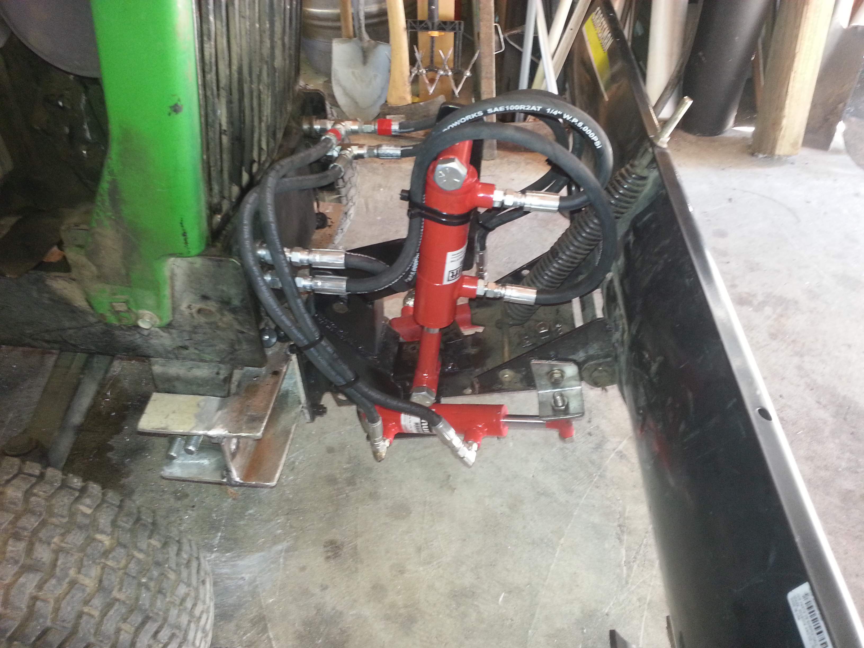

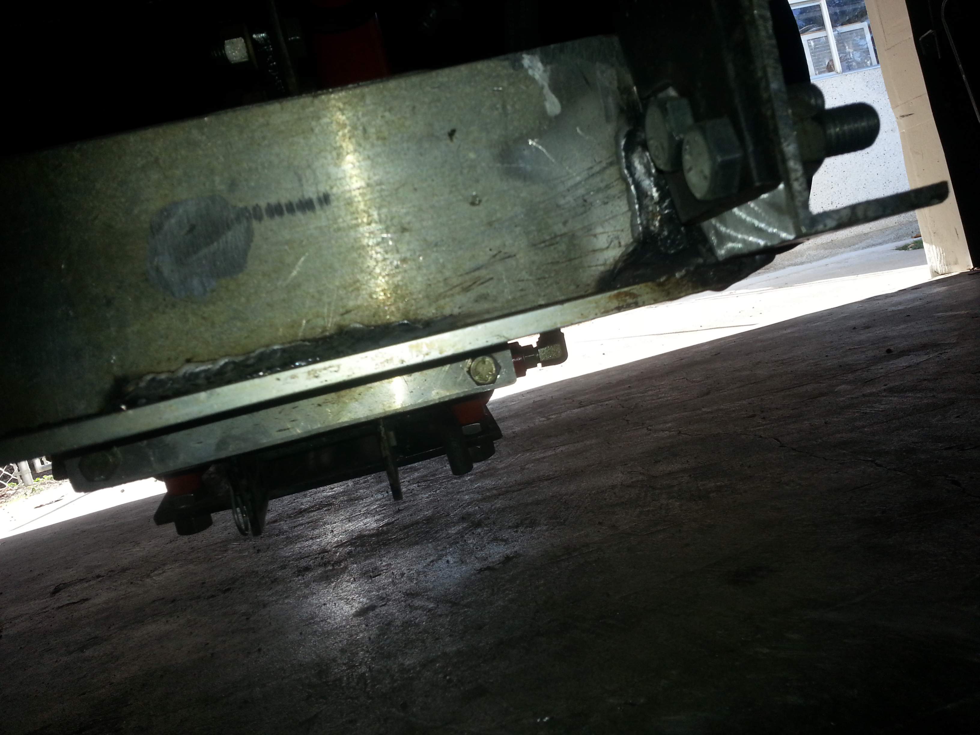

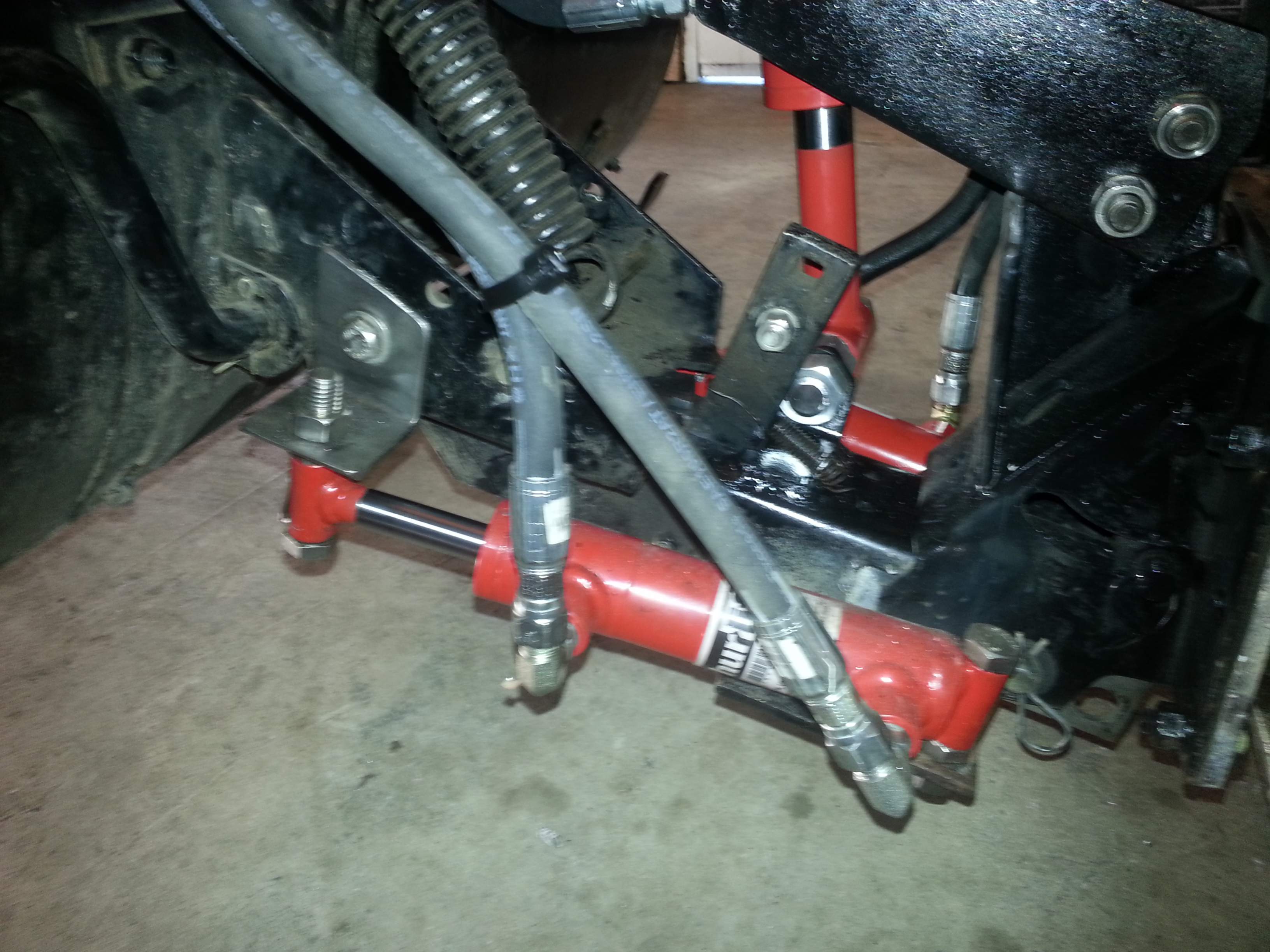

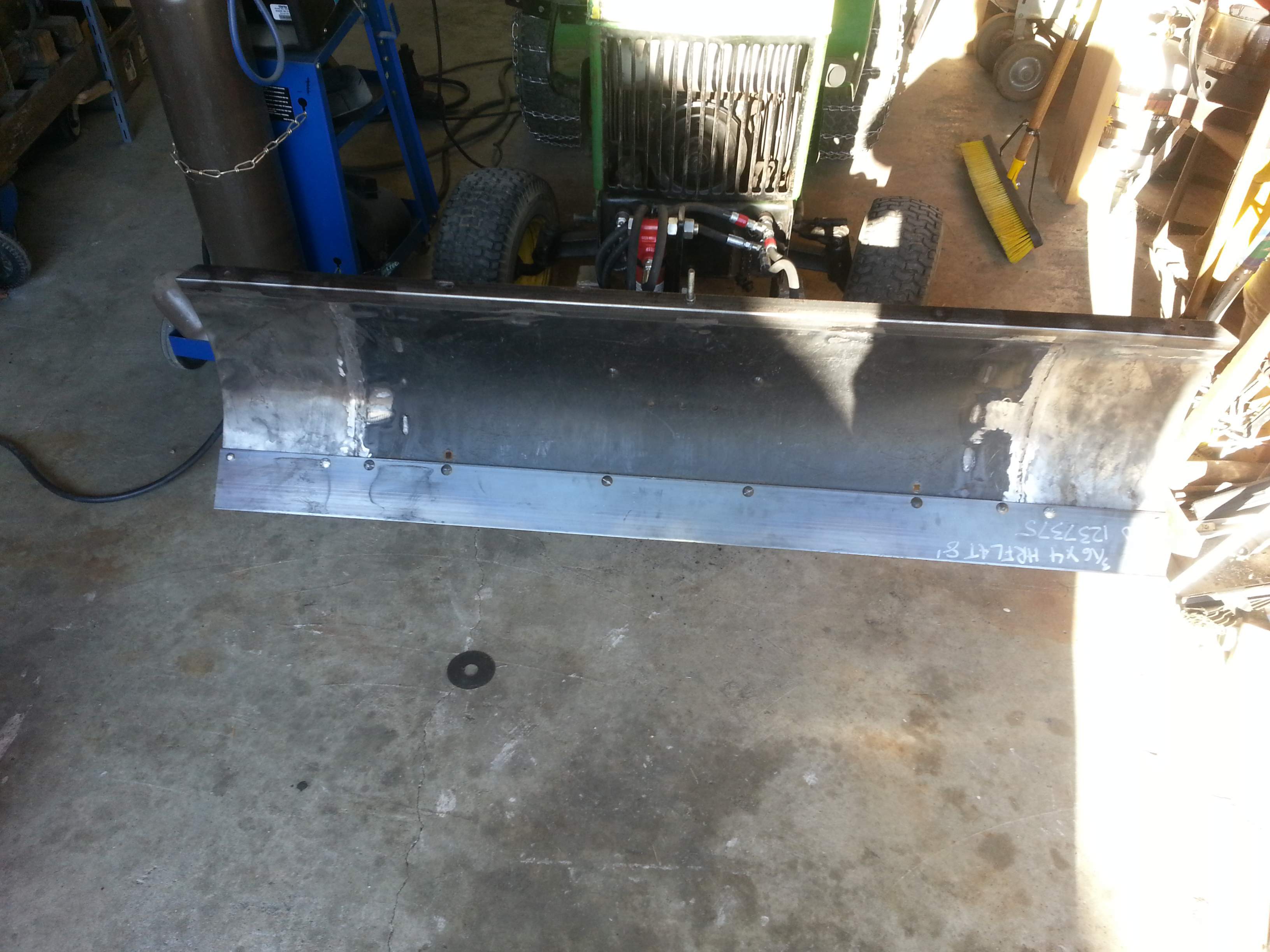

I did a conversion on my Craftsman 42" manual plow and thought I would share and inspire some of you.
Converted to Hydraulics. I was very limited in space therefor had to select cylinders accordingly.
Widened the blade by 9" on each side to give it a total of 5 Feet. Raised the height by 2 1/2 inches as well.
With the removal of 6 nuts I can put this plow back on my L130 as a manual blade in about 10 minutes if need be.
20151120_112917.jpg20151120_112925.jpg20151120_112933.jpg20151120_112945.jpg20151120_113058.jpg20151120_113127.jpg20151120_114615.jpg20151120_114639.jpg

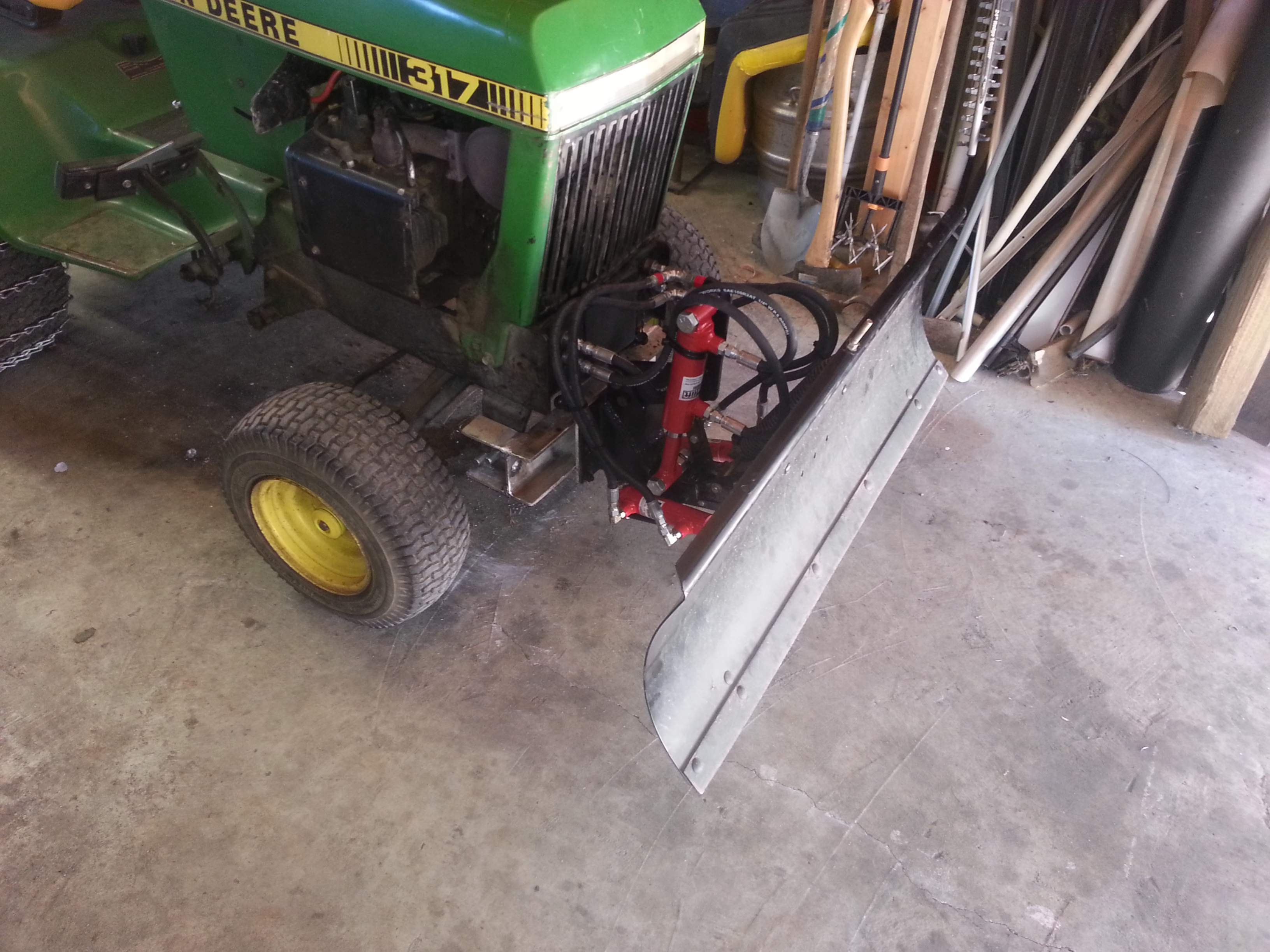

A few more pictures of the blade extensions.
