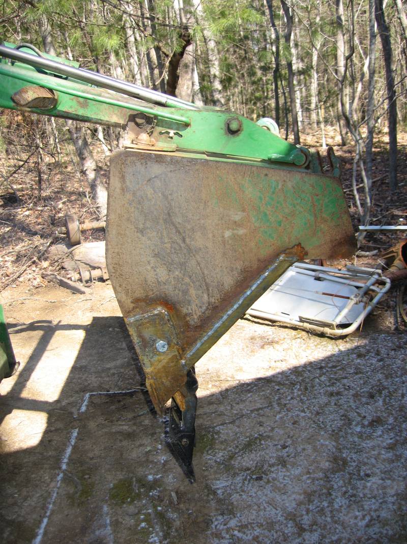

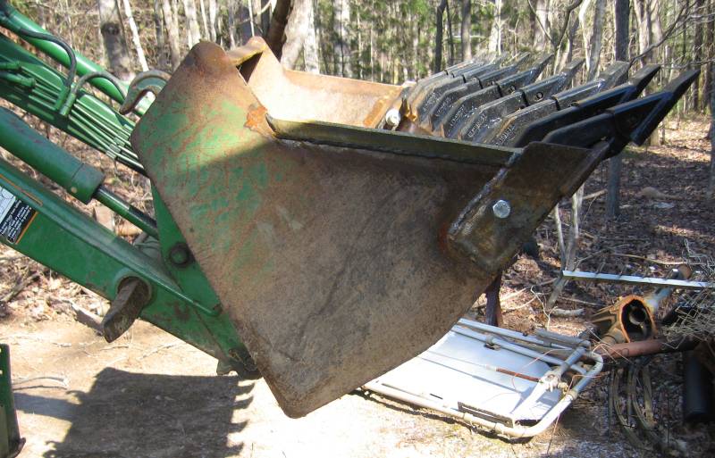

Could someone please post pictures of their JD 430 loader? I need to see what the bucket linkage looks like when the bucket is fully curled and in the full dump position. I am planning to upgrade my 420 loader. I am posting two pictures of my 420 bucket linkage so you can see the views that I need.
Thanks, Marshall

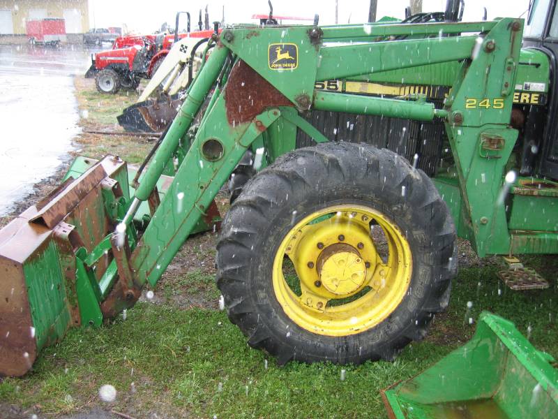

Hi: Thanks for the responses. I plan to convert my 420 loader into a self leveling loader with a bucket dump linkage similar to the 430, 440 or any loader that has the extra linkage. What I need to see is what happens to the bucket linkage when it is at full dump. To convert the loader to self leveling should be fairly simple. I just need to custom make and add the extra parts that are on the top of a mechanical loader like this one:
attachment.php
The hard part will be getting the hole spacing just right so the the geometry works out right.
When I add the extra linkage one the top of my 420 loader the bucket cylinders will be mounted higher and won't reach all the way to the bucket. Adding the extra linkage to the bucket will solve this problem but I might have to shorten the cylinder piston a little (The bucket cylinder piston has about 6 inches of extra piston on it now so it will be easy to shorten.
I haven't collected the materials yet. I have been going to the local scrap yard and looking for just the right pieces of metal. I have some of what I need but mostly I have returned from the scrap yard with about 2000 lbs of future projects.
When I actually start building the self leveling loader I planned on starting a new link . Oh well I guess the cat is out of the bag now.
Marshall
