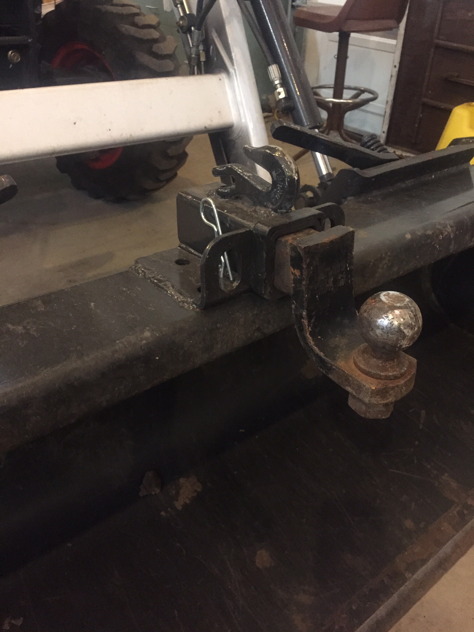

Harbor freight and TSC sells a $50 winch mounting bracket that mounts in a 2 inch receiver. They also sell a small 2 inch receiver they can be welded or bolted on to just about anything. That's what I'm going to do to mine. The bonus of this is you can transfer the winch to anything or anywhere there is a 2 inch receiver and just slide The winch into the receiver and secure with a hitch pin.
I welded one to the bucket of my tractor and keep a hitch ball in there now but will be able to transfer the winch to it if needed. IMG_0325.JPG
