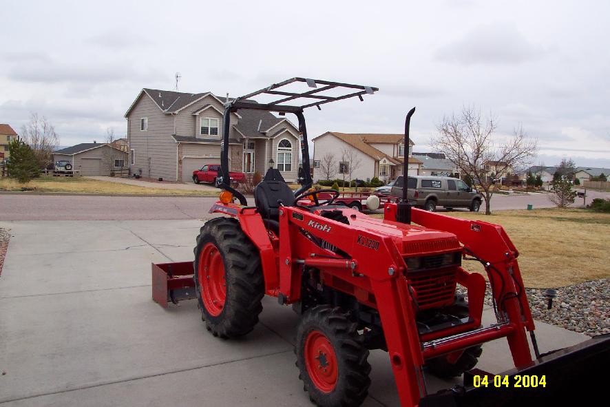

I've been looking around this site for a while, learning as much as I can about different canopies that people have build for there CUT's. I wanted to share a couple of shots of the half way completed canopy that I have come up with for my Kioti.
Curt

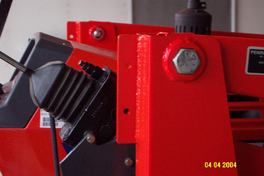

The dry fitting of the canopy skin

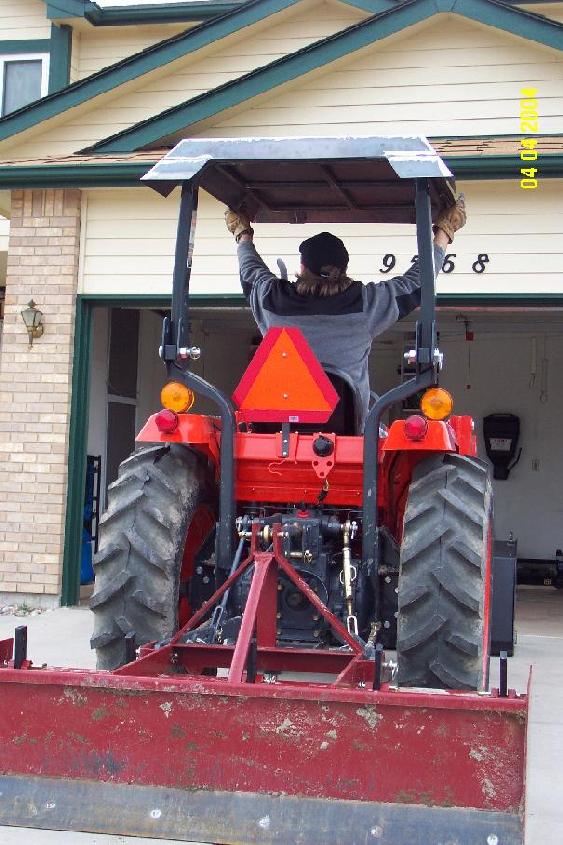

Another picture of the dry fitting

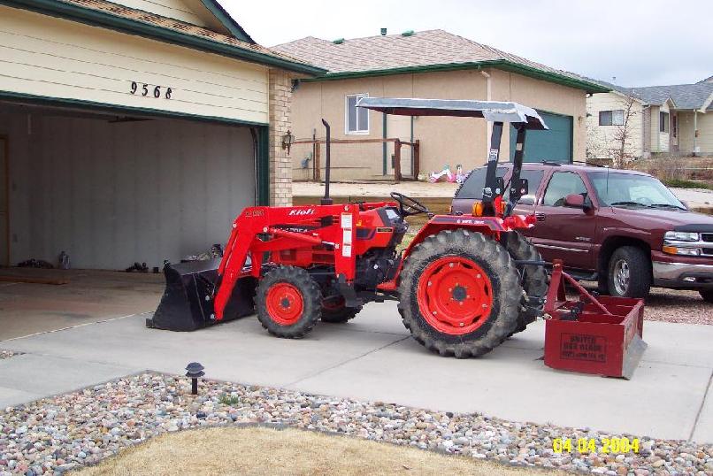

This last picture is the bracket that we welded on the FEL to help in the ease of removal and give extra support in the wind and trailering.. We did this also to make the mounting to the ROPS easier and without large brackets.
Curt

That's looking good. Good idea with those brackets. Make sure you post finished photos.
   / Pictures of Canopy #6
I like the rear corners, good job.
   / Pictures of Canopy #7
First ,welcome to tbn, That is an excellent looking canopy,got that hip roof design ,I also like the rear corner look very sharp!! /forums/images/graemlins/cool.gif
   / Pictures of Canopy #8
Curt, very nice job on the canopy.

Thanks for the comments on the canopy. This whole thing started when I needed to add lights for night work. When all is said and done, the skin will be painted orange and still looking for a match on the ROPS color, which I haven't been able to find yet to paint the front supports. Gonna try and get the front supports bent and welded tonight so I can start spraying this weekend.
