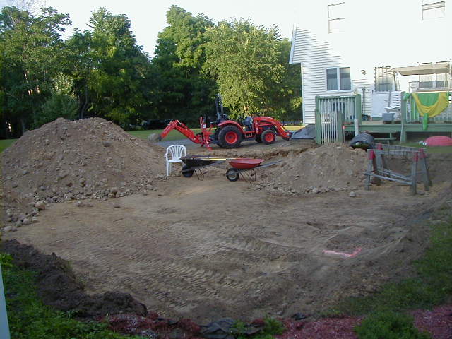

For those of you who asked for pictures when I joined the forum here they are. I have been busy as you can see, installing a new septic tank and leach field. Had to dig the tank with the BH from the leach field level, but did most of the work with the FEL. Good thing as I was finishing with the BH the weld on the right cylinder cracked and started leaking fluid. The left cylinder on the FEL also has a problem with some of the chrome being missing allowing rust spots to appear and pits to form. So it’s going back to the dealer for repairs and a fifty-hour service. /forums/images/graemlins/smile.gif

You definitely have been busy. Being that you used the FEL for most of the work, it's a good thing that your tractor wasn't like Jocassee's returned CK30hst. You probably wouldn't have been able to push even one of those little rocks shown in your picture. /forums/images/graemlins/grin.gif

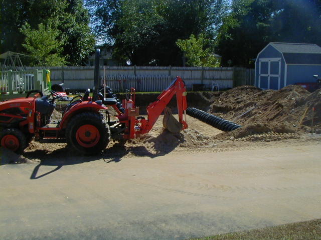

I am of the opinion that the chroming of the piston rod was defective or you would see similar rusting and pitting on all the pistons of the machine. The rest are trouble free. The cracked weld is in the back of the piston where it completely encircles the rear cap about two inches from the end. It is, from the operators seat, the right boom cylinder. There are two identical pistons that operate in conjunction with one another, to move the boom left and right. I found that the best loader digging was in the medium range of the HST gears. Low range actually would dig in too hard and spin the tires. It also was working on loosing the fillings in my teeth. I was very impressed with the ability of the machine to grab a full load of gravel and backup and out of the excavation in medium range. Only a couple of times did I need to drop to low range to get out. On the final load out I had to switch to low range step down on the locking differential to my surprise I managed to clime out backwards about 5 feet up a very stiff incline. There was a slight pucker factor but she did it. The total excavation time on the clock is about 25 hours. Now I have to refill the site after installing the tank and leach fields. I hope to have the machine fixed by next week, but again I will be doing mostly loader work and removing the BH to use a landscaping rake. Another new toy I have to get, /forums/images/graemlins/smile.gif Oh well! Necessity is the mother of procurement or something like that! /forums/images/graemlins/wink.gif Any recommendations on a rake, make model or size would be appreciated. /forums/images/graemlins/grin.gif

That's the swing boom cylinder you're talking about.
