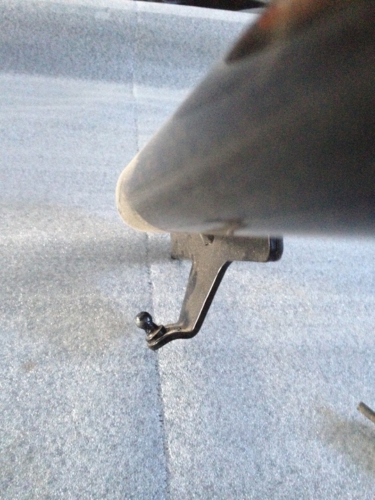

Would someone mind taking a picture of their cab door handle in their 4x20 or 3x20 where the gas closer attaches? I had my door open and it caught on a pile of broken up concrete I was moving. Luckily the glass didn't break, but it did damage the hinges. I took the door off to replace the hinges, and noticed the area where the gas shock attaches may be bent.
Was hoping to bend if back before I had the glass attached again if it needed some tweaking. I attached what it looks like right now. My local dealer doesn't have any cab models in stock right now to compare. The pictures in JD parts aren't detailed enough to see the angle everything attaches.

Hope these pics help. On a 3720.
   / Picture of cab door handle on 4x20 or 3x20
Thanks much, exactly what I needed. Looks like I do have some straightening to do.
   / Picture of cab door handle on 4x20 or 3x20 #7
It looks like the bend is between the ball and the factory bend. That's area I would straighten.
