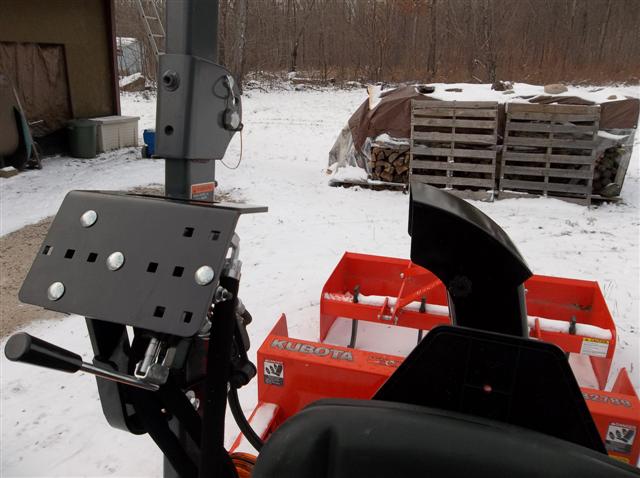

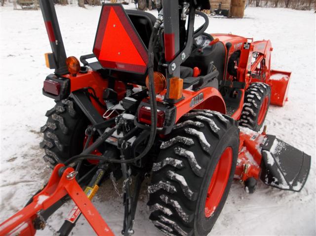

I have a B2920. I have looked for hours for pictures of where people mounted the valve/solenoids and routed there hoses on a B 2xx20 specifically for a third function and found nothing. If anyone has pictures of this, or a link that I missed, it would be much appreciated. Thanks

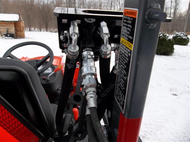

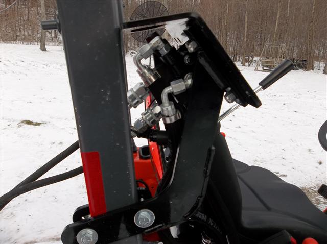

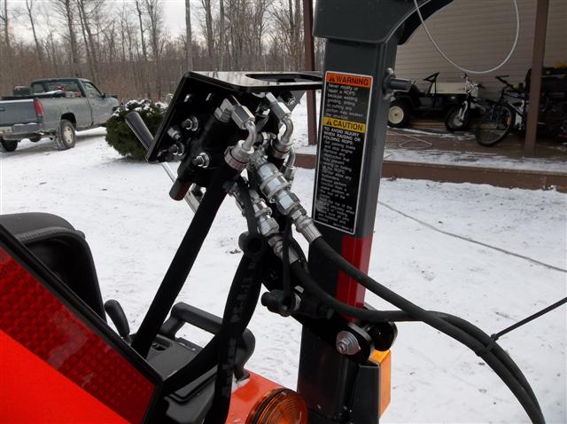

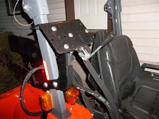

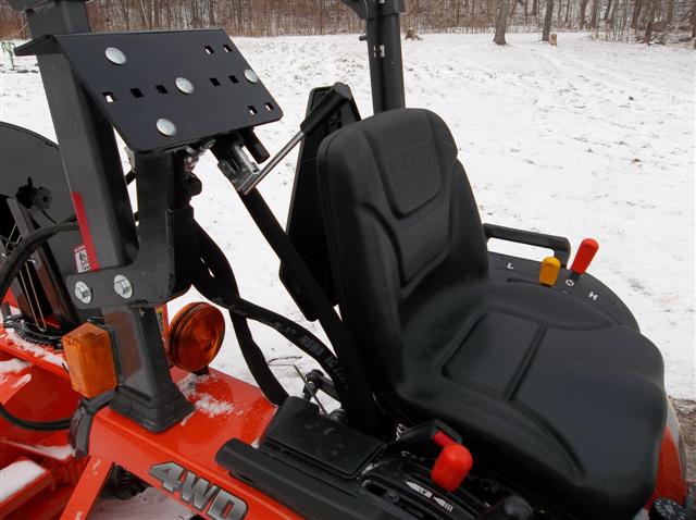

Here's how my dealer set mine up. I only had one installed as I left my chute deflector manual. I only needed this for rotation and for a hydraulic dumping trailer. 101_1285 (Small).jpg101_1308 (Small).jpg101_1311 (Small).jpg101_1325 (Small).jpg101_1326 (Small).jpg101_1327 (Small).jpg101_1328 (Small).jpg
