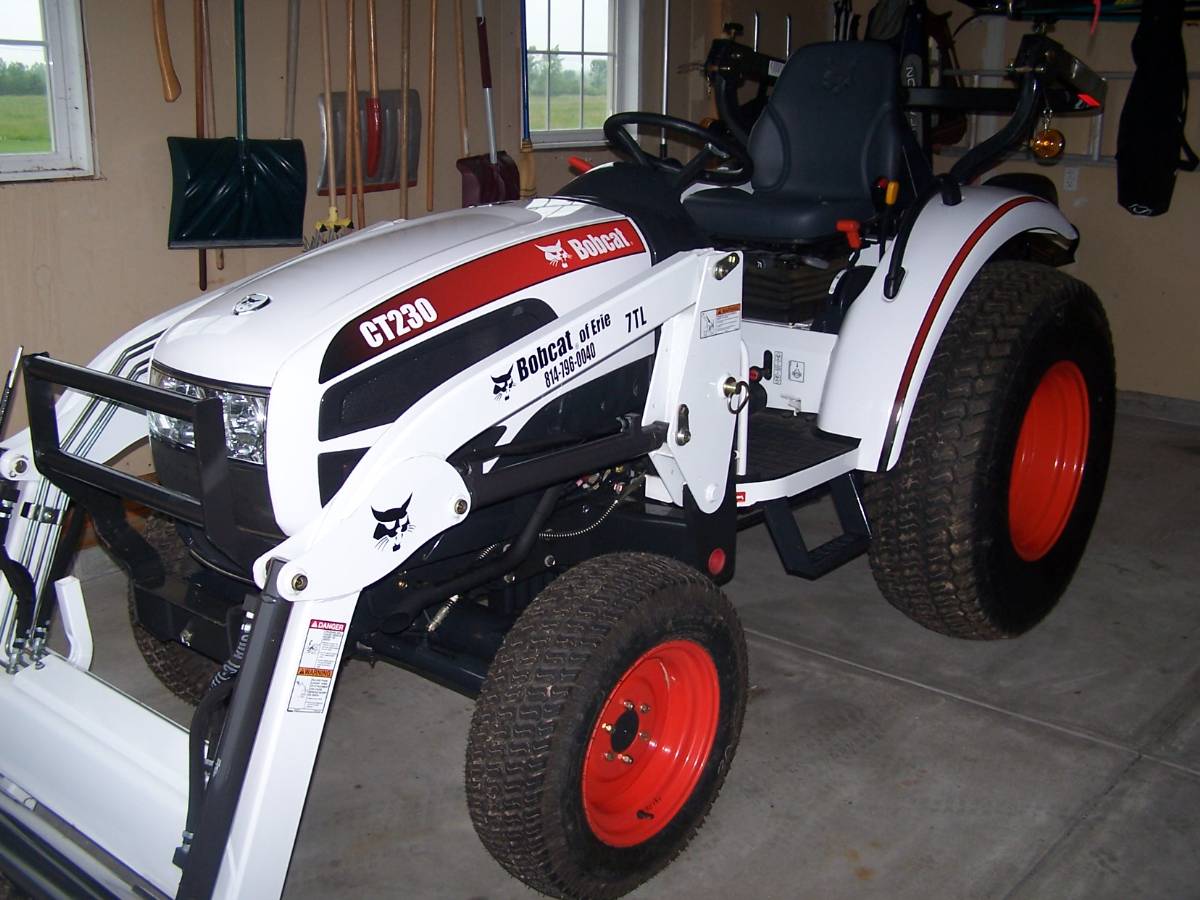

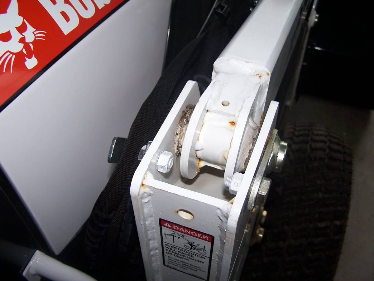

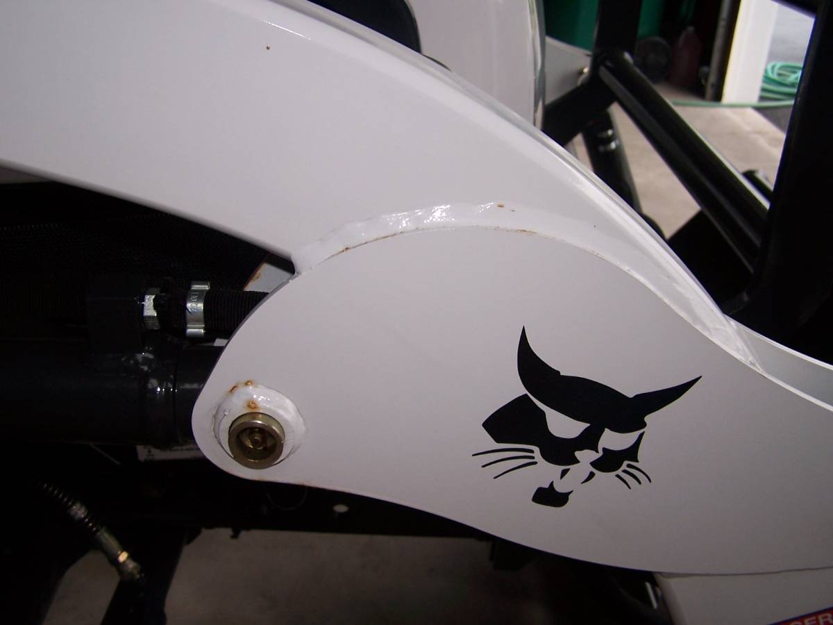

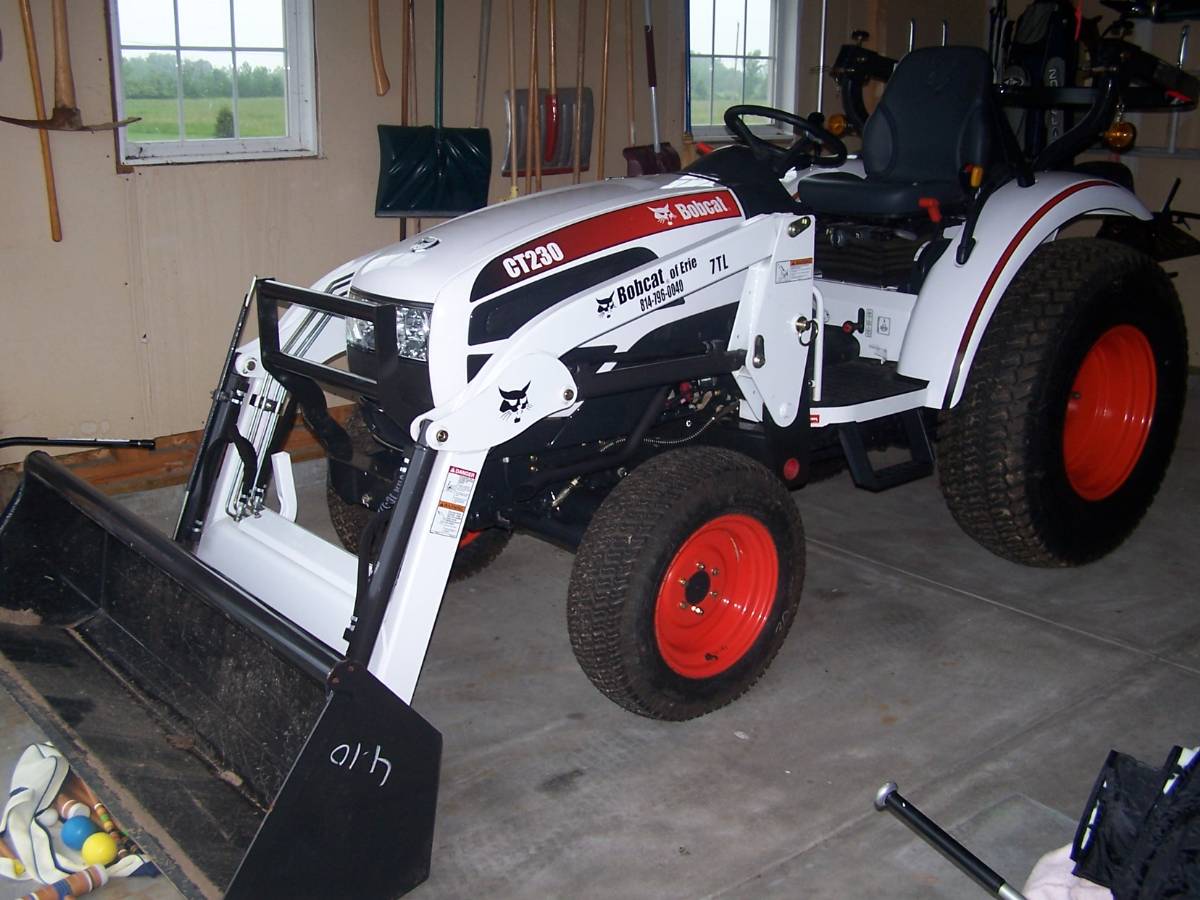

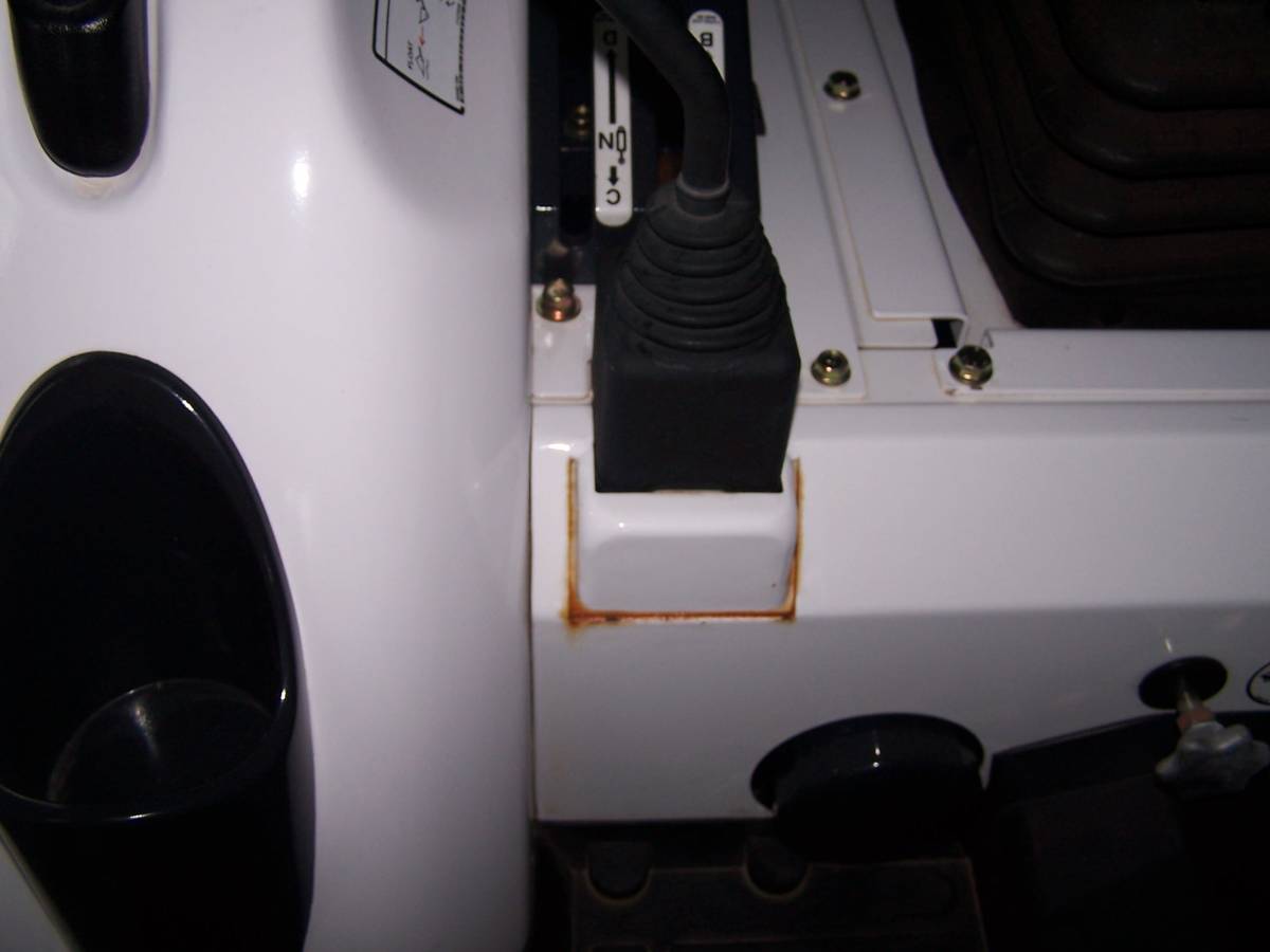

Since there's been a lot of talk about the fit and finish of the Bobcat tractors I'd thought I would post some PICs of what was delivered to me. To me, these were acceptable and consider it somewhat ok seeing that the tractor was sitting outside for almost a year. The issue is the metal body work and the white paint makes rust standout like a sore thumb. Other owners can comment if this is what they received or worst.
BTW - I mixed in a few PICs of my tractor sitting in its' new spot in my garage!
Thanks,
Doug

Looks like that Cat made its first kill (croquet ste under the bucket in the second photo)
Some of those rust spots look like a pain, but nothing major...Clean them up real good and hit em with good primer and topcoat. White shows rust but is very forgiving on touch up.

My ct 230 has rust in similar locations. I am suprised that our grill guards have the same rust in same place. I ordered my ct 230 and when they delivered it I advised the saleman that I was not satisfied with the rust and was tempted to refuse delivery. My major concern, was that mine had rust at the weld points on the underside of the fenders and inside the hood. Andy my salesman assured me that Bobcat would make it right. They picked it up on Weds. and are going to strip it down to the frame and paint it. I thought it would be easier to just replace the fenders and hood. I will let you know how that works out. I must say the my salesman Andy Pawlak of Bobcat of Fredericksburg at 800 296 7340 has been great.
