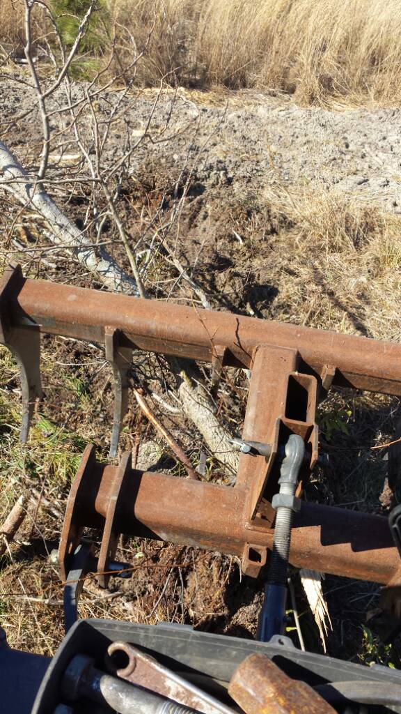

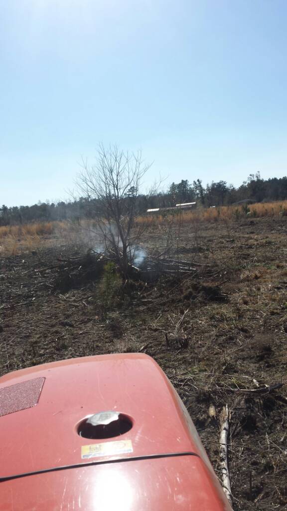

They were an add on though I initially started to cut the tines that way but changed at the last second. They allow me to push backward. Once the pile gets so big it's just no feasible to drive over it so I'll drag stuff up to the pile then cut hard at the last second dump the load then push it into the pile.
Thanks for the information, and nice job!

That looks great. I love the reverse tines!
