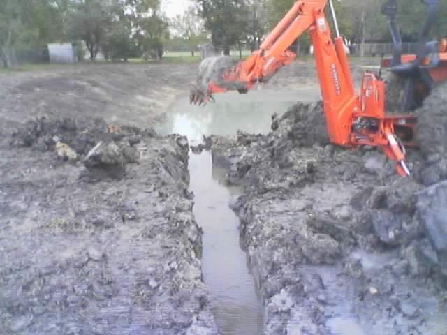

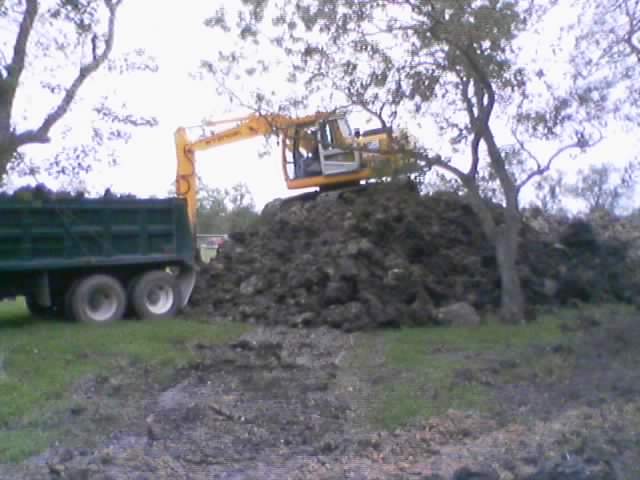

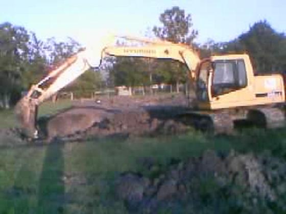

The trackhoe was very easy to run except the levers was almost backwards from my backhoe. Right lever push/pull moved boom up and down instead of the dipperstick out/in once I got that down things went pretty good although the stereo and A/C could spoil a fellow...
Thought we had too much dirt on our hands wound up giving 12 truck loads away.. May have been a mistake the hill of dirt went quick once the dozer started spreading it.
Couple random shots of the pond with the camera phone...
BTW those things put about 15 pounds on you :D
Sat. we are going to start on the pier and pull the dirt off of the base of the trees with the BH..

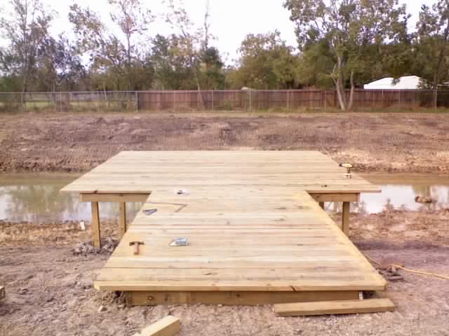

Eddie, the pond is approx. 100' x 85' ~`12' deep I am not real sure how to check what depth we ended up at.. I am starting on the pier Sat. my BIL is letting me use his skid steer with a PH digger, I hope to at least get the poles in before rain comes again.... If I had used my head I could have saved a lot of work and just pushed the poles in with the trackhoe but its gone now..

Have to get some 6-12" O.D. pipe and cut a trench in the banks at each end that will allow water from the neighbors land to drain into the pond and at the other end allow water to exit during heavy rains, may even put some type of mesh wire to stop the fish from swimming away in the ditch..

Max, this was a comibed effort of the trackhoe and dozer. We started out using only the dozer one ~8 hr. day, then the rain came. A couple weeks later we decide to get the trackhoe about 20 hours using both machines trackhoe digging dozer pushing. Then one additional day and a half with dozer only spreading and touching up on the pond. Pushing the dirt more than ~20 yards or so is really time consuming and burns a lot of fuel a bull blade may have helped but a scraper buggy is the best route IMHO if the dirt has to be moverd very far.

A few pictures of finished pier and the water inlets to the pond
