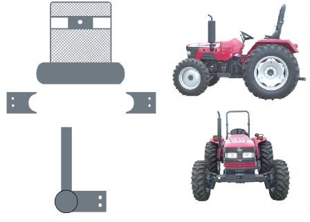

Lastly, the drawing I made of the front bumper and brush guard I made. You can barely see it from a side view on the previous pic (the cleaner one). I will try to get a couple more views of it from the front. I think it turned out nicely and it does the job. All constructed from 4" pipe, 4" end caps welded on the pipe, 1/2" plate for the mounts, 1/2"x2" flat stock for the frame, and perforated metal for the screen.

Nice looking piece! Checked the specs, was impressed to see this puppy has a Cat 1 or 2 lift, dang near 2 ton capacity.
