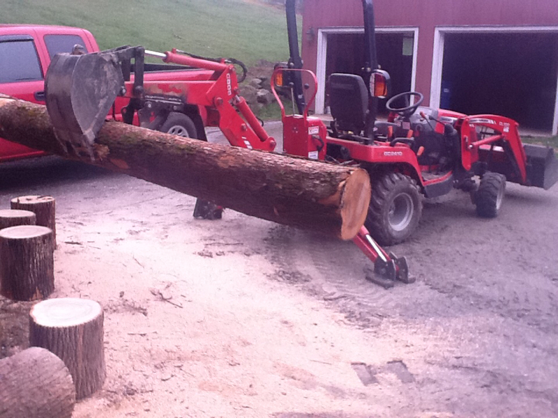

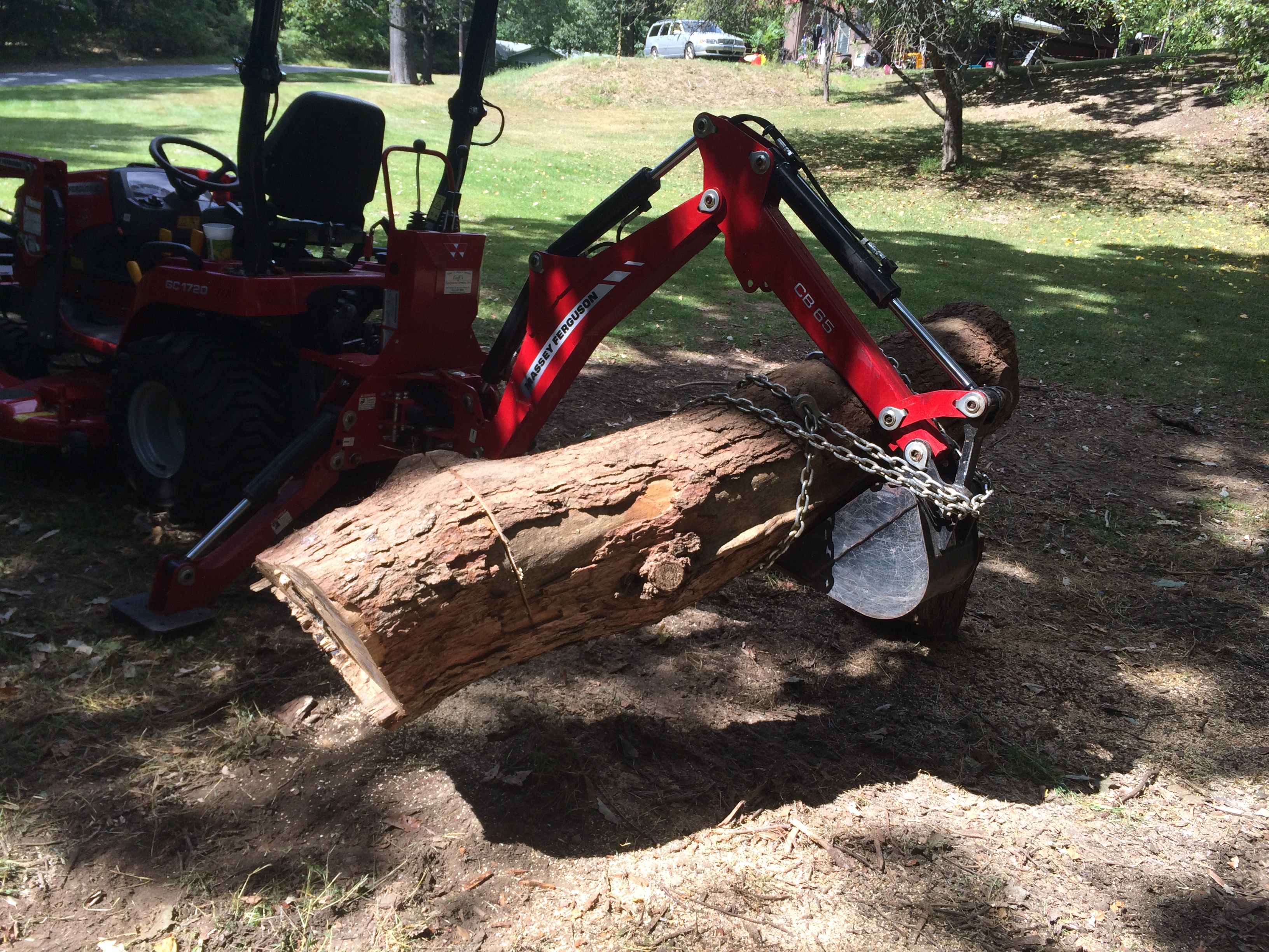

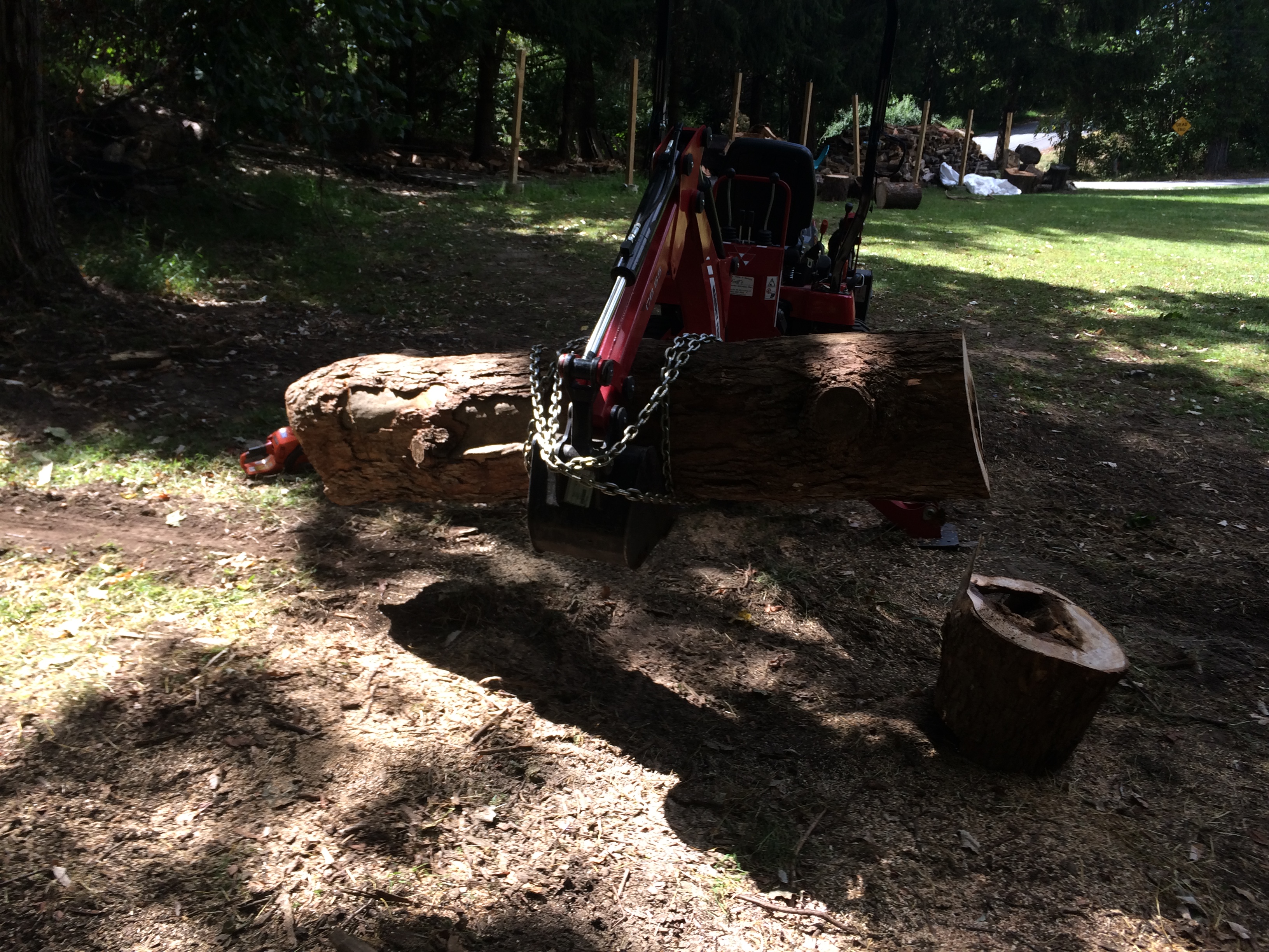

Ok so I have a gc1720 loader/backhoe. I have been burning firewood for a couple of years now but I've been buying split wood. I decided to get some log lengths wood and do some splitting myself. I purchased a dirty hands 35 ton splitter(was thinking of getting rugged made) from Lowes and got the extended warranty. Got a nice Husqvarna chainsaw and good to go lol. Ok well my firewood is in a good spot so I don't have to move it around d far. I hook a chain to a log and drag it like 30 feet to my cutting area. Now I want to pic up the log about chest height so I can cut it nice nice.
For the those who have the thumb and or grapple can you please post some video of it, especially if you got some nice size logs.
This is what I did today, not perfect but I picked up some nice size log with ease. Do you think a thumb on the back of the backhoe could grab the log and hold them steady while I cut them to size?

I have and use both. The thumb is way cheaper and works better for cutting wood, but my loader with a grapple is way stronger than the backhoe. I have more pictures on my iPad I'll upload later. image-3927296769.jpg

Ooklaa,
Those are big diameter logs. If you used a true fork set and a chain (not clamp on forks) , , you could either lift and relocate the log and cut left side, right side, and then center cut (between the forks). Then if the log isbig and long you could just pick up one end to cut the log smaller so you could lift and relocate.
But chest high seems too high a lift height . . Plus too tall a drop for logs that size. Jmho

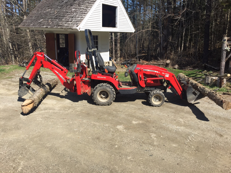

Here are a few of mine , I made forks for the bucket by bolting in some steel. They work well

Get the thumb, it will be a lot easier said and faster then the chain method . I can lift most of my logs with the BH to a nice cutting Hight ,

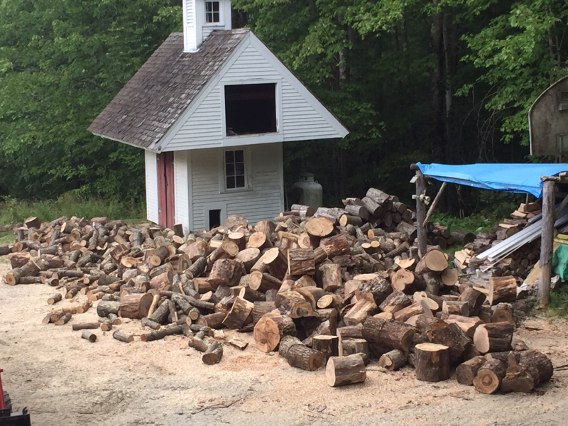

Cut this up yesterday but don't have any action shots of the tractor, was too busying working

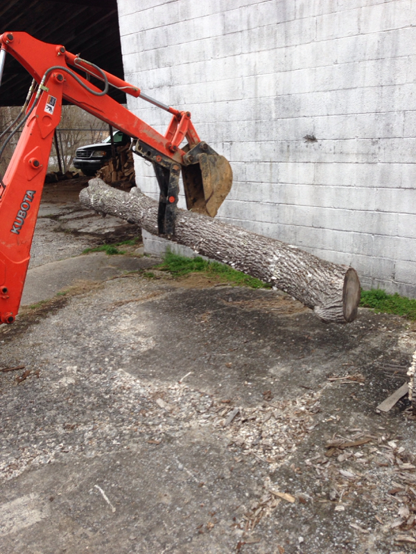

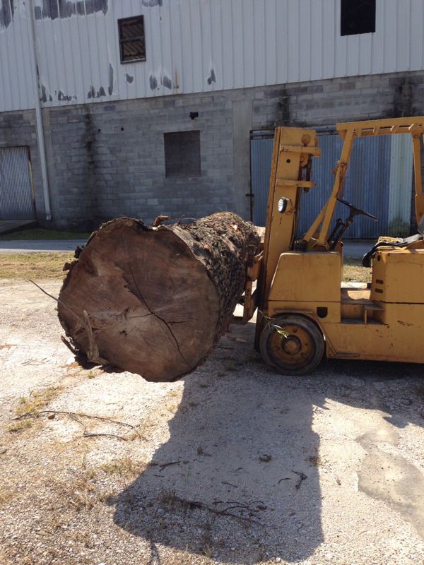

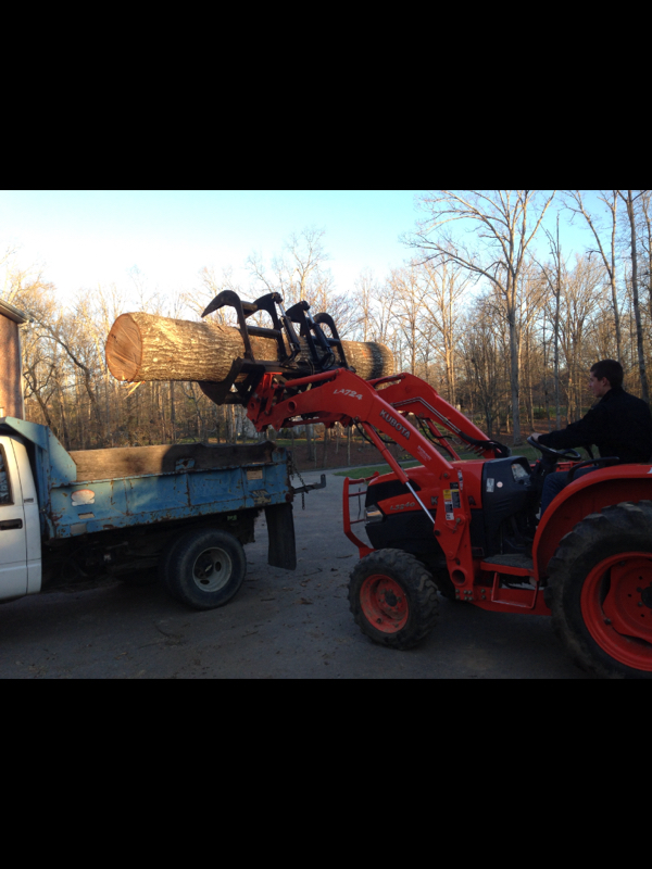

The backhoe thumb can clamp onto a log a lot bigger than the backhoe can actually lift. Pallet forks also work decent. image-3068344317.jpg image-1290757717.jpg image-3926416618.jpg The log being loaded into the truck is a 24" diameter 11" feet long red oak. The log on the forklift is 42" diameter and 11' long. My grapple could clamp around that log, but lifting it wasn't about to happen. I also loaded these maple logs with my grapple. The biggest is 36" and 8.5 long. image-1037161976.jpg Here's what became of the maple log. image-713830263.jpg I got over 2 cords of wood out of that tree even after saving the main trunk section.
