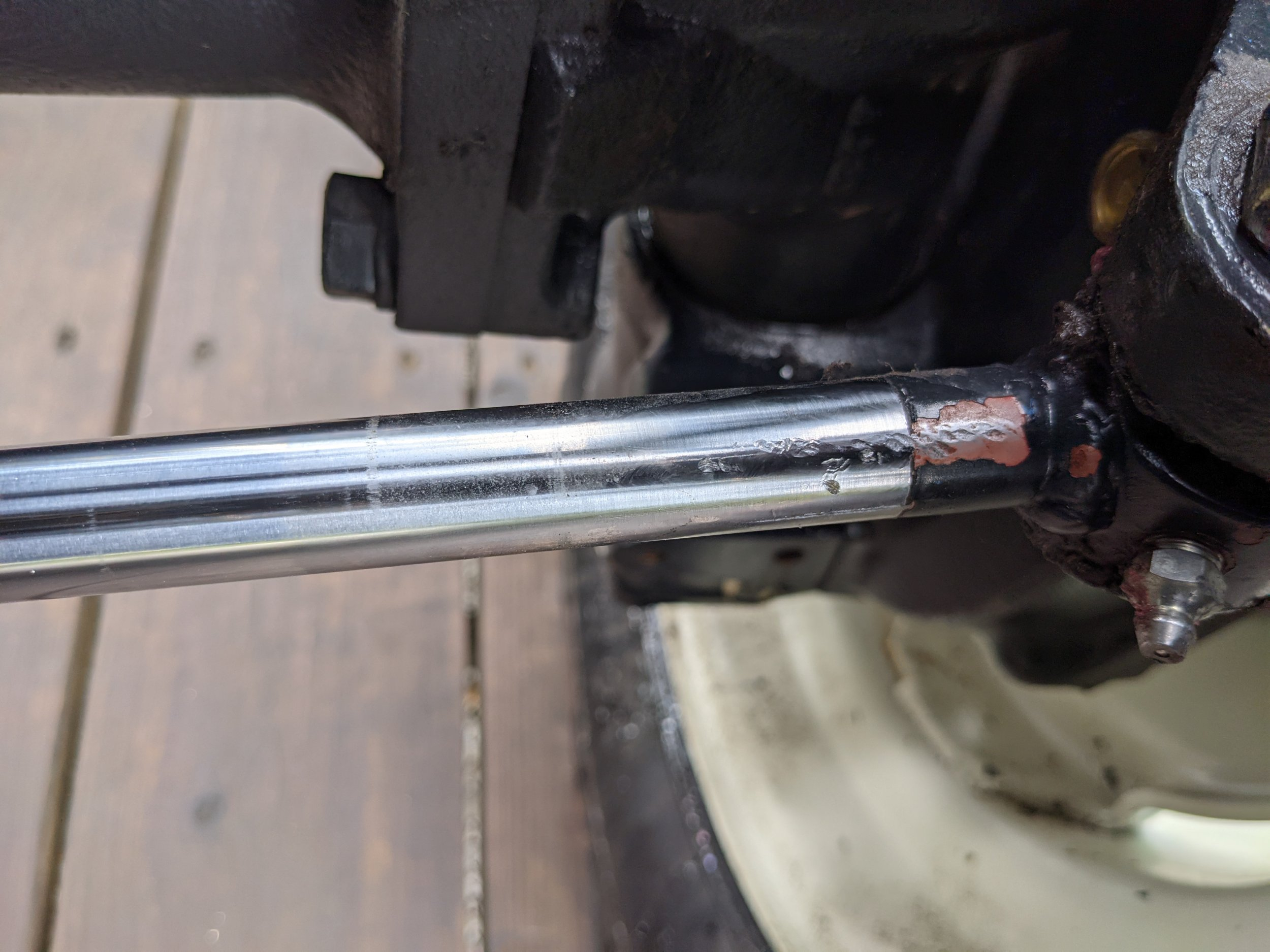

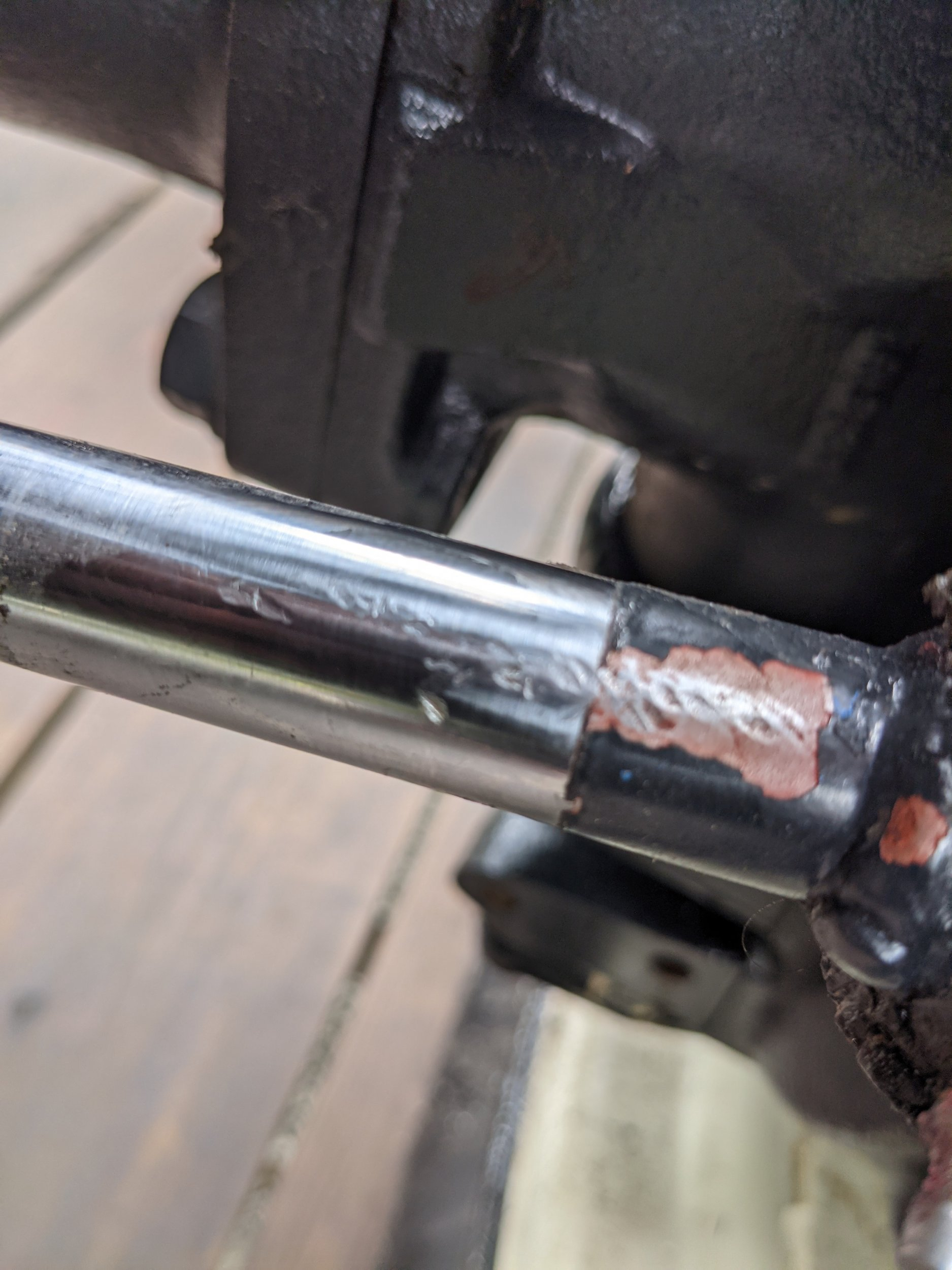

Picked up my tractor after getting the axle seals replaced (seal between the center section and portal box) and noticed tooling marks on the chrome of the right steering cylinder. Some of the tooling marks even have a burr. Called them up after I got home and with it still on the trailer I noticed the damage. They said they would call me back to tell me what they would do. When they called back they said they would have to talk to the tech tomorrow to find out what he did. How likely is the tech to fess up to this? Tractor has supersteer so two cylinders. 750 hrs. Kept inside, even went so far as to wax it so not neglected.

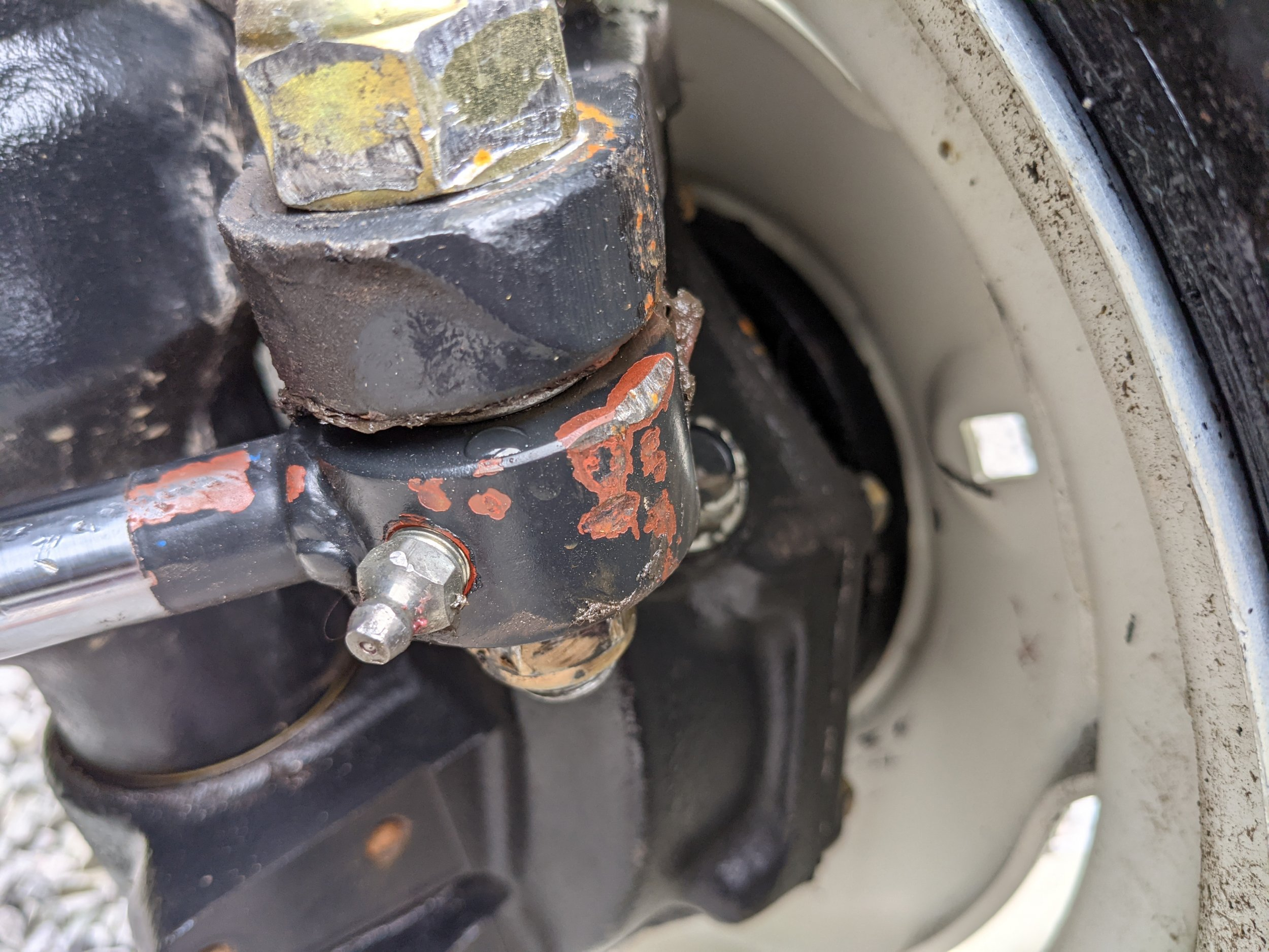

That doesn't even look like the correct bolt through there. I think the bolt should be a double end shoulder bolt with threads and nut top and bottom. And what is going on with the orange paint showing through? Are these parts off of some other tractor?

Oringinal hardware as it is the same on the other side. I believe the cylinder is original too. The orange is the primer I believe. Looks like they hammered the heck out of it to remove it from the knuckle. Why in the world would you hammer on the chrome part of the cylinder.

Dealer called me back this morning and said he didn't like his techs answers and asked for pics. Sent them and I called back a couple hours later to confirm that they recieved the pics and they said yes they did and are working on getting me another cylinder currently.

That is just horrible work ethics by the technician. It wouldn't be hard to use UHMW or wood blocks to put that in a vice trying to get the knuckle out without marring up the chrome.

Didn't use the forks to separate the knuckle.

Keeping this updated. After not hearing anything for a week I called them this morning and the dealer said the cylinder is not available any more so they are looking into getting the cylinder rechromed.
