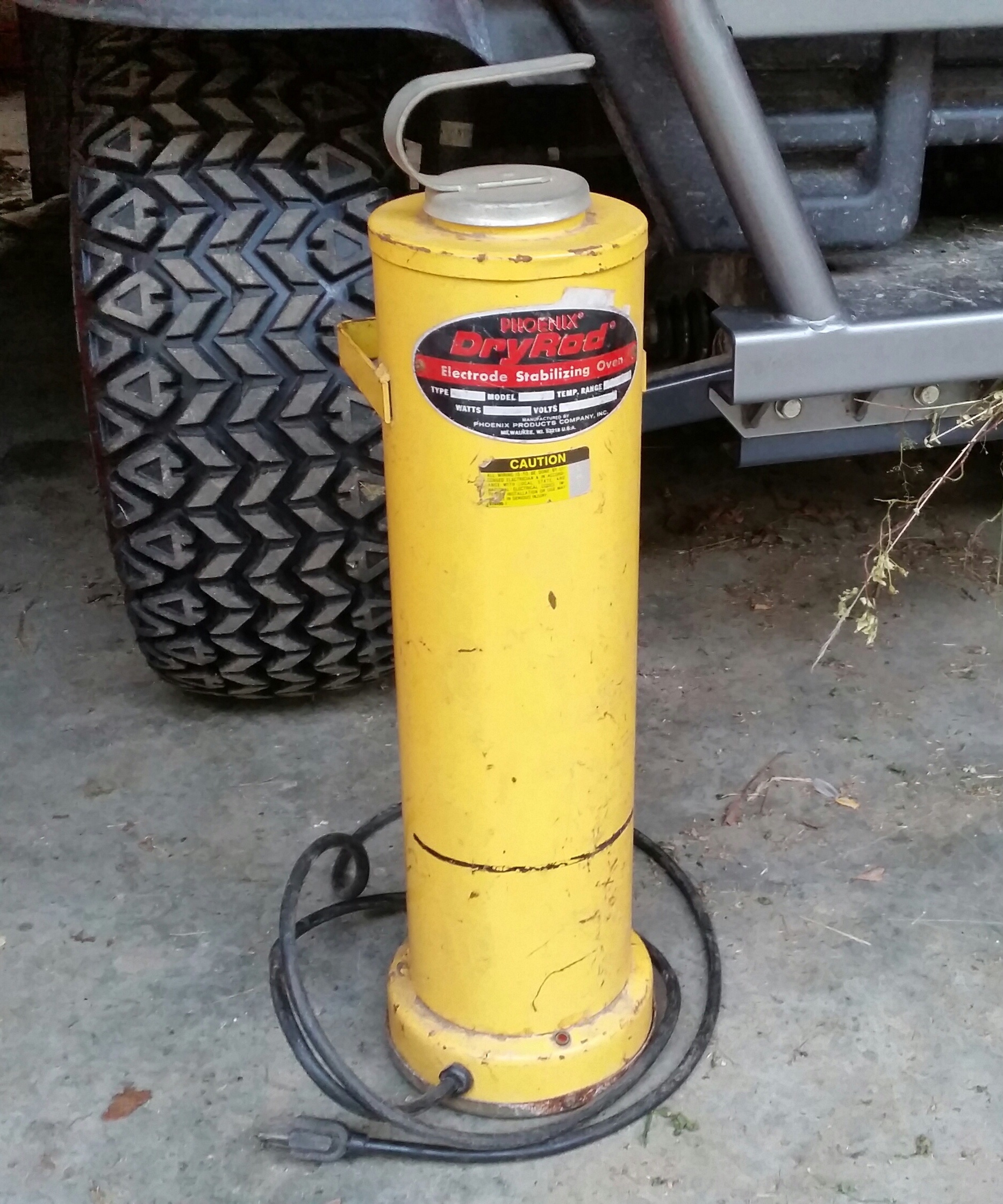

Today I managed to pick up a nice little rod oven on Craig's List for $40.00. I'm not sure I really need it right now, but it was 15 minutes away and seemed like a fair price. What do you guys think?

That is a good deal for $40. Put your 7018 in it for an hour or 2 before using and you'll notice a difference in how much nicer they burn. 7018 are the only rods that benefit from an oven unless they got wet but then you need a rebaking oven.

Nice find! I've been keeping mine in my gun safe that has a dehumidifier. I figure that should keep them in good shape.

Good deal and Good price on the oven, but any rod oven typically consumes much more electricity than people seem to think they do. Those things are intended to be plugged in 24 hours a day/365 day a year. Otherwise as Arc Weld pointed out you need a rebake oven which is a different oven.
Basically Any heating element type appliance (plug in a small RV type refrigerator some time) and watch your electric bill soar as those things use a heating element also to function. My guess is that oven may take $50 to $60 or more to run a month ($720 a year). Certainly worth it if you doing code work, projects that generate you revenue, or even a real serious hobbyists. Backyard hack repairs well maybe not so much ????
