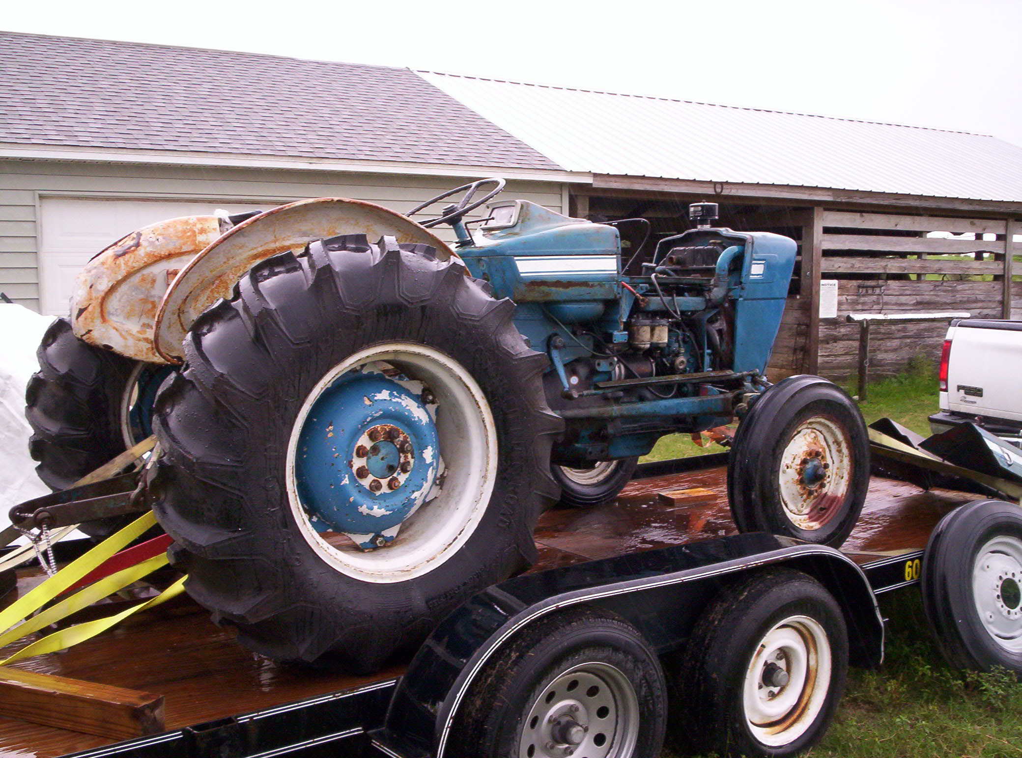

late 68 3000 diesel w/ 8spd.

Looking good Chris :) Is it an optical illusion or this thing is missing head? Any specifics on it that you want to share.

I had a couple of 'em.....a '72 gasser and a '71 diesel. The 8-speed is a MUCH better tranny over the 6-speed. You'll be happy with it once done.

Might be the angle you are seeing it from.
the engine is together with head and injector lines... looks a lil different than the gasser.
hood center section is off as well as the battery.
I like to start working on them while still on the trailer.. easier to move around them and get under them.. and if i spill oil during servicing.. it's easier to clean up the trailer deck vs my concrete or pasture.

I don't mind the 6 speed.. but i really do like and prefer the 8spd.. some of my other fords have that crashbox.

Good Mornin Chris,
Very nice !
The good news is that tires wont be on the list of things that are needed ! :)

yep.. both rear tires are virtually brand new.
front tires are used but good.. unfortunately.. AND mismatched! one is a multi rib 6x16.. the other is a tri-rib 6.5-16SL ( taller )... luckilly, I happen TO HAVE GOOD USED TIRES, ON RIMS IN BOTH THOSE SIZES, SAME TIRE STYLE. SO I CAN EITHER SWAP OVER TO THE SL TRI RIBS.. OR THE MULTI-RIBS.. ( oops.. sorry for caps! )

'bout a 140m drive... took a saturday morning and most o fthe day..
it's going to get the full meal deal... fix all mechanicals back to operating condition.. rebuild ge/starter.. new belts / hoses, fluids.. adjust clutch.. do a lil brake work, etc. I see a few broke parts neeidng replacements.. plus I'm getting a new front clip, grill, and at least one new fender skin..
after she's 100% mechanical and working.. then she'll get the pressure wash, degrease, sanding, prime and paint..
this one likely won't be a parade machine.. but will pull a 'small' mower to get at the corners of the fields and beside buildings that i can't make it to with my 10' and 15' mower... might cut a few trails in the small margin of woods I have at the back of the farm.. etc.. all stuff my 70+ hp tractors can't get to..

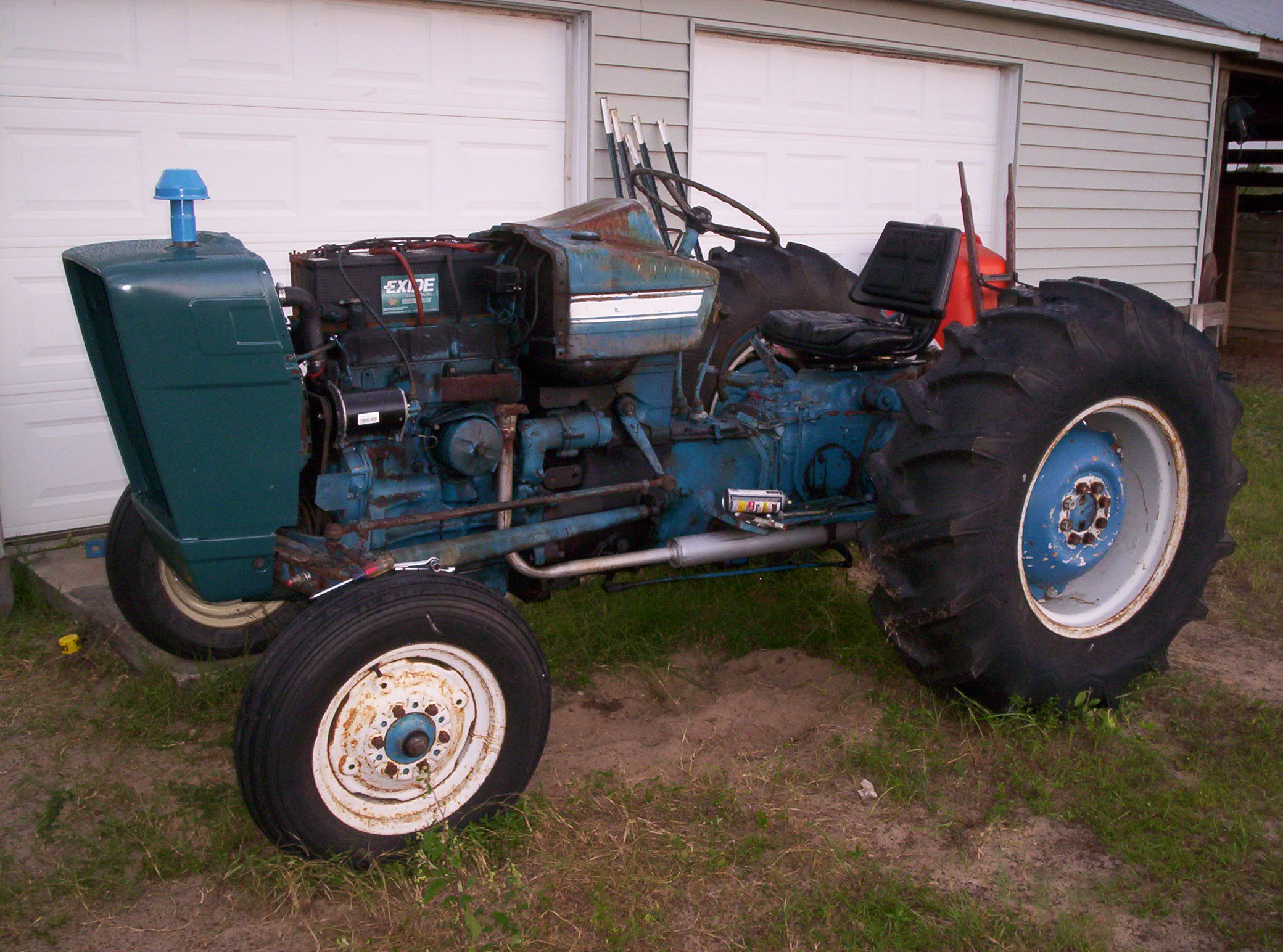

Soundguy, for most peoples choice the 3000 is the best tractor ford ever made. I still like the 851 myself. The 3000 has roughly the same HP but weighs a good bit more and has 3 more gears.
Does it have 16.9s they sure look like a load of tires?

14.9x24 r-1 on the 3000. and some 6-16 multi-ribs on the front.
I have some 16.9-24's sand and turf tires on my naa.
I'm seriously considering swapping the 14.9-24 ag tires tot he naa since it has a loader and runs out of traction fast.. and putting those 16.9 turfs on the 3000 since it will be a lawnmower... lot of tire to swing around though!

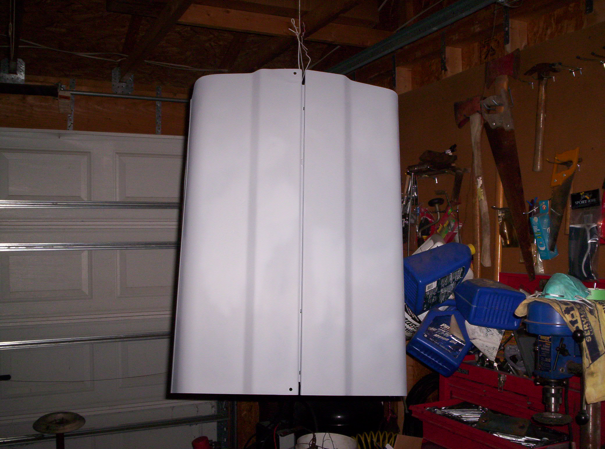

have been busy.. but have gotten nose repalced.. fenders off.. rebuilt steering and have hood primed.

Looks like the batteries would be a issue sitting on top of the motor, not corrosion problems? Heat damage to the batteries?

when they boil over you get corrosion.. just got to keep everything clean and painted.
they are easier to get to up there as the try swings out.

Nice find. The 3000 was a real popular size in our area. Most were the diesel w/8 speed. The biggest complaint I heard on the 3000 was not enough brakes.
Are you going to do the oil filter conversion or leave the original canister?
There have been a couple of posts on here about the paint on bed liner. Wonder how that would work to paint the inside of the battery tray? Any way, Congrats on the new toy...er....tractor.

Naw.. i like the canister.. it's heavy thick metal.. I've had sticks and rock chips dent and poke a soda-pop thin spin on oil filter..
I got some good paint on the bracket now.. that should be good for years to come..
