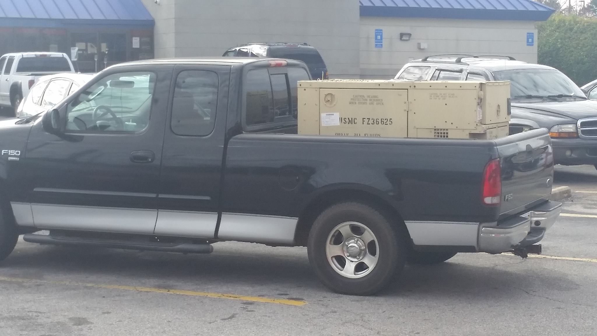

Been wanting a generator for years and finally decided to go for a surplus diesel gen set. This makes sense to me since I keep some diesel on the property already. Of course these things are a crap shoot but most stories I've read on them have been positive. If it runs out okay I plan to get a storage tank and start having fuel delivered. I will be doing a lot of backhoe work on my property next year so I should have no problem rotating the fuel and keeping it fresh.
Machine is a MEP-803A Tactical Quiet 10KW unit. Bought through Gov Liquidation for just under $1200 after fees and tax. Showing 2617 hours on the meter and has a reset decal indicating it has been rebuilt in some fashion. I have read they sometimes replace the hour meter when they reset or install a new engine so it may have more hours on the genset itself. Haven't even opened the document holder to see if it has details yet.
From what I've read these produce 10KW at 80% load and can run 24/7 at that in the desert. Higher loads are possible for shorter runs. 100% is about 12KW and I have seen videos where people loaded them to 125%.
Here it is loaded for the trip home from Atlanta.
