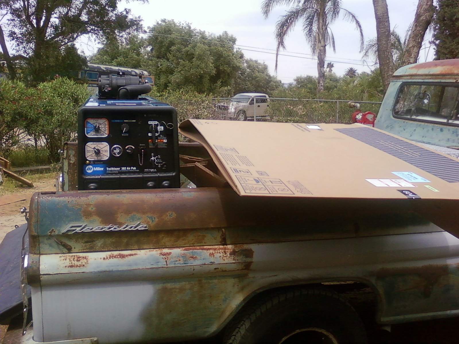

Took my rusty piece of junk and my friend in the pic and picked it all up

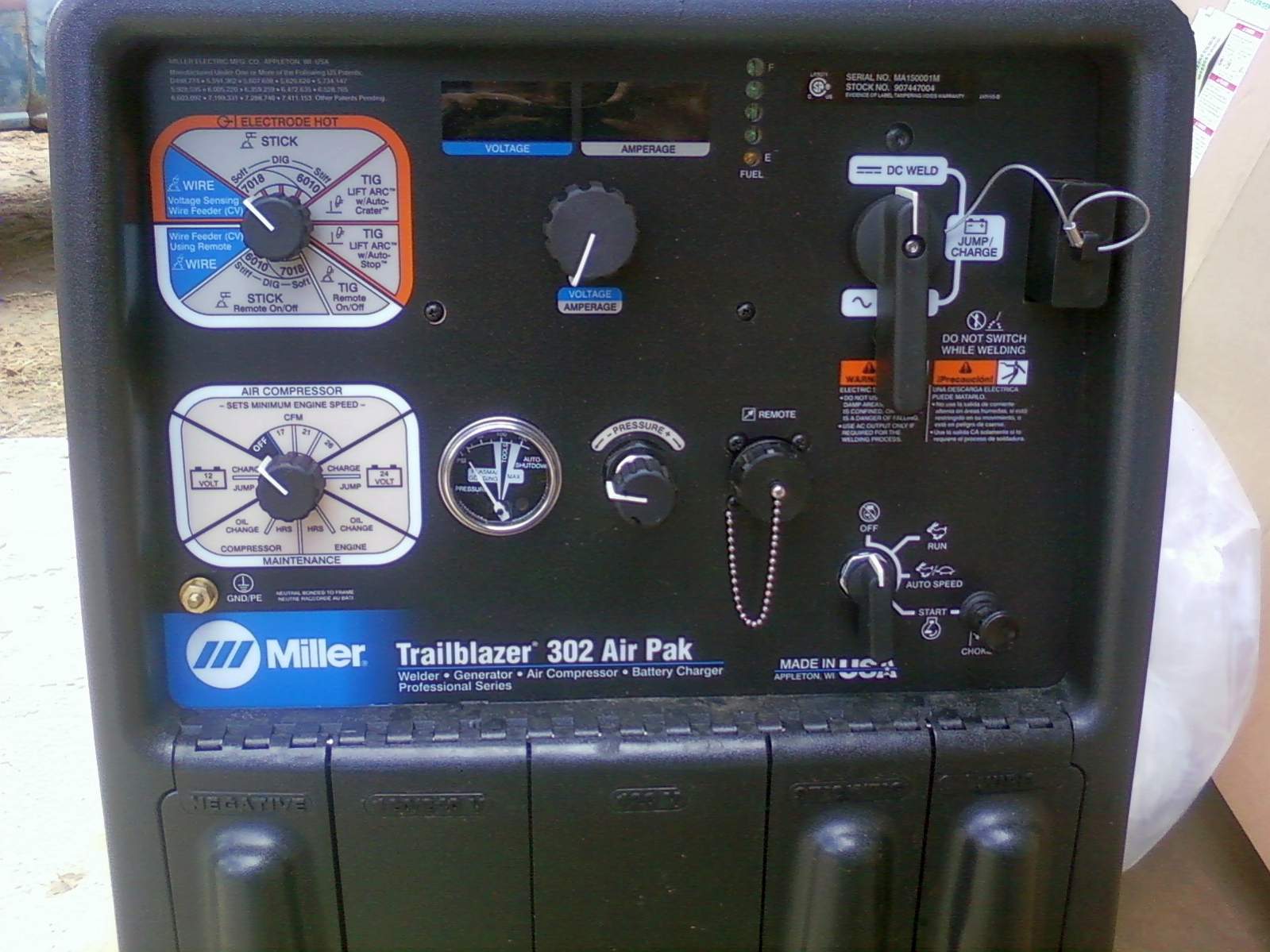

ran it and discovered one air feedback tube was not connected to the controller hooked that up runs great lots of air no oil leaks or other problems so far
It has it all...... i just ordered the condenser/separator option
Now i have to plumb the air outlet and make up cables

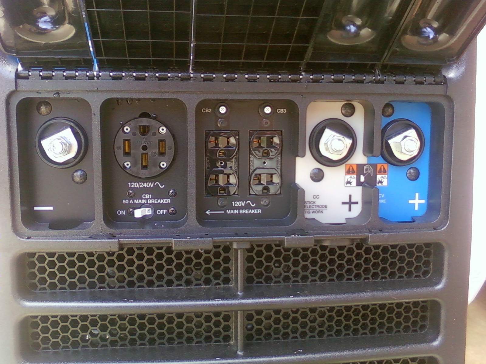

Now i need some advice
I want to use quick connectors for lead changes i don't want to go over the tweco vs dense
debate but i want your advice
I am thinking about replacing the standard lug connectors on the front panel with quick connector terminals
Either the Radnor F panel socket # BE3570 or the Tweco F panel # 114TSF
The Radnor's are cheaper and an international standard so they say
The Twecos are very popular in the industry
And adapters are available to go to either style in case i need to use cables with the other type connectors
I will Thank You for the advice before hand

You have a Nice " Made in USA " Setup. Buy Tweco "Made in USA" Lugs. The Brass is better and will take many more hookup/unhooks than the China Radnor version. How Ever, Saving Money is Saving
Money..
   / Picked it up yesterday #3
If you have other Miller systems use those style of connector (I think they're Dense). That way if you need shorter cables you can interchange cables. BTW; nice machine.

I went with the tweco- lug to tweco 45 degree adapters
once on the covers lock back in place so it looks good :thumbsup:
Got some 1/2 copper pipe to make the saddles for the connections so i can try it out :licking:
