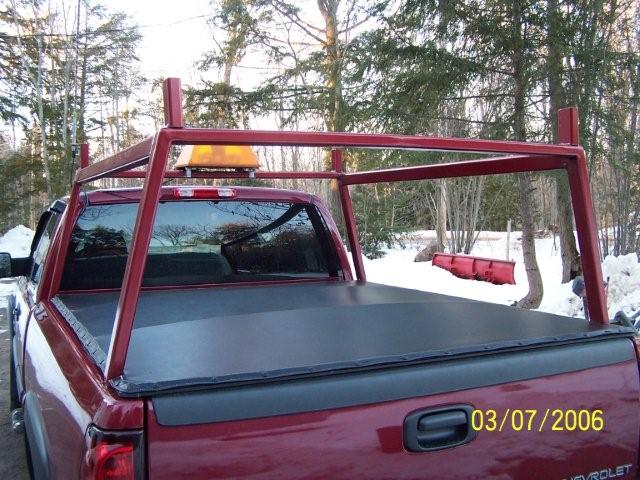

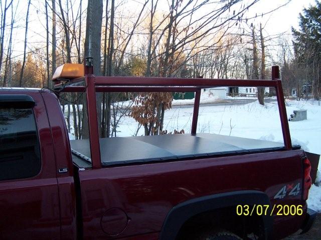

I built this one for my pickup using 1 1/2" x 2 1/2" rectangular steel. I bought the steel for under $150. I cut vees and bent the angles, Welded it all up and painted it. I hauled a 40' extension ladder (20' collapsed) many times by securing it with bungee cords to the rack and a couple to the front bumper. It slides in the pockets and attaches with a bolt in each corner.

Nice Work... simple and elegant!

The first rack you posted about, the tilted "arm" rack--I would say it may be easier to take off and store in a smaller space than the one built by George2615. I'm not familiar with that particular brand of tilted rack, but the one I've seen mounted to a plate in the bed of the truck and also bolted to the bed rail. There was an upper, removable section that then bolted to the base. If someone wanted to steal the upper section, then I guess they could unbolt it.
The rack posted by George2615 is well done. It appears wide enough to carry quite a bit. It looks like it would be very sturdy, and might be easier to mount to the bed rails than having to make holes in your truck bed.
In my state (Mass) you'd get busted for using just bungees, not considered "secure". Nice design on the rack, though. I've been using Rack Straps for a few years, work pretty well, never missing when you need it. Rack Strap Advanced Tie-Down System : Cargo Holders: Accessories: Online Catalog: American Van
