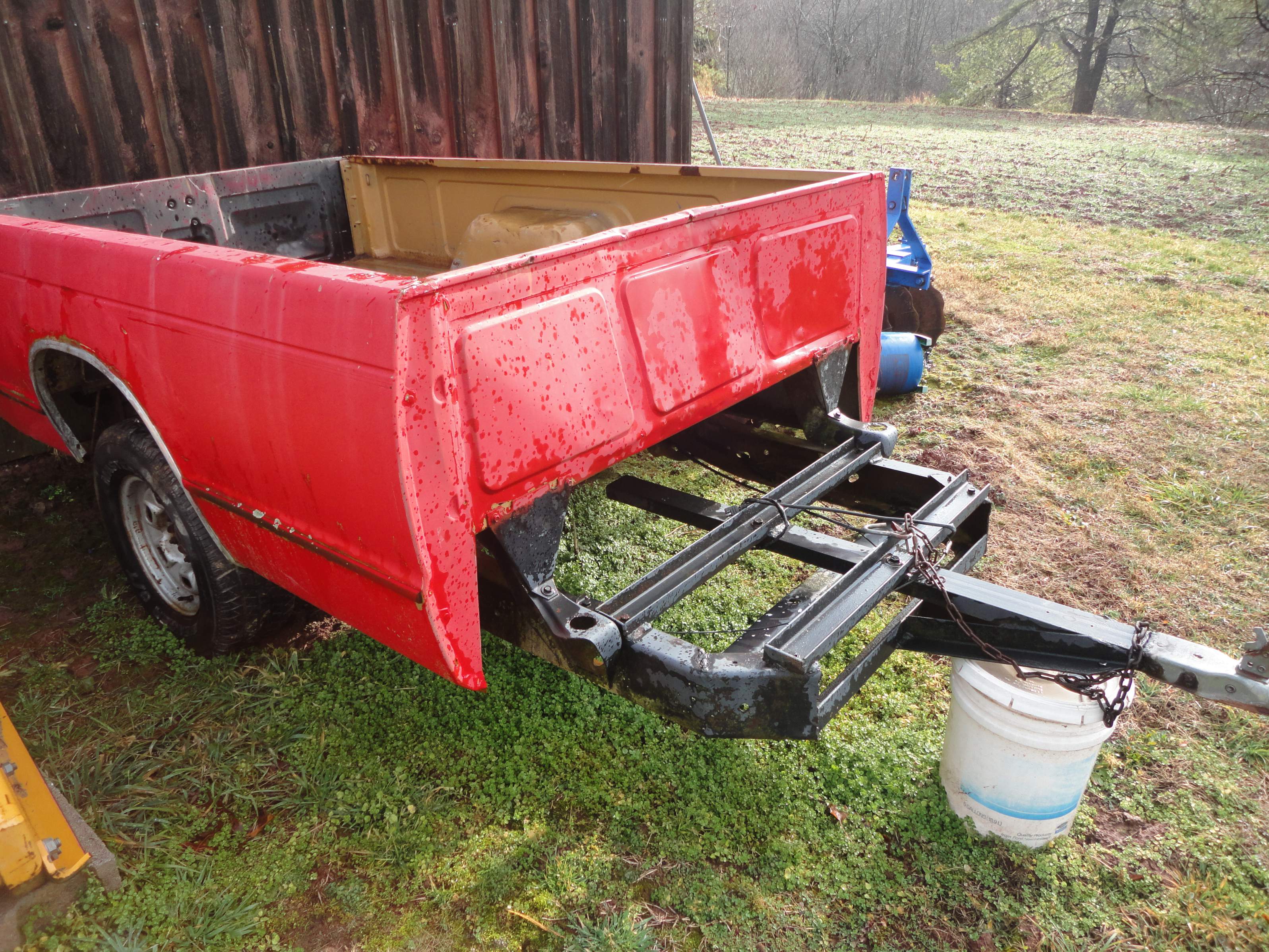

Those are beautiful, what did you use for a axle?

/ Pick up bed into a trailer #9
i'll try this hope the pic shows up it's an old s10 bed and rear end DSC00347.jpg
/ Pick up bed into a trailer #11
i'll get me another one at some point it will be off of a 3/4 ton this one can't load to heavy the reason these things are not toeasy to find now is the price of scrap metal is so high there all getting crushed
/ Pick up bed into a trailer #12
73 to 86 Chevy/GMC are easy to find and make, get an old p/u cut frame near the front of the cab, then cut notches in the top and bottom of the frame in front of the cross brace at the front of the box. Bend both frame rails in, to form a V, add a peice of heavy wall square or rectangled tubing from the cross brace, out past the V and install a hitch. Add a trailer plug to the factory wire harness and some safty chains and your set. This is an easy project, with very minimal welding and materials required.

/ Pick up bed into a trailer #13
I made one out of an old Datsun some years ago. Had a chunk of 3x3x.250 for the tongue, little overkill but it was free and available. Fortunately Oregon doesn't require a license on small trailers so it not only didn't cost much to make, it doesn't cost anything to keep, as I don't use it much. Last use was past summer, needed to haul some 12' railroad ties. Shimmed the front so they'd clear the pickup and strapped them down on top.

/ Pick up bed into a trailer #15
(Hope this doesn't double post, internet dropped out for a minute)
I can't hardly believe it, I've got a trailer made with the same bed - exact same color even !! I've had mine about 25 years, bought it from a guy when I lived in Virginia. The tongue on mine is made differently and is longer. You have to be very careful about weight distribution when loading one of these as it's easy to get too much weight behind the axle and it will scare the heck out of you when it gets to wagging the back of your truck. I've hauled mine at 70 mph on the interstates for thousands of miles though, when properly loaded. I love the tie-down hooks along the bed and tailgate.
