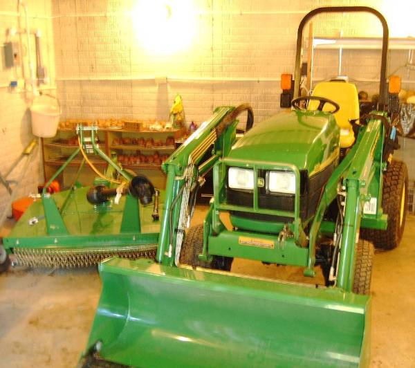

Here's a picture of my new JD 4010 parked in the basement garage of the carriage house. The Gravely's upstairs, as it won't get up the hill from the basement in the winter snow.
LX4 cutter is parked on TSC castors behind and to the left. The Gravely hog is that orange one to the rear of it.
I'm in the process of changing the draft pin locations and rear mount positions on the LX4 in order to raise it higher with the draft arms. Am also going to a chain in place of top link and am thinking seriously about getting Pat's quick hitch gizmos for the draft arms because removing them from the LX4 requires almost dismantlement to move them off the pins. Have pics and discussions on these either on this forum or general/owner operating one.
I posted a review of the 4010 in the Review section. Commented about the low lift height there. Problem seems to be that the top link is longer than the draft arms. The draft arms then want to push the trail wheel into the ground, rather than raise the LX4. Positioning the pins to the lower setting and the frame members in the forward hole will lower the pins and kick the top link location forward to shorten it.

Nice looking tractor and storage area! /forums/images/graemlins/cool.gif

Ralph--it's stil haunting me. Can you turn the pins on the LX4 inward to overcome your problem? I'm still incredulous that you are having hitch problems with your cutter /forums/images/graemlins/confused.gif
