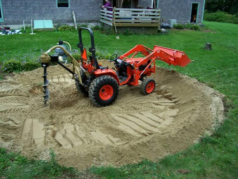

OK. Im a dumby and short and to the point. how do you hook up a PHD? does the top link have to remove? Its on a JD 5103. one of these days Ill be smarter?? JD
   / PHD help #2
Remove the top link and use the pin just above the PTO and mount it to the tractor where the top link mounts
