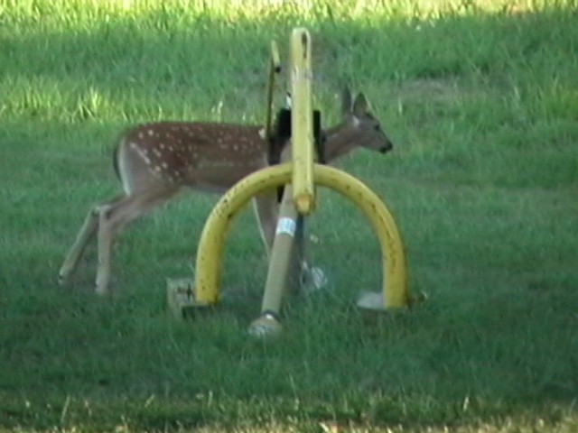

Ive drilled lots of holes. My digger has the handel. I use it, but if it didnt have it i wouldnt miss it. I cut about 12"off it anyways. When the digger does swing it could gash your neck or head if ya hit it. You can lower the digger and get it level without one. The last thing the handel did for me was grab my vinyl siding on the house while comming out of a hole. ill probably take it off soon and use it for a wife beater/w3tcompact/icons/laugh.gif...just kiddin, Heck the deer even like my Post Hole Digger. See the picture Larry
