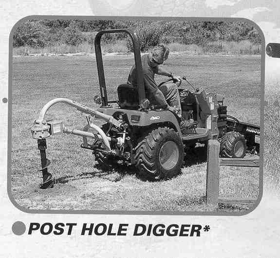

I know there have been discussions of this before. The issue seems to be that standard post hole diggers are too long to fit on the BX22 [or 2200] without some modification. Does anyone know of a reasonable phd that will work on my BX22 without having to modify it?

A PHD is shown being used on the 2200 and 22 in the brochure I have, I guess Kubota offers one
   / PHD for BX22 #3
heres a pic

The Woods 1120 is designed specifically for this size machine and there may be a few others at this point. It's only real downside is being limited to 30" depth. PHD's with adjustable arm positions can often be used with these shorter machines as long as the adjustment will allow you to raise the tool up higher for ground clearance.
