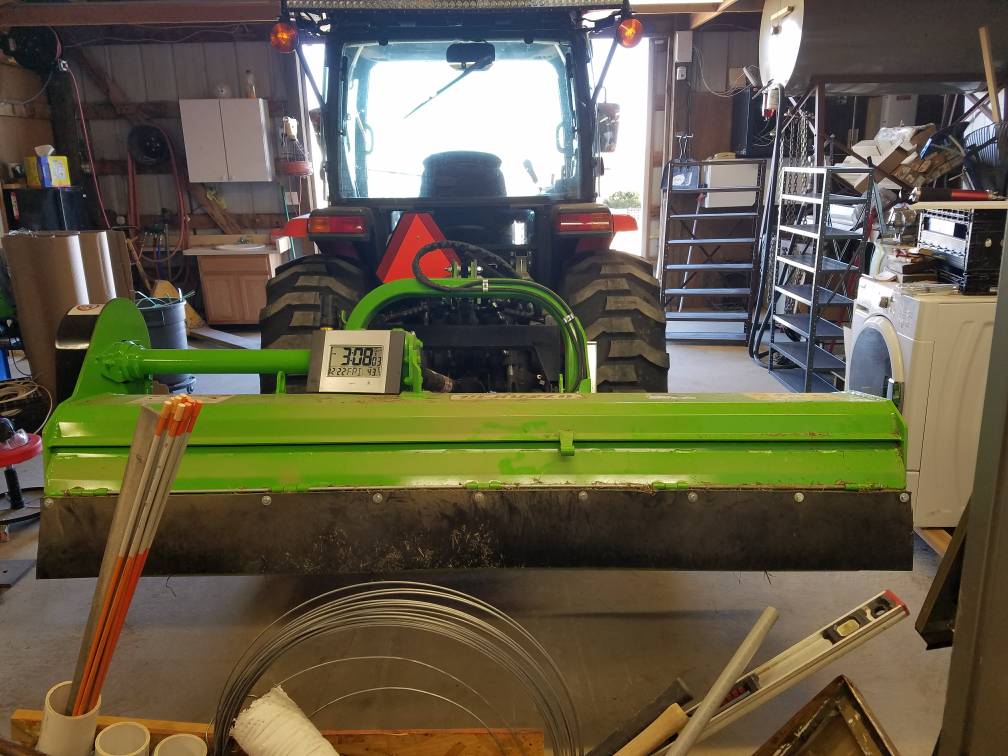

My Peruzzo Brush Bull 2200 (7' working width weighs in at 1,700lbs behind 5k of tractor. I can really feel it when I have it fully offset (2' or so) & it's off the ground. Double your weight on both fronts to some degree. I'd want a fair bit lighter impliment if I was hanging it off further to the side than I do now. Although I'd imagine a ditch mower would need to stay on the ground more than a normal flail just due to the leverage. 20171222_150735.jpg
