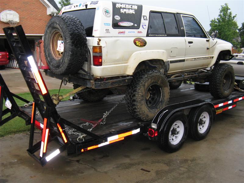

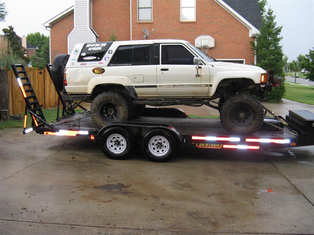

Any you guys ever build any drive on or permenant ramps for you trailor. I have a beaver tail trailer (car carrier) with ramps that store under the trailor on slide-in guides. I was wanting to fab up some sort of semi permenant ramps that slide in where the trailer ramps fit. They would have to be offset some as my tractor tire width is a little narrower than the ramp guides. Any you guys ever do something like that. I would love to see pictures to get some ideas. From previous posts I know there are some great fabricators on this site. Thanks
   / Permenant trailer ramps #2
Pics of my car hauler drive up ramps. I ordered the trailer specifically with the stand up ramps since I didn't want to deal with taking them out and so forth.
Good luck.

Thanks for the quick reply FTG-05. I was thinking of something alot smaller. Maybe just a "wedge" type ramp not over 12" in length. My tractor will almost climb the beaver tail now with no ramps being used. I think just a small wedge that fits in the existing ramp holders would do the trick. But im not sure how to go about designing them.
