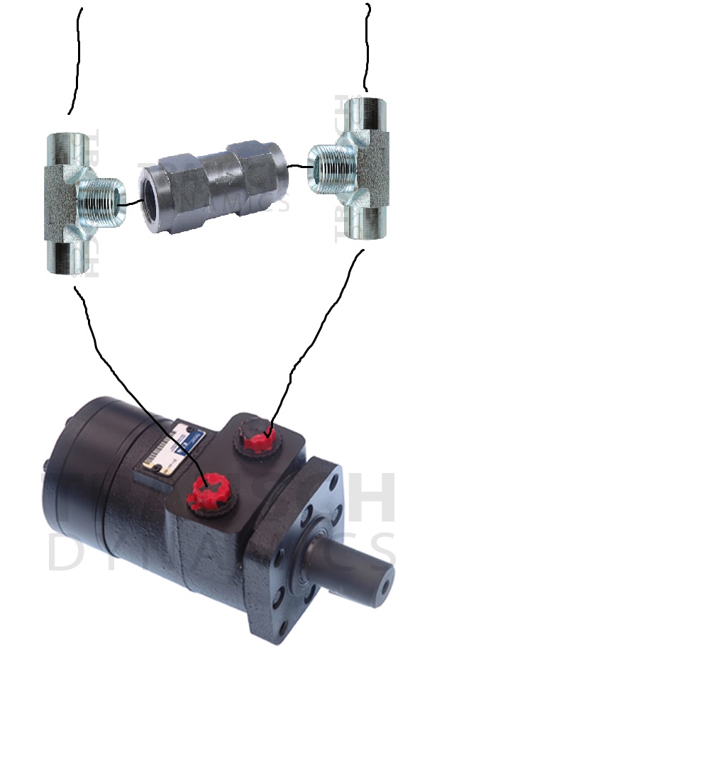

I need to plumb in a crossover relief valve into my 3rd function. There isn't one on my hydraulic post hole digger & judging by how the hoses jump when letting off the solenoid buttons the hoses are getting hammered as the motor spins down briefly acting as a pump.
Is there any reason I cant or shouldn't mount it to the tractor side of the QDs rather than the auger side? I was plannning on setting it in the 2,500-3,000psi range. Tractor is rated at 2,500psi, hydraulic motor & hoses are rated at up to 3,000psi. I'm trying to figure out any drawbacks to putting a crossover relief on there permantly. Other than when a pump/motor overpressurizes things the the crossover relief shouldn't do anything as long as its set higher than the tractor's normal relief.

Down side of mounting the cross over relief some distance from the auger motor is response time. Normally it is better to put the safety devise (relief valve) as close as reasonably possibly to the source of the pressure spike.

You could try it this way. The drawing is from a salesman from Traush hydraulic. He suggested this for a project I am doing. check valve setup.jpg
   / Permantly mount a crossover relief valve on 3rd function?
You could try it this way. The drawing is from a salesman from Traush hydraulic. He suggested this for a project I am doing.View attachment 508360
Is that center bit a 2 way relief valve? Adjustable or fixed pressure? If it's just a 1 way check valve, that would work for a mower or something that only run direction. I need to reverse the auger on the PHD a bit on occasion.
Fundamentally that Prince crossover relief valve I linked does something similar. 2 adjustable relief valves, one on each side. Dumps to the other side if it hits the adjustable relief pressure.
   / Permantly mount a crossover relief valve on 3rd function? #5
It is a 1 way check valve for a hydraulic motor that only turns 1 way. It is in the line for motor wind down when you shut off supply. You are correct, it probably wont work for your phd.
