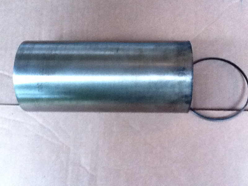

When you say that the sleeve was down 0.006" does that mean that the engine sucked the sleeve down? When it did this did it break the lip on the sleeve?
The engine is not broke in with 2 hrs on the clock, it takes time to get the rings to break in and seal up. However it sounds like you have excessive smoke. If the ring end gap was not checked on the piston rings then the ring can expand and break. I would contact the engine shop and have them look into it. If they stand behind their work they will look at it free of charge.
You mean break the lip like this?

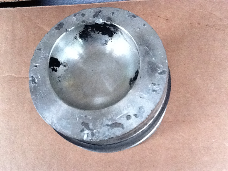

I did look at the original pistons from the original engine when they tore it down... They had pieces of the pistons broken off above the top ring groove. This on the rear cylinder (with the sleeve lowered) being the worst, combined with a lot of knocking under load probably put a lot of stress on that sleeve....
You mean pieces like this from one of my AD3.152s?
