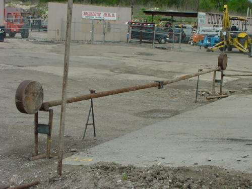

I did some trading with a friend who needed a barrier gate. He had the drill stem and he drove in some posts for me to work with. He also had this thirty two foot length of what he thought was killer pipe.
I took it from there.
The two discs are five and a half inches by by nineteen and a half inches. We came up with them weighing two hundred seventy pounds plus. My calculating the needed weight for the counterweight by using sixty five pound tractor weights put on until I had what I thought was a manageable system evidently worked.

Another shot.
These can be lifted up and pulled back down by a smallish man with no problem. They also make it easy to make the double padlock system required so the property owner and the fire department has twenty four hour access.
