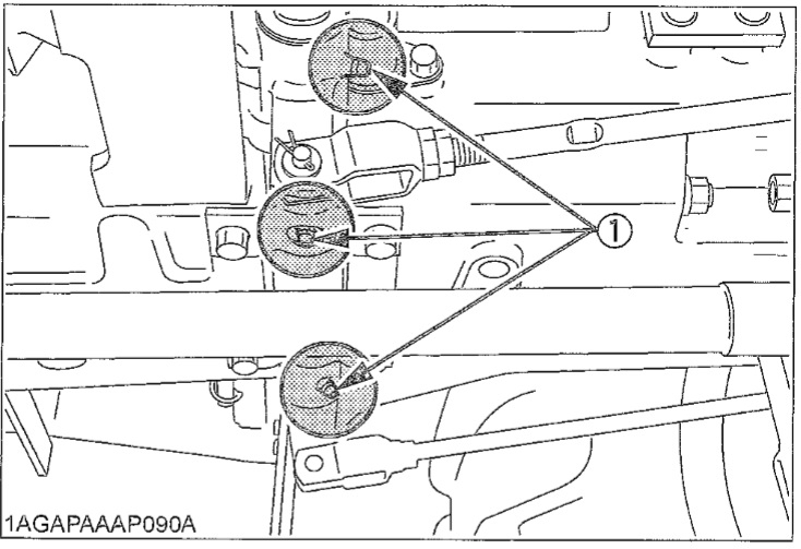

It's easy to overlook the 3 zerks underneath, one each for clutch, brake and throttle pedals - but they're there. I have to use a flashlight to find mine, but they're there and they do need grease every so often.
   / Peddle Resistance on HST #5
The top one in the photo, is the hst pedal, the zerk is facing more forward vs. the other 2 which face more downward...

Whoa, that is a surprise. I have been missing that top one. Nothing like a picture, thank you very much Mr. Old and TIred. That tractor will be in the garage today!

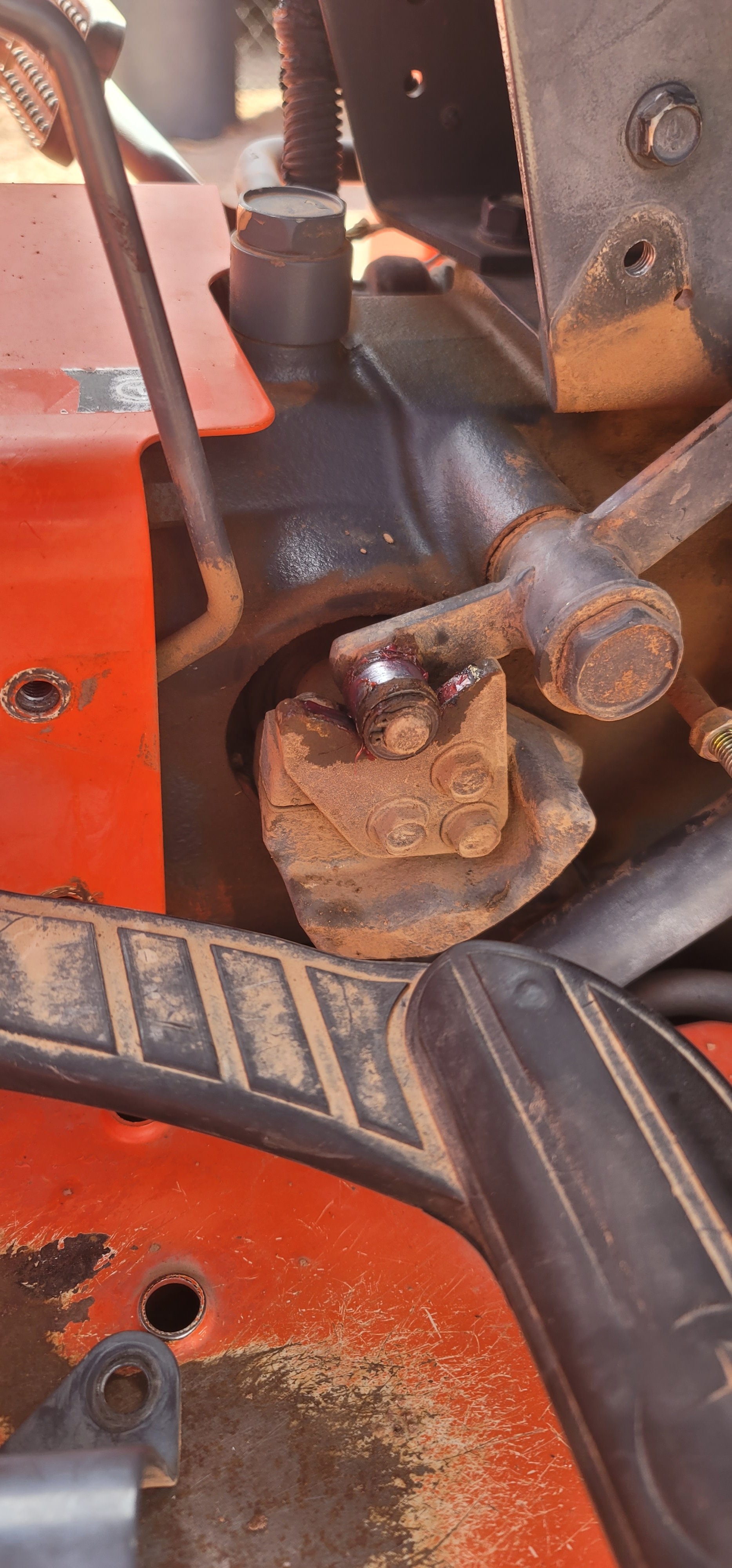

I did pressure wash before pulling it into the garage yesterday, and I was wrong about the grease fittings. Once I saw them, I knew that I have been shooting all three each time I serviced the tractor. So I followed all the linkage paths and when I removed a cover plate above the floor deck bolted to the side of the console (right next to the peddle), I found a bearing that travels in a "V" shaped plate, moving up one side in forward and the other in reverse. The bearing was frozen and heavily scored, creating the resistance I have been experiencing. It's purpose is to depress a switch up under the console when you are not moving and to release the switch when moving forward or backward. Not sure what the switch does.
Need to order a new 'V" plate and bearing today.
Here ya go. If you can help with part numbers, that would be great. I need the "V" plate and the roller bearing. I tried to grease it up by that only helped a little bit.
