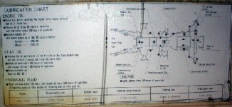

I use sae 80w/90 gear oil, I get at walmart. Is your oil the color of peanut butter? If so you have water in it, and any oil is better that that. I have not heard of a problem with bronze bushings and Gl-5. Iseki recomends sae80w/90. Your tractors transmission holds 2.77 gal. Attached you will find a photo I just took of the specs from under the hood of my Bolens g192, which is an Iseki 1910 2wd.
Hope you can read it

Your differential is lubricated from the same reservoir as your transmission. So you use the same for both, it's the same case. I am using a GL-5 and I don't plan on changing it until the scheduled maintenance. I have an f-150 with a manual trans and I will consider avoiding a gl-5 because it it's a synchronized transmission-shift without stopping(bronze synchronizers), thanks for the heads up on that one.
