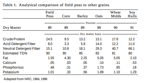

Check https://library.ndsu.edu/ir/bitstream/handle/10365/5375/as1224.pdf?sequence=1.
