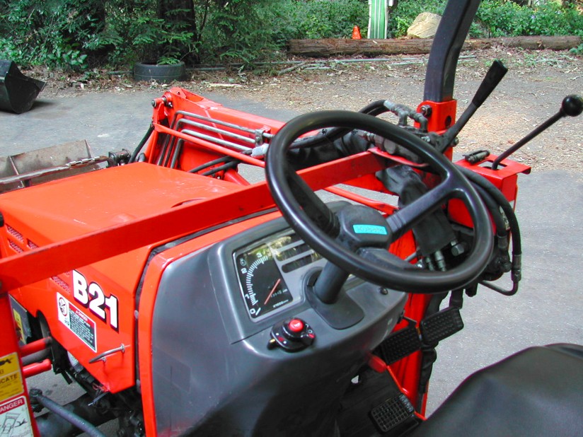

I am adding a grapple to my FEL on my kubota b21. My question is... to get pressure to my new grapple valve should I go from the pump pressure line to the new valve "in" then out via PB to the FEL valve "in" ? or should I tap into the FEL PB to get the pressure to the new valve then out via PB to the existing BH.
If i asked that correctly, i understand not to "T" into a pressure line. so in short we go into a valve with pressure and out via PB to the next valve. does it matter what valve get the pressure from the pump first?

While "technically" it does not matter, it is far more common to feed the new valve from the PB of the FEL valve making it the second valve in the series.

Here is a photo of my B21 with a lever-actuated spool valve on the FEL
cross bar, plumbed from the FEL valve PB connection. This one is Brand
Hydraulics, and you can get a valve like this for under $100. The 4-in-1
control on my Kioti (single solenoid-actuated spool valve) was even less
money (less than $50 for the valve). All setups need some hoses and
fittings. A full diverter plus manifold runs well over $100 from what I have
found.
