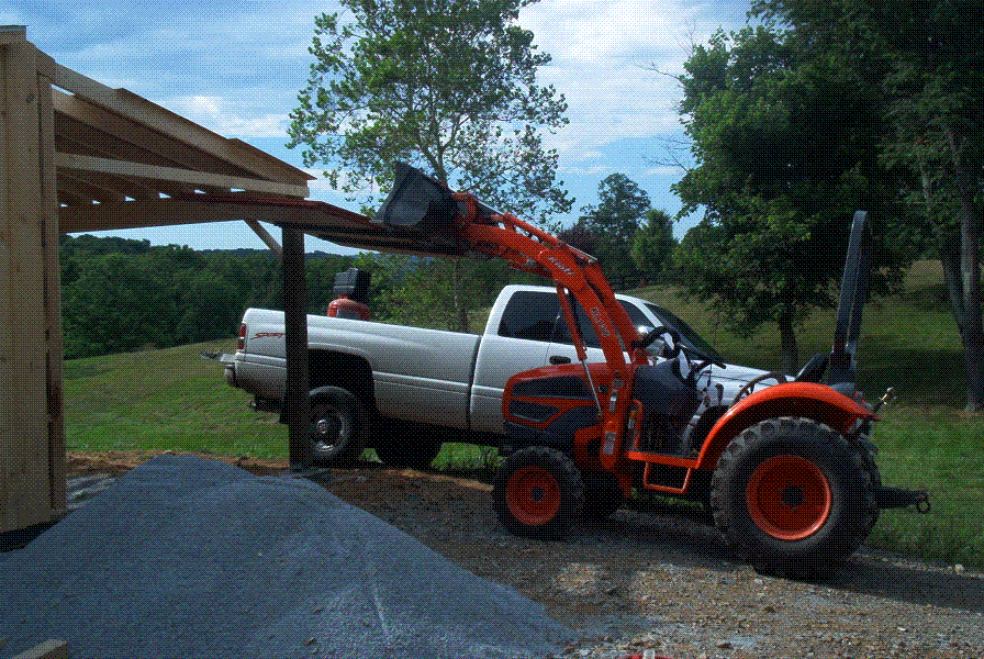

I'd agree with MadReferee, I got a copy of his plans and they have greatly absorbed the cost in moving materials around my place. If you have access to a welder it is a great project. The materials ran about $80.00 in my area for steel. Far less then the cost of Paynes Forks.
Picture shows my Kioti lifting up sheets of plywood to the roof. I'm working on putting together a barn at our property. It is somewhat of a dark shaded picture, but you get the idea.

I did take a look at your plans/Pictures from a previous post a while back and they are very similar to the payne forks Mad. If I had a welder I would of taken advantage of them to save $$. Great job!

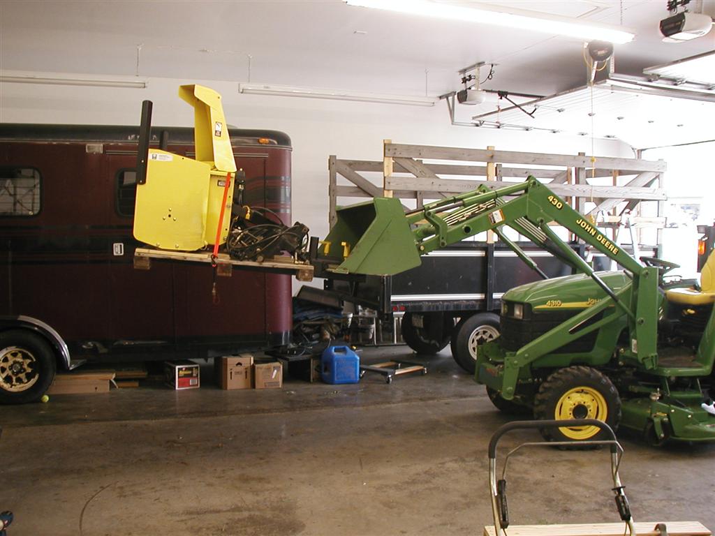

I got a set of medium forks from Paynes a month or so ago. I have not used them a lot but the couple of times I did they worked great. Ordering was easy. I called them directly because I did not feel comfortable with their web site. I think the web purchase goes through a 3rd party or something.
I ordered late on a Monday, they were shipped Wednesday as promised and were sitting in front of my garage the following Monday.
I'll try to attach a photo showing the forks being used to lift my snowblower. I don't know exactly how much the blower weighs but its probably close to 400#. I lifted without any ballast (except for the mid mount mower) and the tractor was very stable. Of course I was on a perfectly flat floor but that load is hanging out there.
