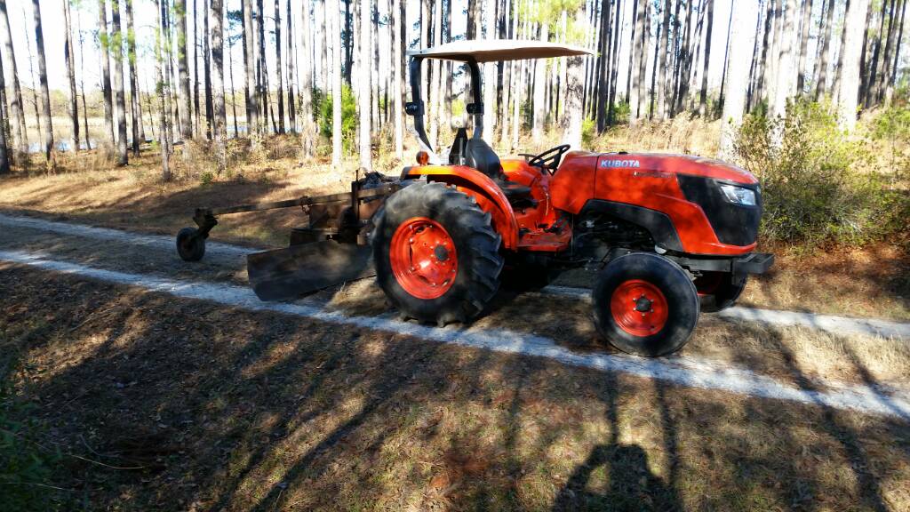

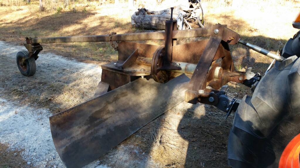

Pats came in yesterday and I am in love I can't imagine why I waited so long to purchase these things. Pulled the fire breaks right away with no issues then this afternoon I did a ton of blade work using this behomuth blade and never skipped a beat.
   / Pats quick hitch #8
I don't see any pat's in the picture. :detective:
   / Pats quick hitch #10
Hey there they are, lol. I can't blame you for wanting them, after I changed a few implements I said heck with that noise and I bought a quick hitch. So why did you decide to go with Pat's instead of a QH, was it because you have older implements. I was looking at both of them trying to decide myself.
