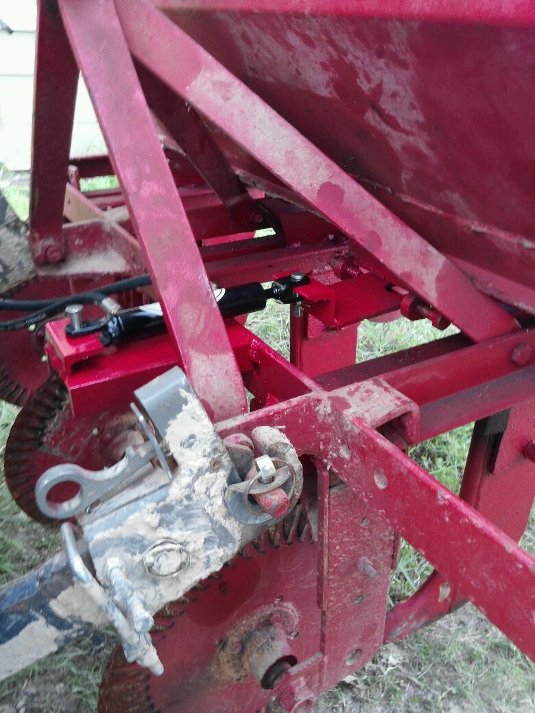

The PATS work like the bottom hooks on a QH, can get the adjusting bar and hitch pins as a kit. They do extend the length of lift arms couple of inches but not a issue unless PTO shafts are cut short.
One of the best tools on my tractors, use them on everything.
