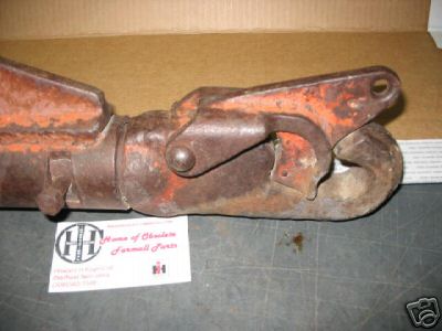

Wow. The simplicity of these designs and obviously ease of use. Really makes me wonder why tractor manufacturers haven't caught on and made these standard issue (or at least optional).
   / pats quick change 3-point parts #6
They did, back in the '60s, Case called it the Eagle Claw, don't know why it didn't last.
   / pats quick change 3-point parts #7
That Eagle Claw is neat. I wonder if it had any jamming or maintenance problems?
