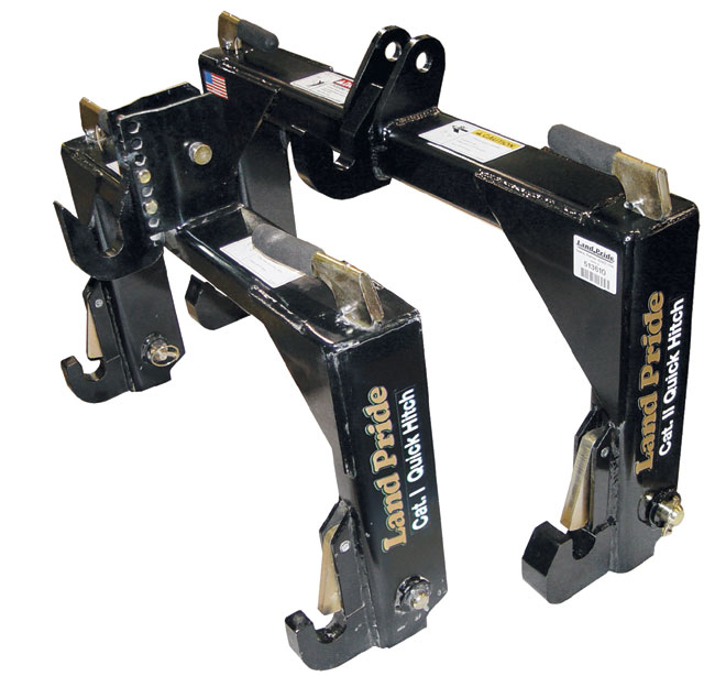

I was all ready to order a set of Pat's premium Cat II quick hitch, and then i went to look at my new Kubota M7060HDC12 that arrived at the local dealer this morning. I looked at the lower lift arms and It doesn't look like there is enough room to install the equipment on the arms. Anybody have this set up on a Kubota?? Maybe send me a photo?? I priced new lift arms without the telescopic ends and boy is Kubota proud of them. (retail $430 EACH)I about fell over backwards. Any help would be appreciated.

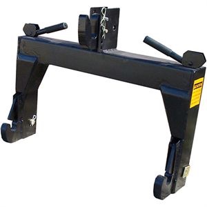

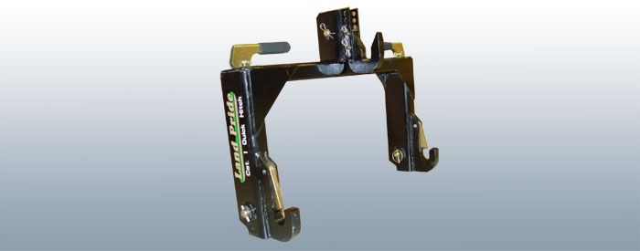

I'm pretty sure Pat's work fine with telescoping links. They really don't take up much more space on the arms than is required for typical implements. That said I'd probably go with a full quickhitch frame like so:
   / Pat's premium Quick Hitch on a Kubota with Telescopic lower links. #4
Go Quick Hitch and never look back (pun intended).
I wouldn't spend the money for Pat's to install on telescoping arms. Just don't think it's worth the cost. You will learn how to use your telescoping arms and will be able to stop the tractor in the proper position to hitch up with only trip out of the seat. Then the next step to speeding up that process is the QH. So if you are bound to spend money, go QH and skip the intermediate step. :)

I was thinking the full framed hitch, similar to the Pats but the full frame unit hooks up the top and the bottom pins and you don't have to bend over to release the lower pins when changing attachments. If you use hydraulics on the 3PH they will stay attached to the full frame set up.
To me the full framed hitch makes more sense.
