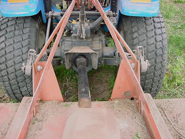

I bought one for my NH 1925 and wow, am I glad I did! Makes changing implements a breeze. Recommend to anyone who struggles with this task. I do wish they would generate a little better user's manual, but it's pretty self-explanatory. I did have to bevel the pins to get them to go into the lift arms easily. Without beveling, it wouldn't go in even when the pin and hole appeared perfectly aligned. See pic of Rhino shredder hooked up with the Pat's system. 45er
