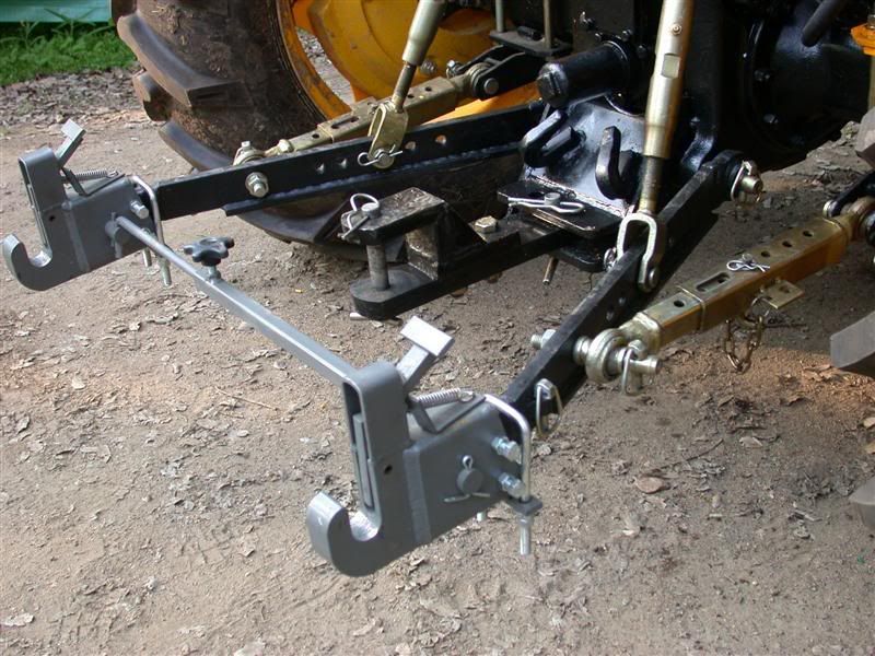

Just added Pat' system this week and found the manual top link about 2 1/2 inches short for connecting the 1,500 pound 9inch Vably chipper. I connected by tipping the unit forward, but not a fun way to achieve the hook up. Have not had time to try my other attachments. Will I need to find a longer manual top link? Also I have power top and the cylinder "reach" could be limited. Looking for a short cut to the answer, if you please. Otherwise I like the fit and quality and hook up was easy for a heavy piece of equipment.

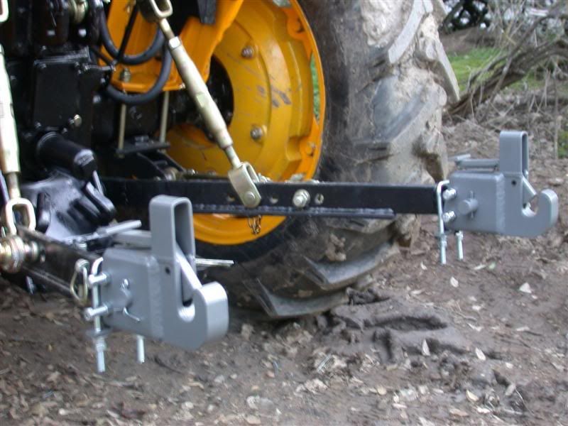

Here's what I did on my wife's 284 Jinma to show an alternate solution...
First pic shows Pat's on the stock length lower links where they stick out pretty far.
Second pic shows the lower links back to stock length.
Third pic shows the piece I sawed out the links re-welded.
